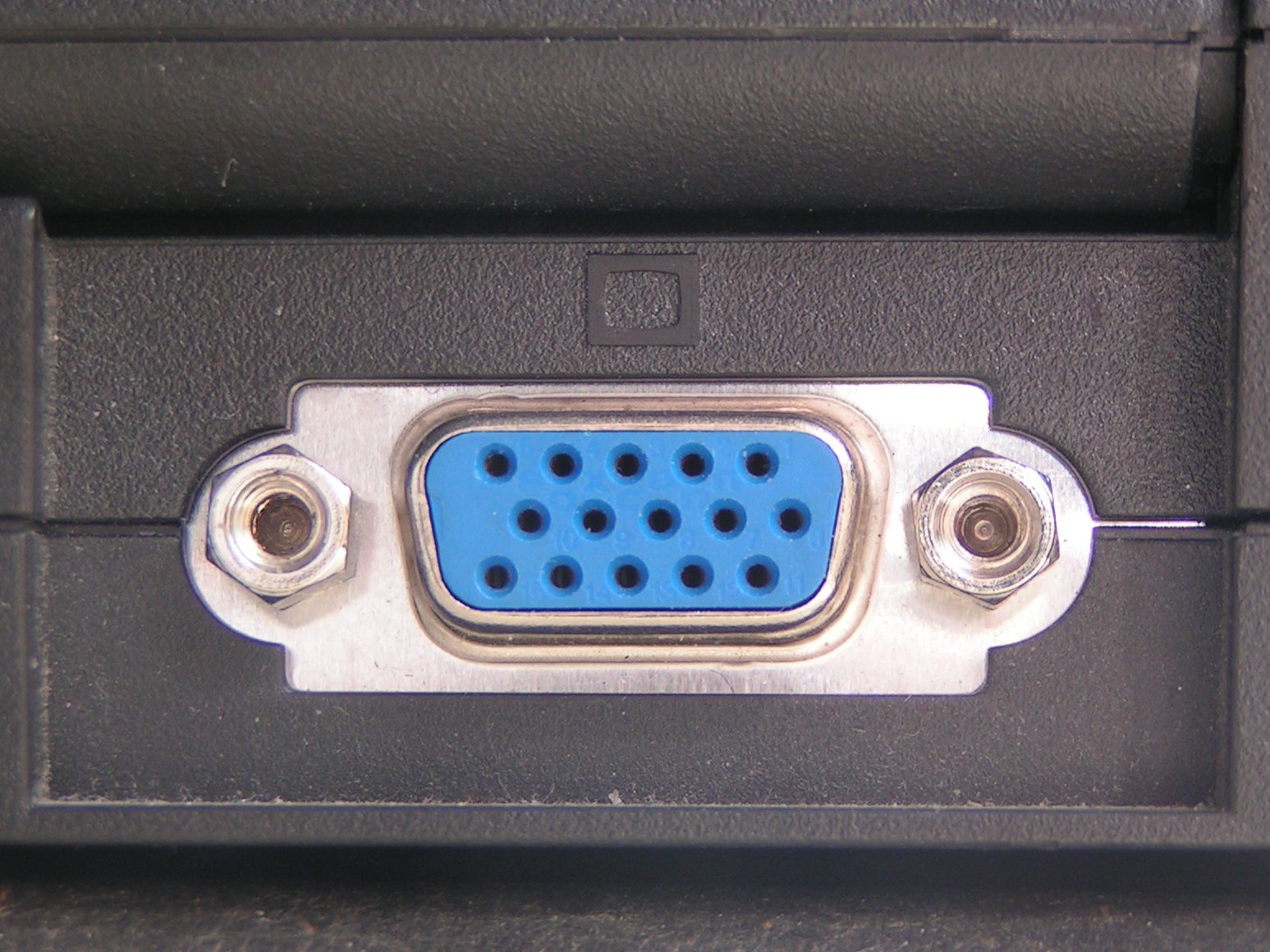

            Check with RGB port and see you have image on external monitor or not?
            If you have image on monitor then it means you have disconnected pin on GPU or your Laptop lcd is dead

              Thank you,
              Ram in slot.
              Connect the Display ... and "Check your cable ....." on screen.
              Power on and the same msg.
              With other Laptops ... the screen get black when we connect ... and with power on ... image on screen.

                      But: Connect the CRT, LED, PLASMA ... and
                      With other laptops and tower ... if you connect external monitor to board ... no more "Check your cable. ..."
                      Something is wrong with GPU or around ....
