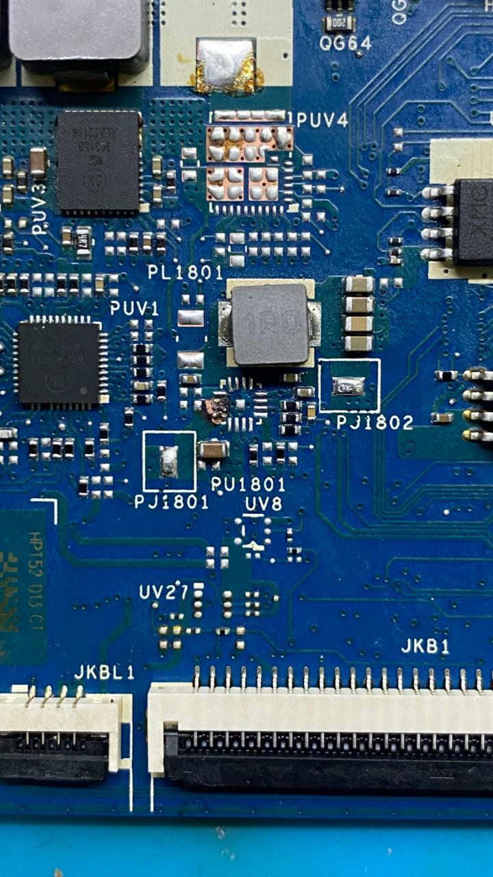

Need datasheet from this IC, LA-L001P

    What IC PU1801 on Motherboard La-L001P

    Schematics are not yet available for this model. Would you still have the original chip from this location?
    It may be the same as the one from this thread:
    https://www.badcaps.net/forum/troubl...09f-m15-pj1801

      this ic have marking "eHDEZ" on the body

        https://www.atombilgisayar.com/sy838...m3auaeI9i8-Pav
        Silergy SY8386RHC
        https://www.aliexpress.com/item/1005...RoCF5YQAvD_BwE
        Datasheet:
