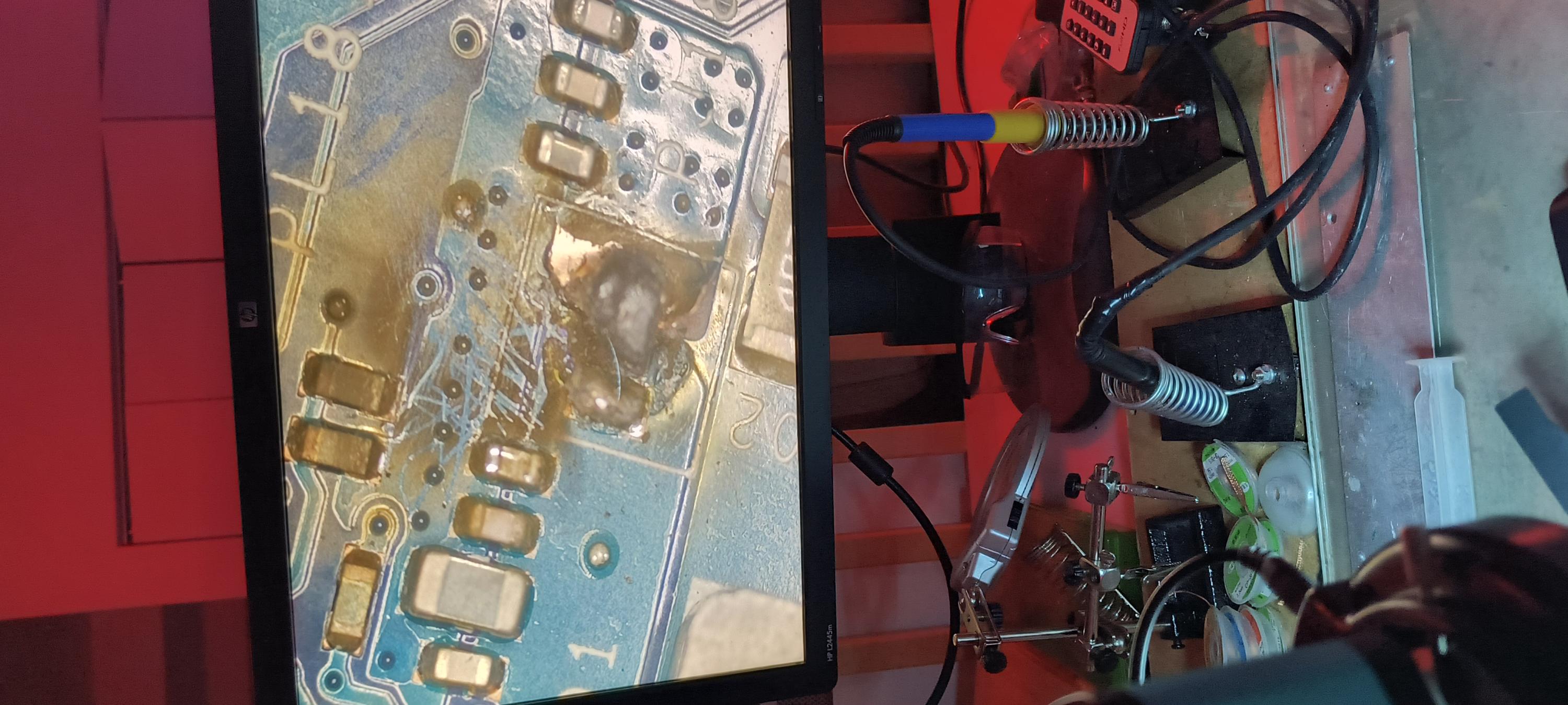

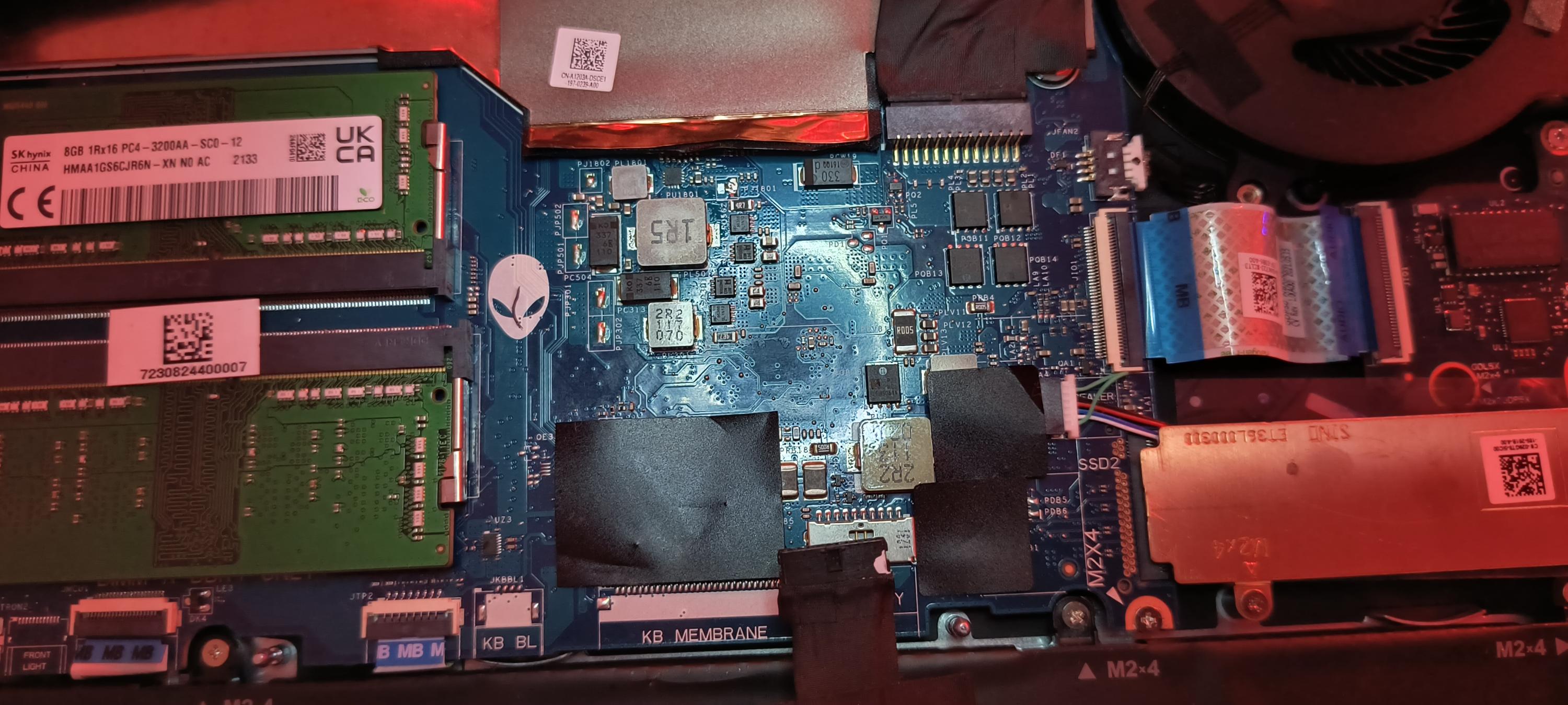

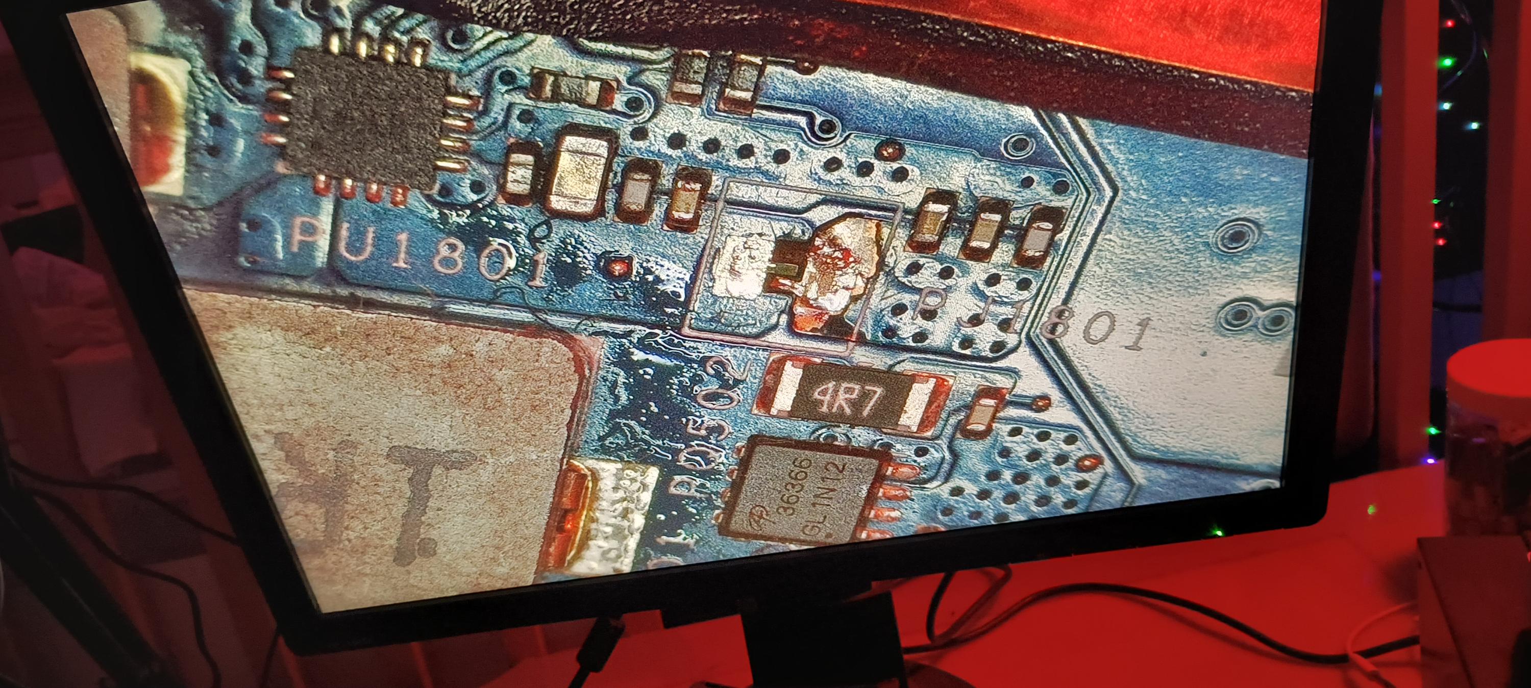

    alienware p109f m15 pj1801
    anyone know what that component ? i got someone bringing it to me wit that package blown and cant find any schematic
    thanks alot mates

    Unfortunately you forgot to mention the board-number and/or the top marking of the IC, which means we have to ask our crystal ball then.
    Probably something like a inductor/fuse at the VIN. If there us another similar controller you'll probably notice the same design with same component at VIN used.
      Its a jumper. Looks like its been arcing or something

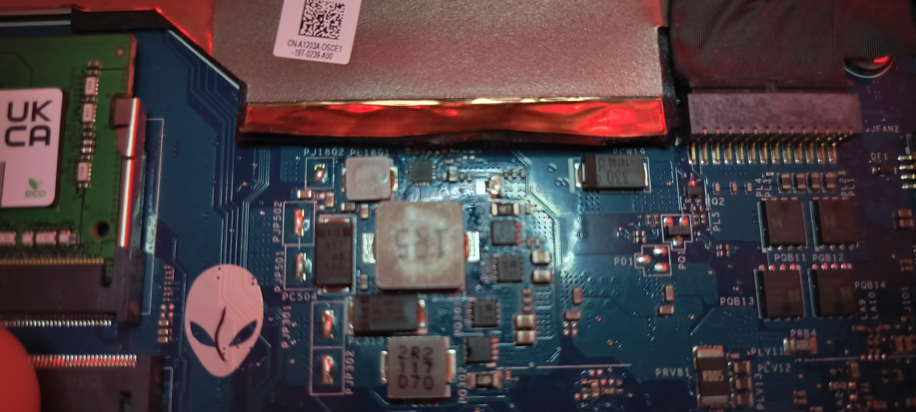

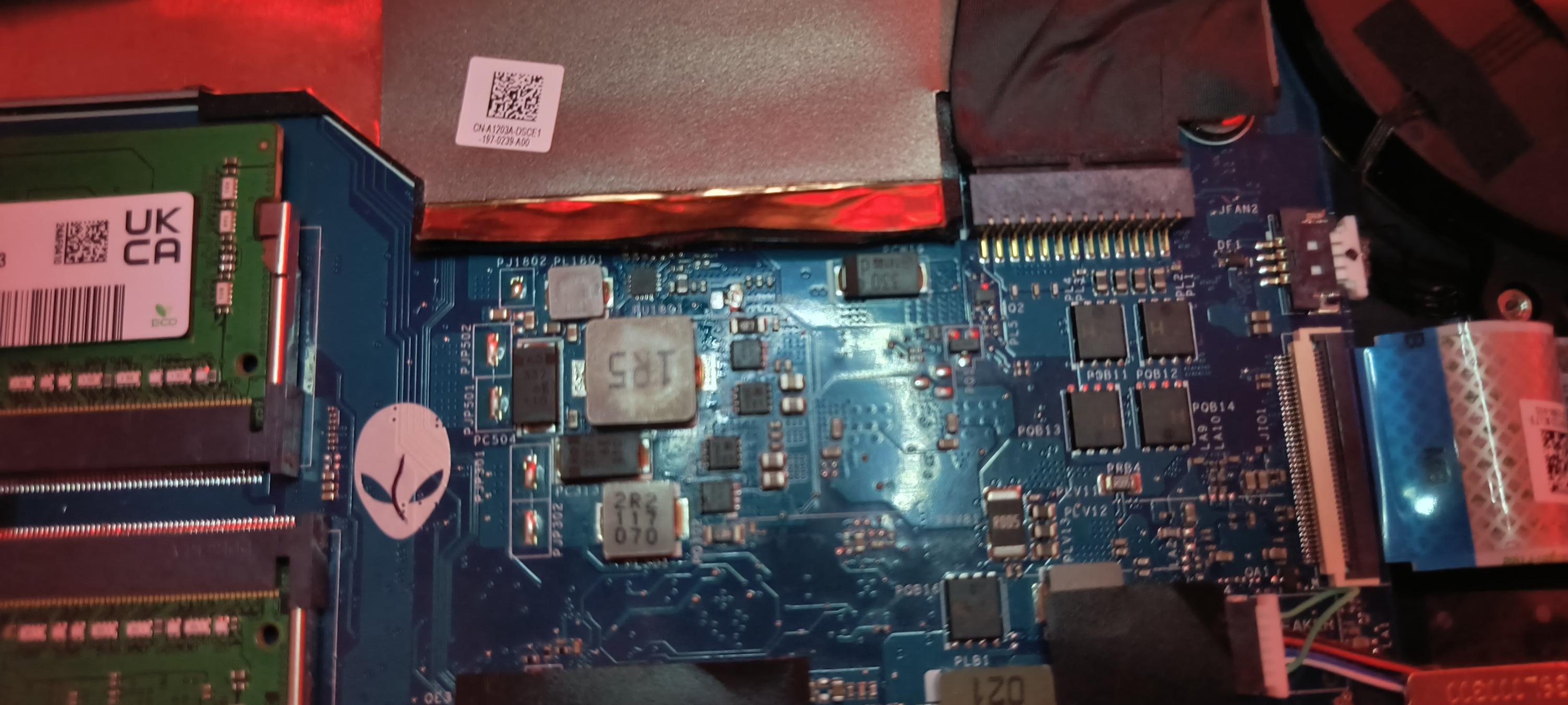

        Re: alienware p109f m15 pj1801
        so u guys telling me that there many m15 p109f version of logic board ?
        • mon2
          • Dec 2019
          • 14995
          Share the topside markings of PU1801 IC. A clear pic of the same is even better.

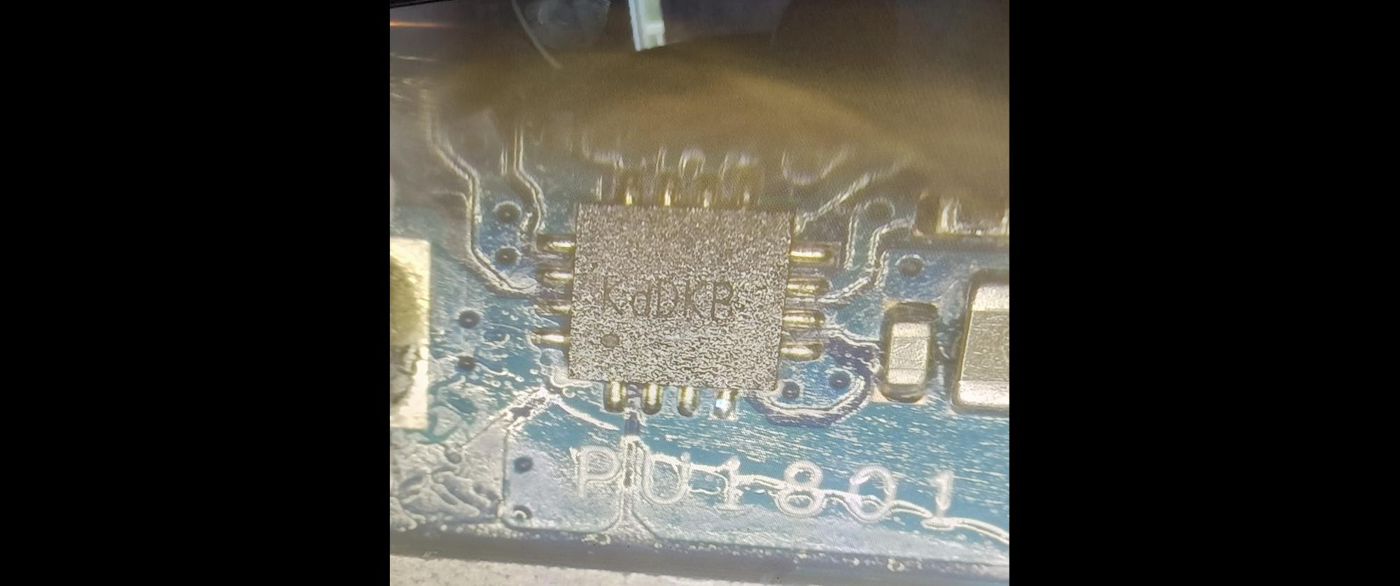

            here the ic , short is coming from there on the bottom side of the chip when i inject voltage , KdDKB
              Silergy SY8388RHC
              https://www.silergy.com/cn/productsview/SY8388RHC

                • Vesko356
                  VIP Moderator
                  • Aug 2018
                  • 4386
                  • Bulgaria 🇧🇬
                  how did u find that ??!!!!
                  By the chip marking ---> Kd*** = SY8388RHC

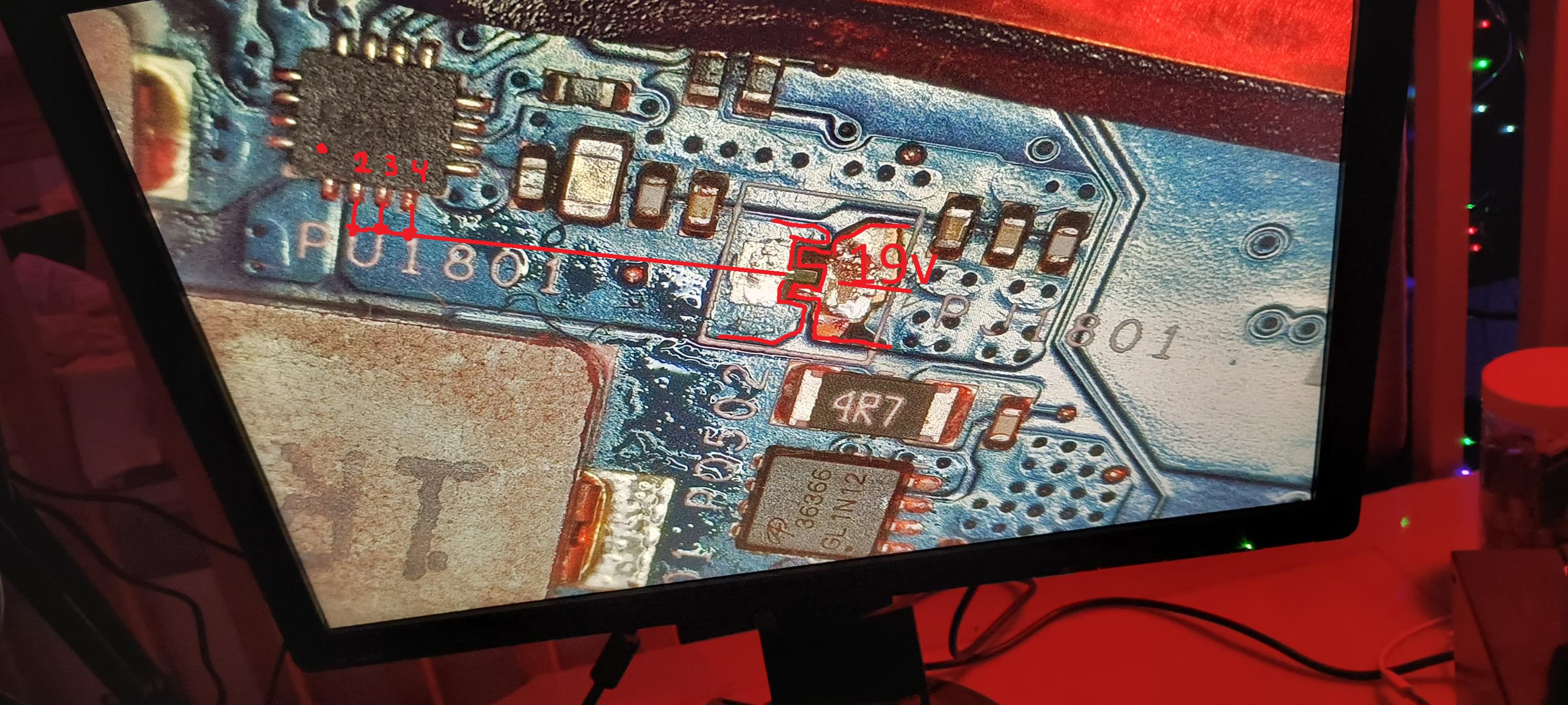

                        • Vesko356
                          VIP Moderator
                          • Aug 2018
                          • 4386
                          • Bulgaria 🇧🇬
                          im amazed ..... what do i do wit the jumper next ? cant have the part code since its blown ..
                          Pin 1, 2 and 3 are common and according to the SY8388RHC diagram are 19V VIN, this voltage is passing through the jumper (PJ1801) supplying the main power to the chip.

                          • Sephir0th
                            • Oct 2020
                            • 1289
                            Good call my friend. It didn't even came into my mind it could be simply a solder blob...
                            However, since there was some mess done, it is likely bad news for one of the BGAs. Silergys rarely die without taking something with them from the load...
                            Btw: afaik the output voltage of these type of Controllers is controlled by a voltage divider at the feedback circuit. so it might be possible to assume the output voltage from a simple calculation here.

                              • 22424
                              There`s some debate over the marking code, see posts 10 and 14 in this thread -> https://www.badcaps.net/forum/showthread.php?t=115810
                              You can google both part numbers.Ebay,ali,taobao and other chip sellers list both with Kd or eH .The only difference between the two seems to be the rated amperage
                              SY8386RHC 6A
                              SY8388RHC 8A

                                i ordered the kd from ebay , but i must be missing something , that jumper , what it is ? whats the part ? any picture or code?

                                      i dunno how to say this ... wit my french canadian sry for everything .. i know i look dumb but I am in EMC , and for me a jumper does look like a bios mobo jumper,, so if I leave it like this its ok ? or do I have to jump it wit a wire so it doesnt cancel the flow ? u guys are talking about 19v , that must be for something about the emc? it need a component of at least lets say 21v as a emc jumper ... but i never had to replace or look at it , if i google emc jumper they show me bios jumper from mobo..
                                      • HelpMeRepair
                                        • Jun 2022
                                        • 62
                                        me when i unsoldered that solder blob i thoug it was an ic , but when i saw the connection pathern behind i was like HUH ? look like a fuse or something..
