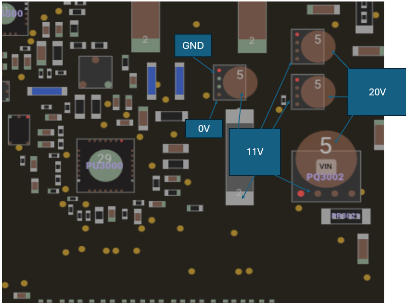

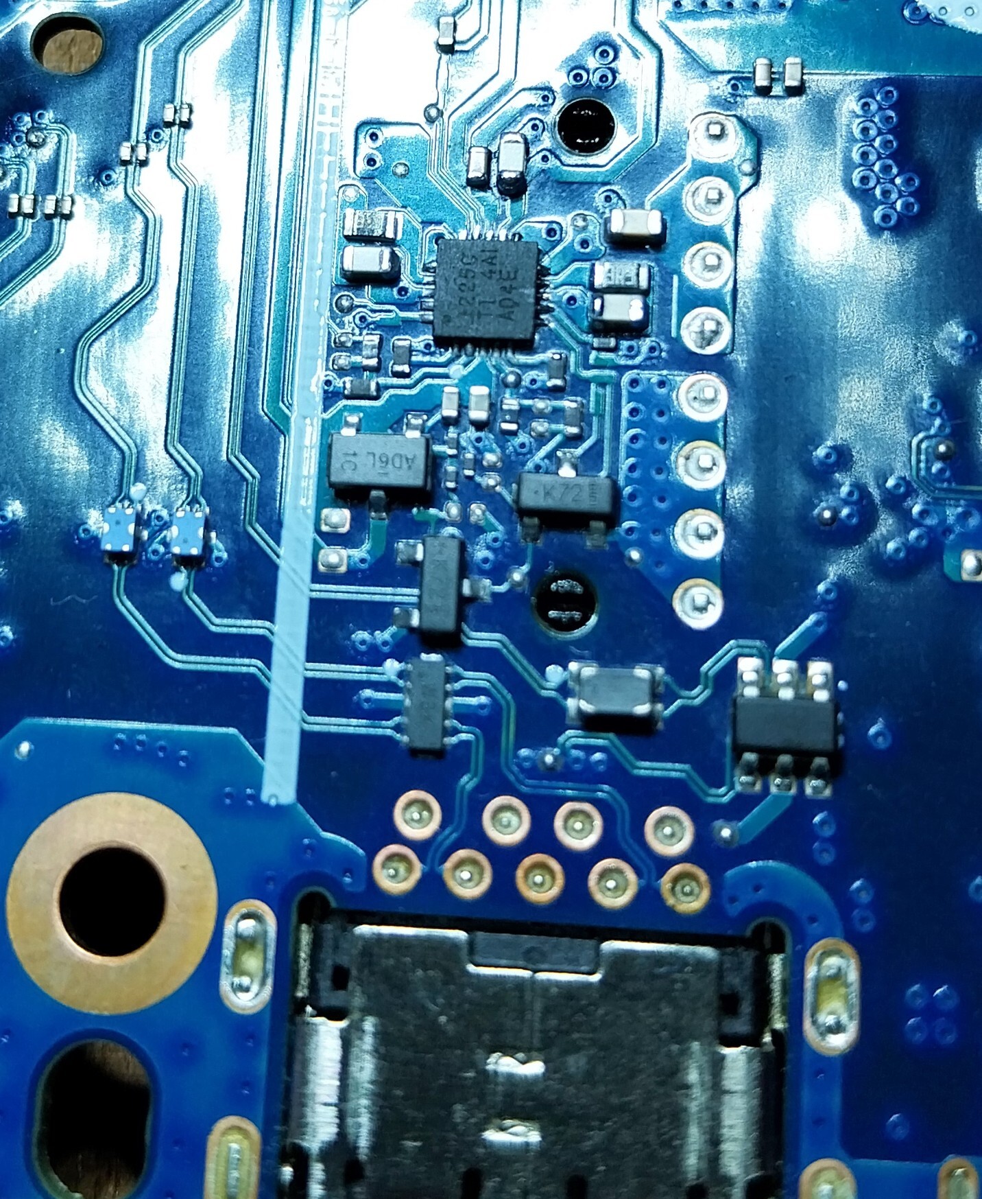

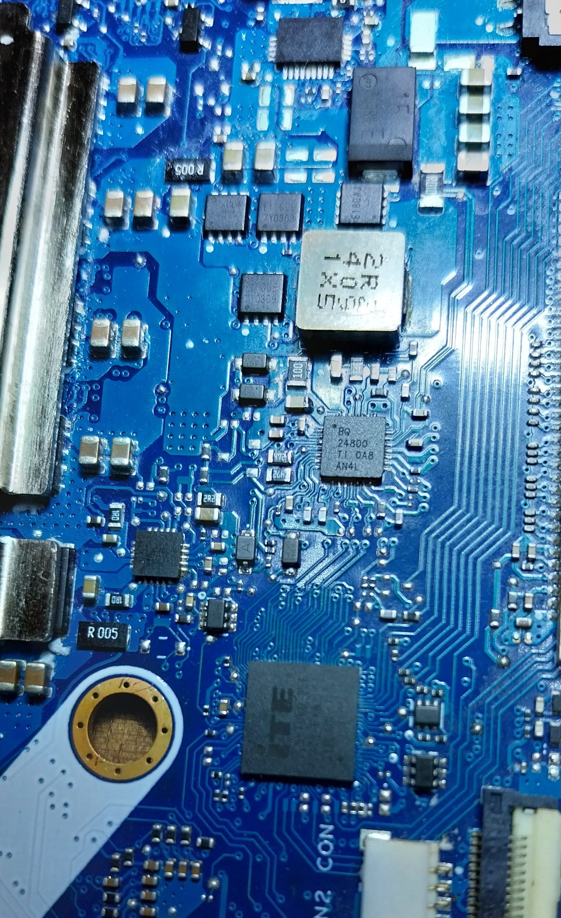

Hello, can a kind soul send me a picture of this part, I got the computer like this, I think it's the chip 3/5V, I asked on the site for the boardview, thank you for the help
NEED A PICTURE - ASUS TUF A17 706N - DAONJXMBACO REV: C

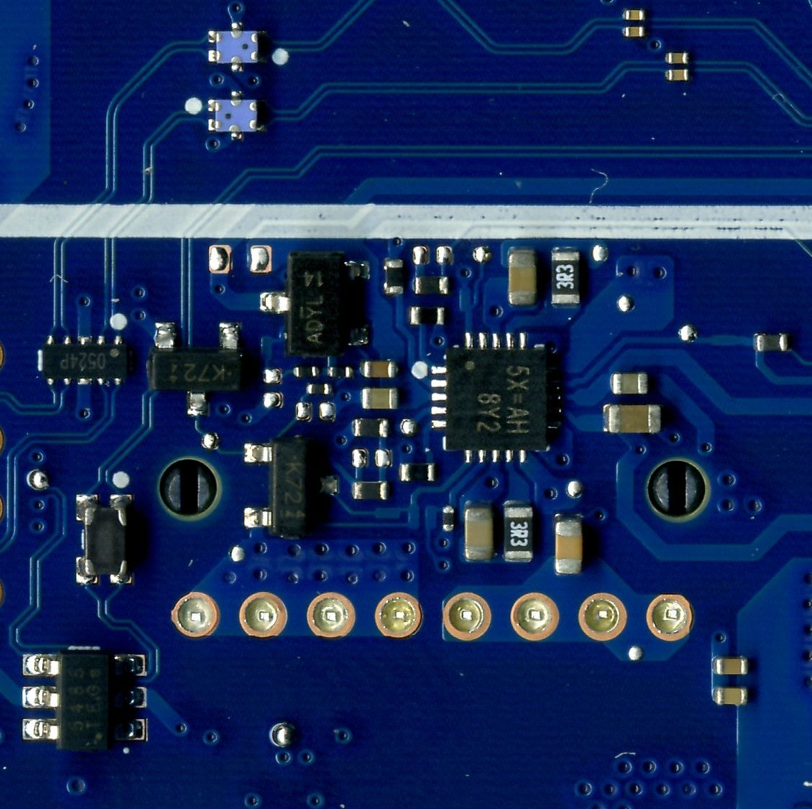

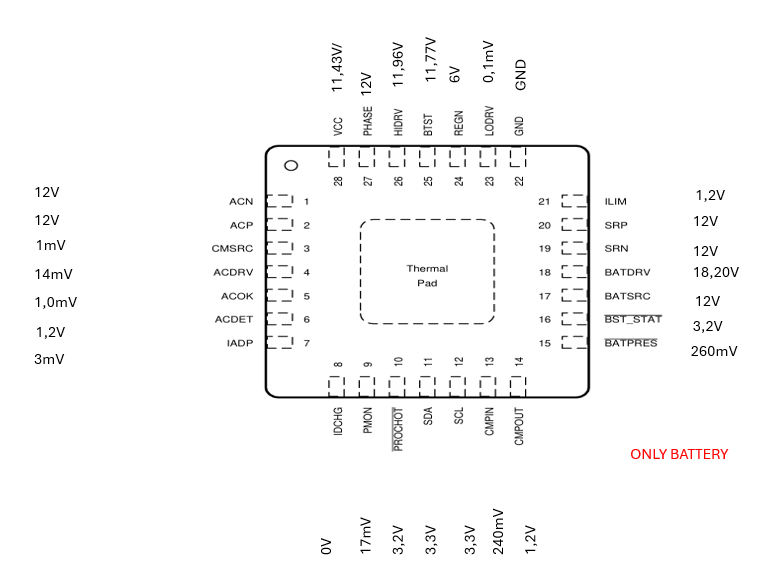

First things that are strange are SCL and SDA should be 3V, these are the communication lines with battery, BATTPRES should change when battery inserted. I assume that battery is not detected in OS. The data lines are usually pulled high via resistors, find these and check.Comment

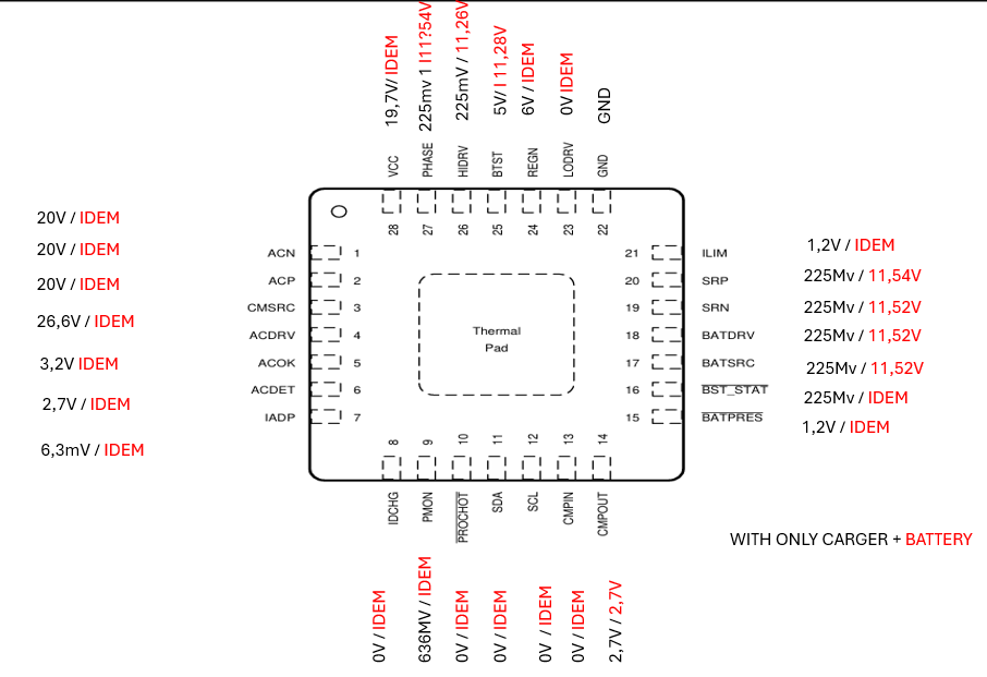

Hello, I checked the resistors, they are good, there is no 3V output from the battery data lines, the tracks to the charging chip are good, I checked the battery on another PC, it outputs 3V on the data lines
One last thing when the computer runs on the battery without the charger connected, the battery is well recognized in the operating system
Battery is not the source of the 3v on data lines, it is coming from mainboards 3V rail, which is strange if you are saying that if running only from battery the 3v is present. It should be there when running from adapter also. Take the measurements again when running on adapter with and without battery.Hello, I checked the resistors, they are good, there is no 3V output from the battery data lines, the tracks to the charging chip are good, I checked the battery on another PC, it outputs 3V on the data lines
I just took the measurements twice, and they are exactly the same. What could be the problem?
When I plug in the charger first and then plug in the battery I don't get the 3V from the data lines, if I do the opposite I do get the 3V
When I plug in a power supply to charge the battery directly it doesn't work.Comment

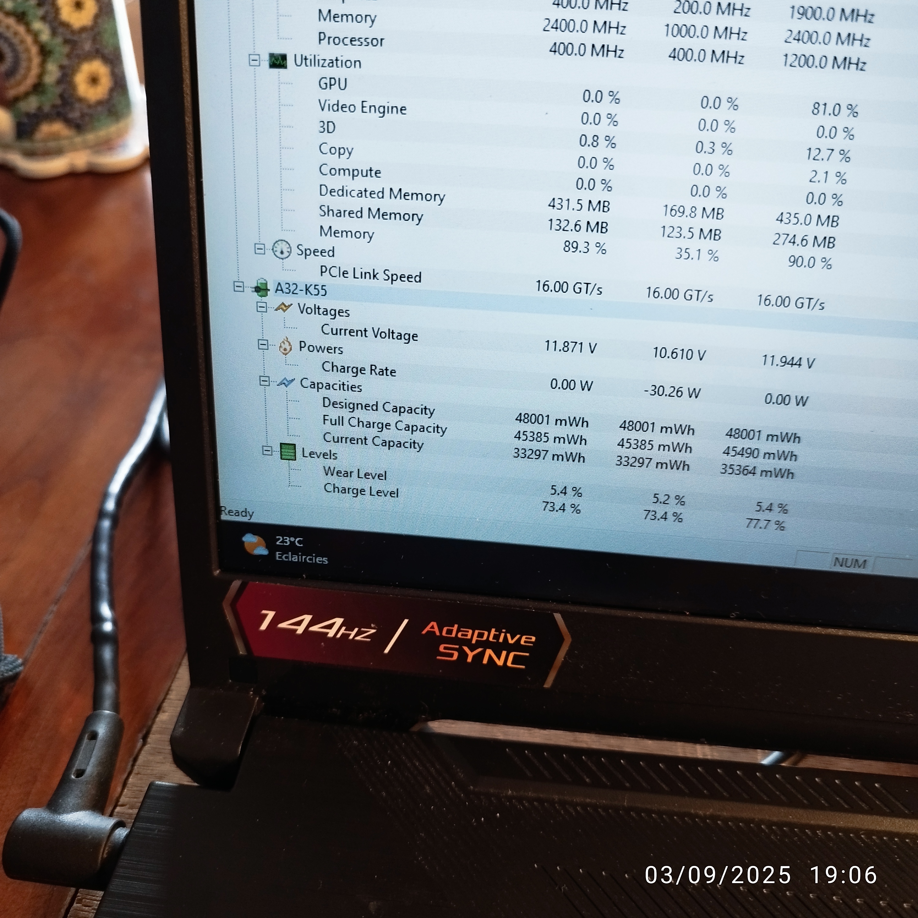

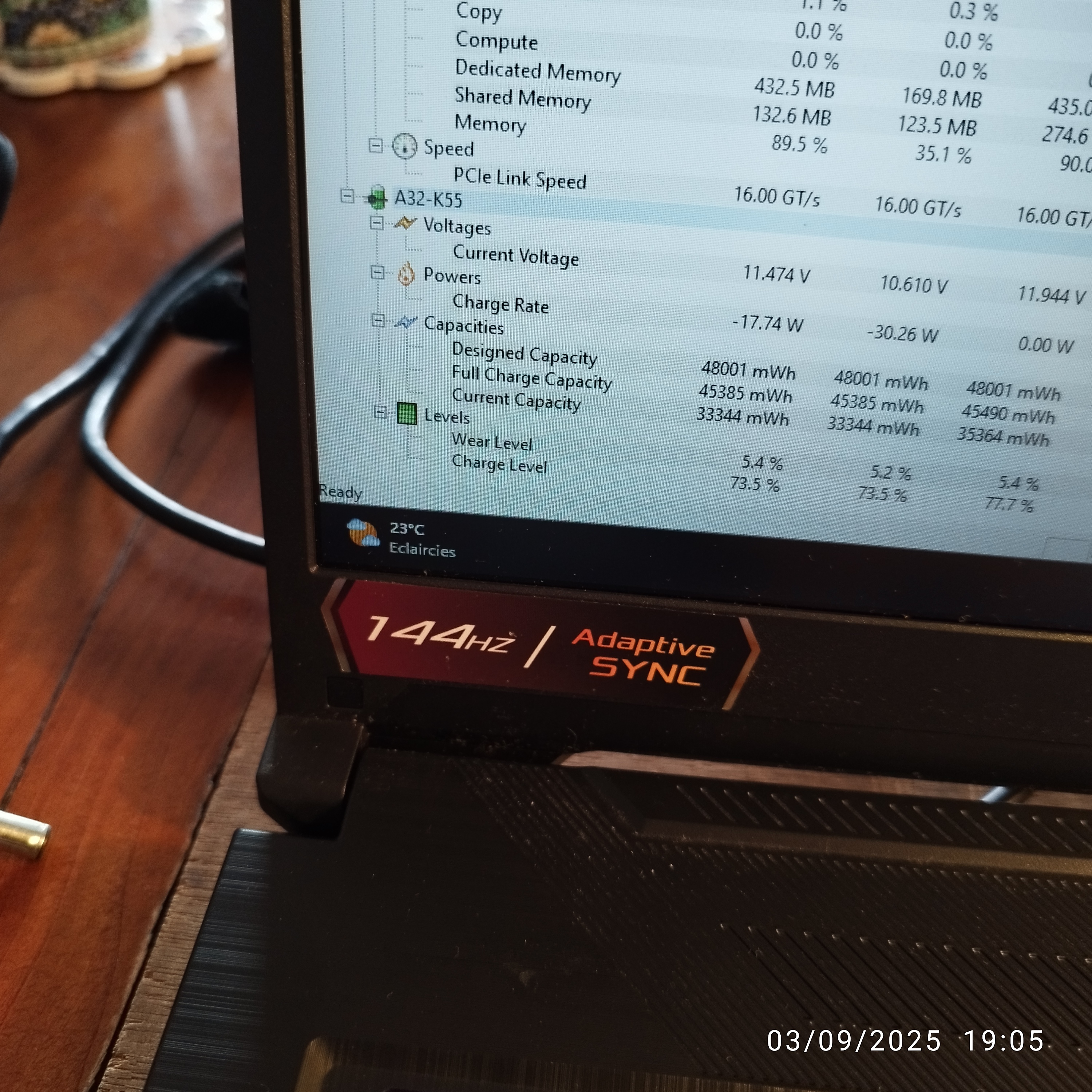

And it is showing charging/not charging? Use some kind of utility to display detailed status of the battery (Aida for example shows charge/discharge rate) rather than just relying on windows. Also do you have the original power adapter?
