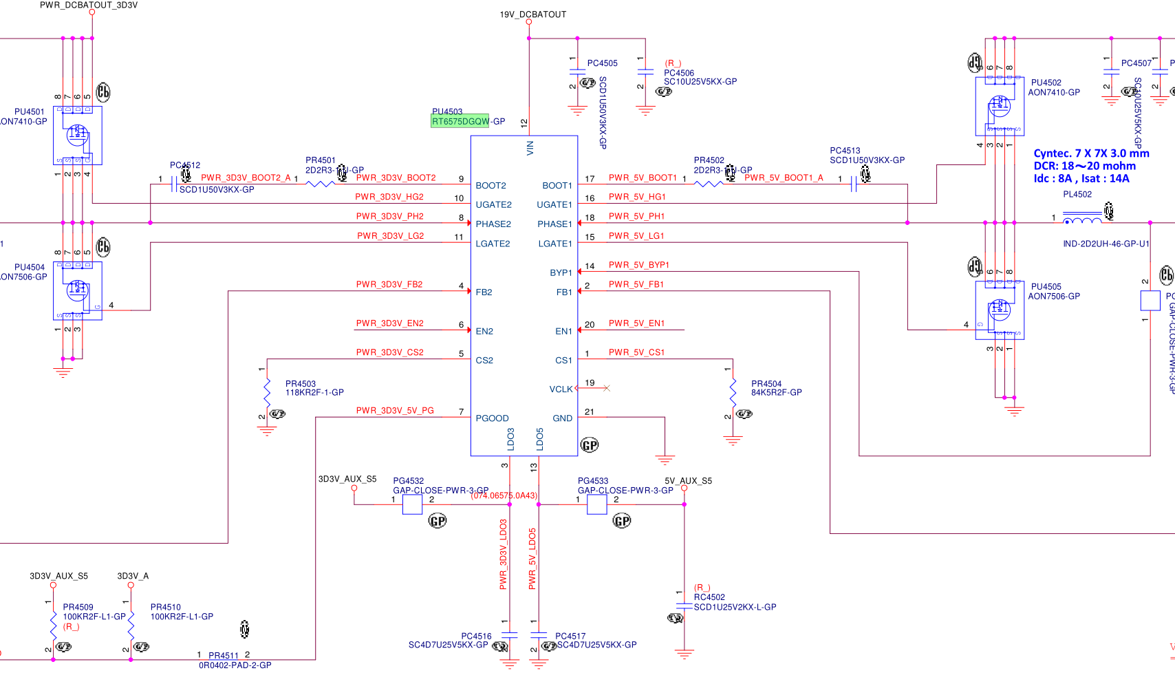

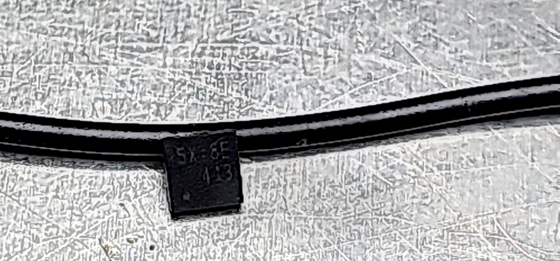

IC Marking Code 5X=8E
04-12-2023, 04:50 PM
IC Code 5X=8E
Please Help Me Out!

04-12-2023, 05:04 PM
Re: IC Marking Codes and Datasheets
Attached
DS6575CD-04.pdf

04-13-2023, 05:27 AM
Review the sticky above on parts markings. If the part has '=' then we know the part is from Richtek.
Then search for '5x= richtek' in Google. It will be the first link. You can buy the part from AliExpress.
The markings after the '=' are manufacturer date codes and not important to match.
