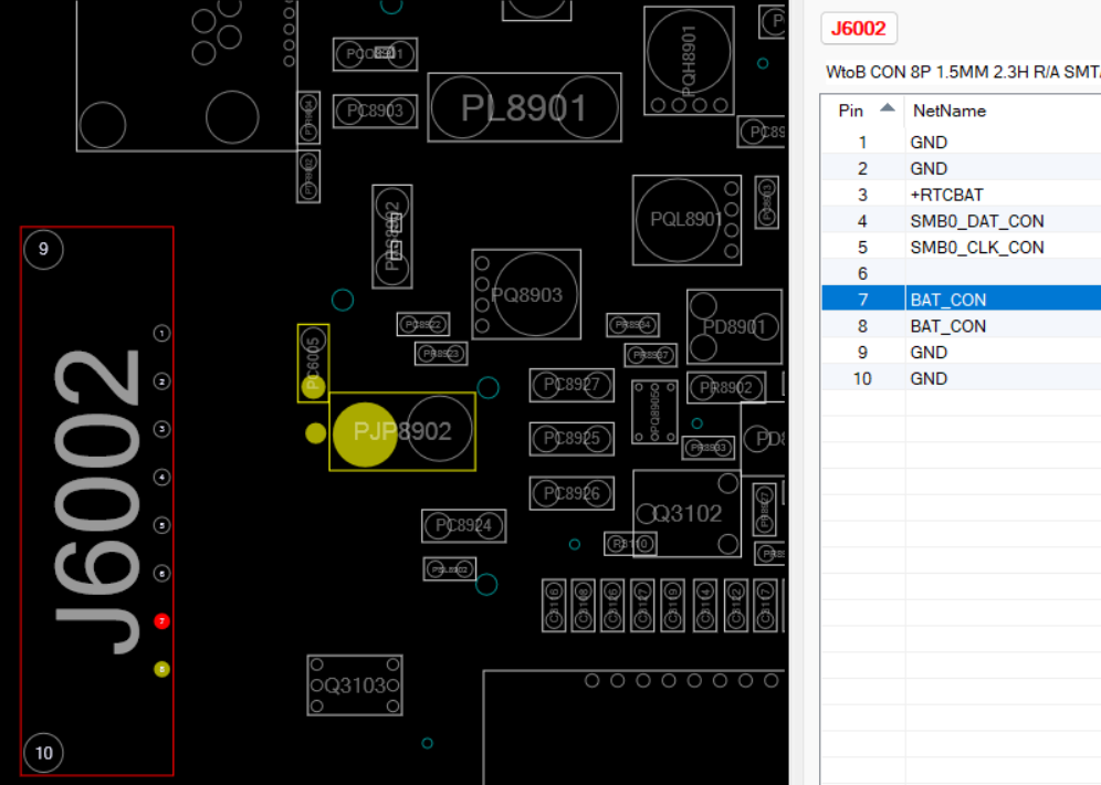

    Which connector is 0v on the board ?
    • someonenotyou
      • Feb 2021
      • 63
      • LV
      BAT_CON does not give any voltage to the board.
      • mon2
        • Dec 2019
        • 14694
        Share the topside markings of PU8901 = battery charger IC.
