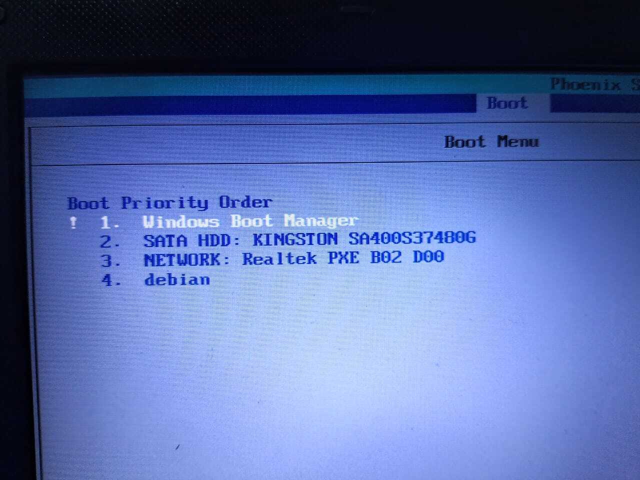

    BOOT PRIORITY ORDER (img-05)
    1- Windows Boot Manager
    2- SATA HDD
    3- NETWORK
    4- Debian

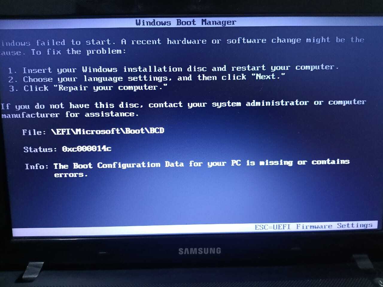

    But it returned the following error: (img-06)
    1. Insert your Windows installation disc and restart your computer.
    2. Choose your language settings, and then click "next".
    3. Click "repair your computer"​
    If you do not have this disc, contact your system administrator or computer manufacturer for assistance.
    File: \efi\microsoft\boot\bcd
    Status: 0xc000014c
    Info: The boot configuration data for your PC is missing or contains errors.
    1. Insert the Windows installation disc and restart your computer.
    2. Select the language settings and click "Next."
    3. Click "Repair your computer."
    Status: 0xc000014c
    Info: The boot configuration data for your computer is missing or contains errors.

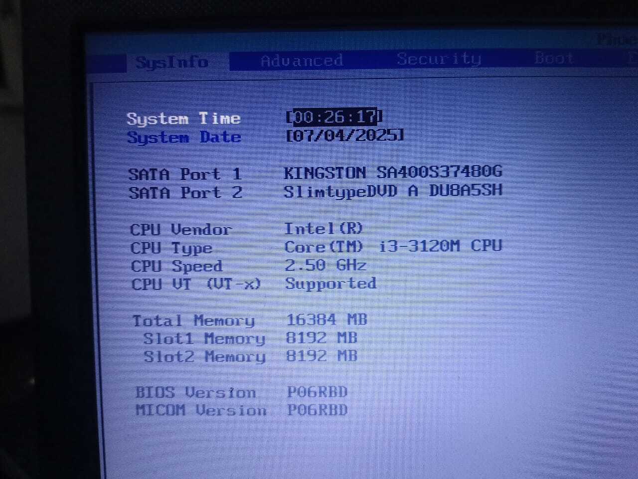

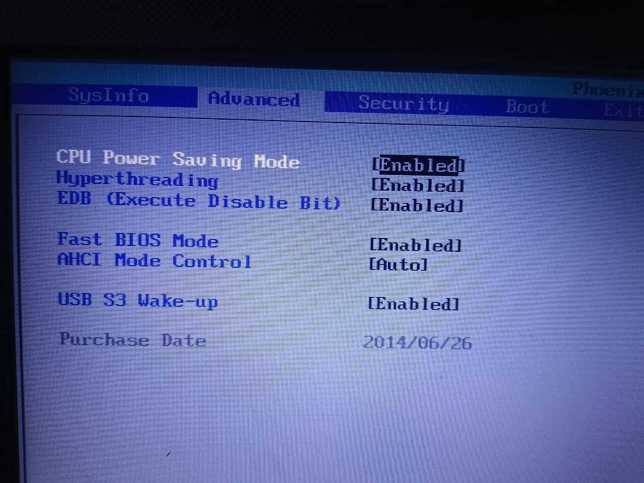

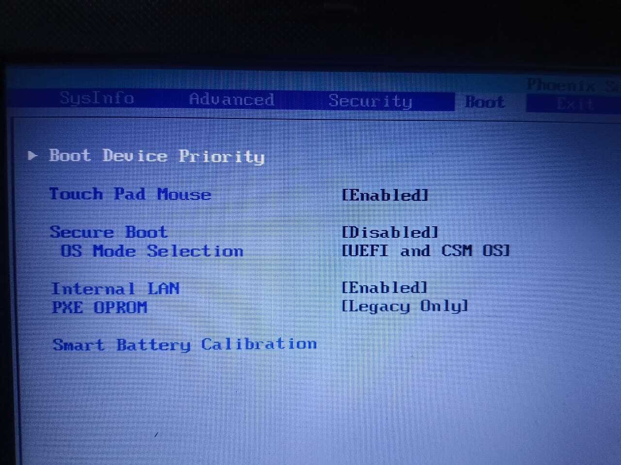

    01 - System Info
    02 - Advanced
    03 - Security
    04 - Boot
    05 - Boot Priority Order

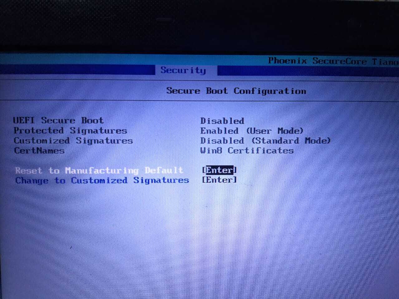

    06 - Error

    Try to boot a live Linux distribution and use efibootmgr to delete all boot entries.
