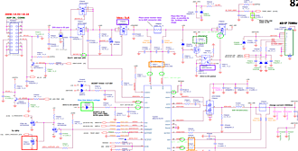

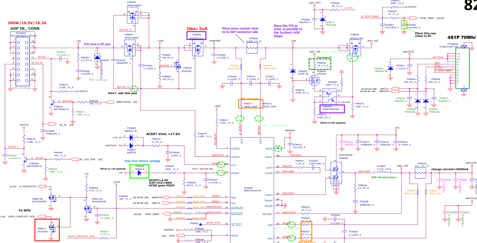

          I am guided by the following schematic diagram

          These are the mosfets on the input line

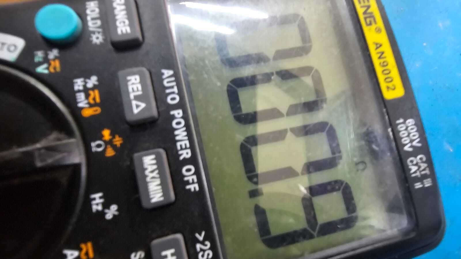

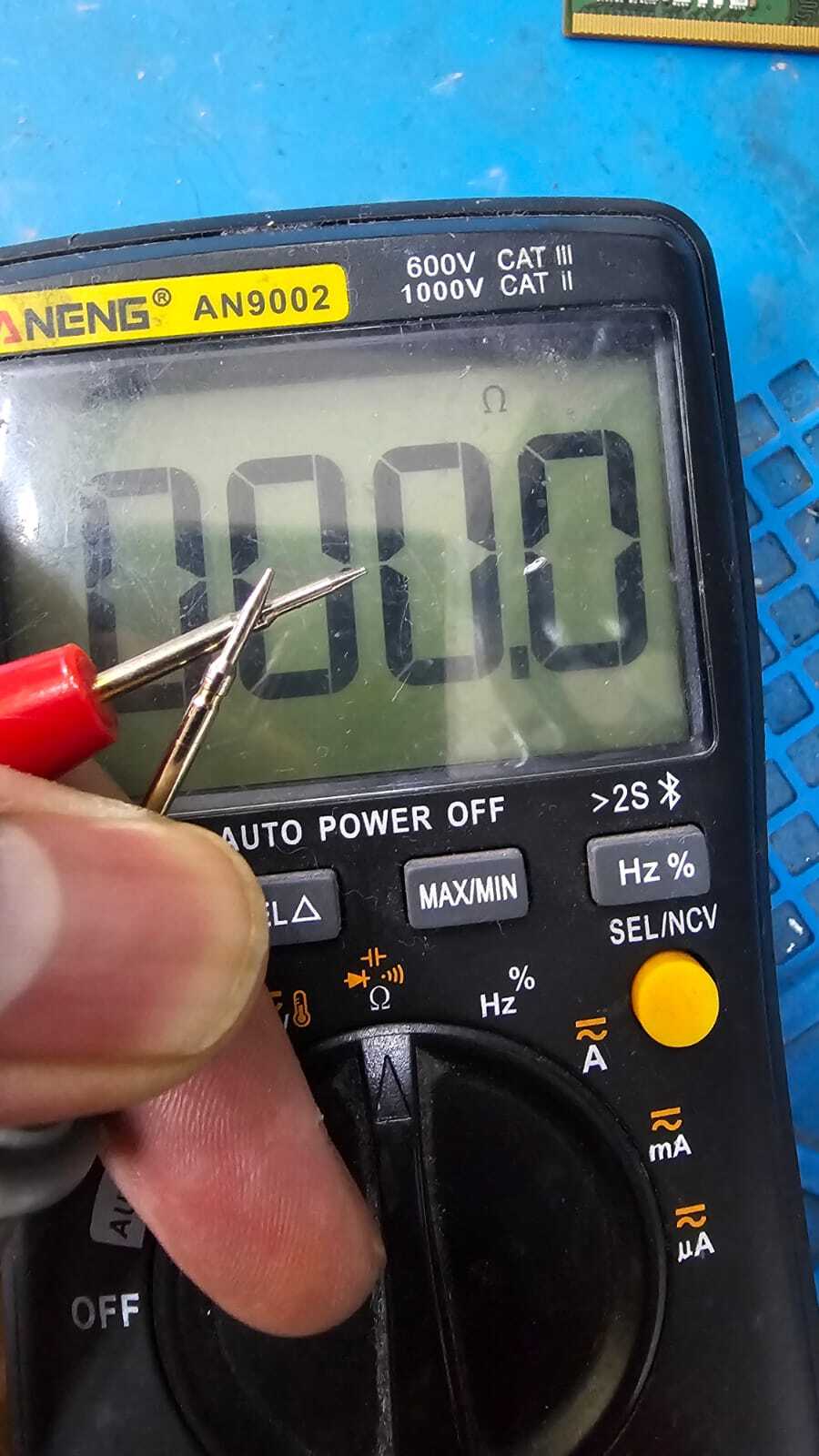

                    Using the lowest resistance scale on your meter, touch the probes together. What is the resistance?
                    • judamex
                      Active Member
                      • Jan 2021
                      • 186
                      • Mexico
                      Touching the 2 probes, this is the reading I got on the lowest measurement my multimeter has.

                      This is the reading by touching ACN(Pin 1) ACP (pin 2)

                            ACDET is barely on the border of showing a acceptable voltage (2.4V min.) So maybe worth to take a look here and see what happens when higher voltage (2.6V - 2.7V) reaches this pin.
                            Other than that the BQ24781 are known for notorious failing. So I guess the "Brute-force" method, so simply to replace it would be a option here. Iirc it is interchangeable with BQ24780S.

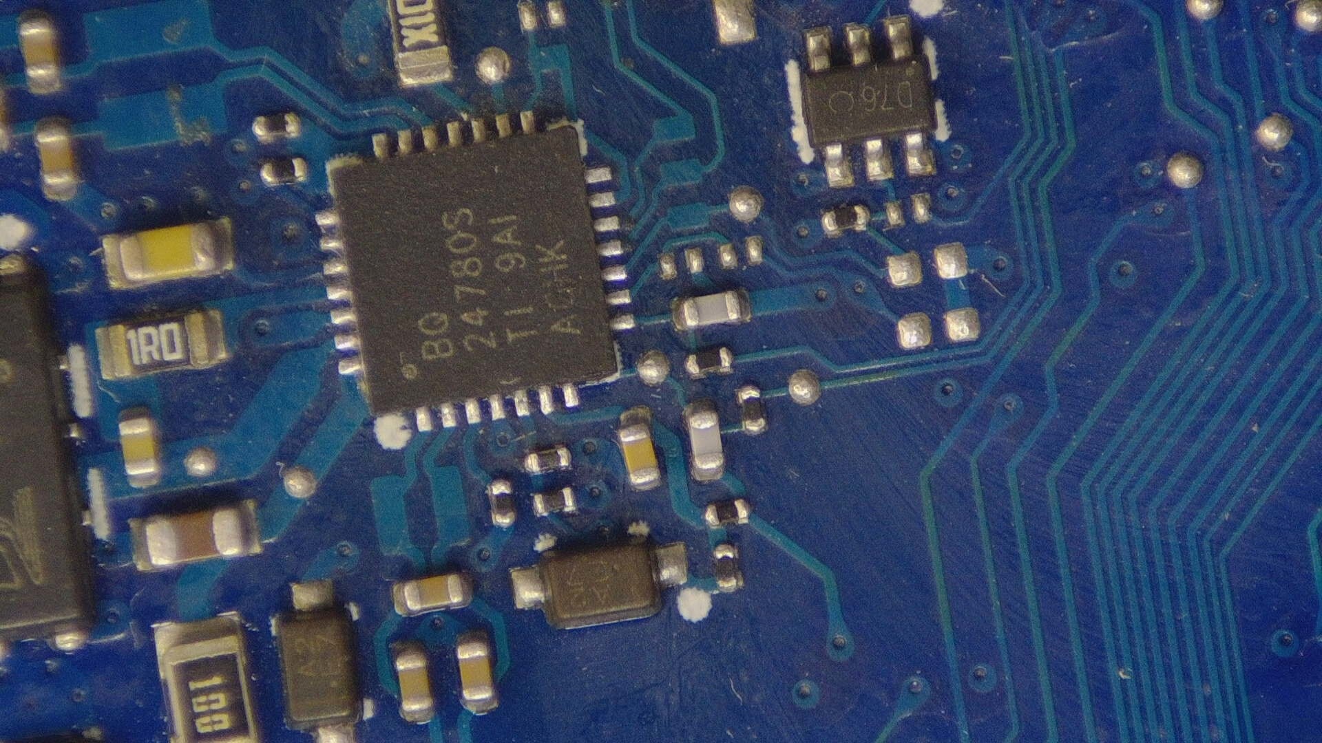

                              I replaced it with a BQ24780S and the conditions remain exactly the same. How could I increase the AC voltage? It's currently 2.49. Could I remove or change the value of any resistors?
