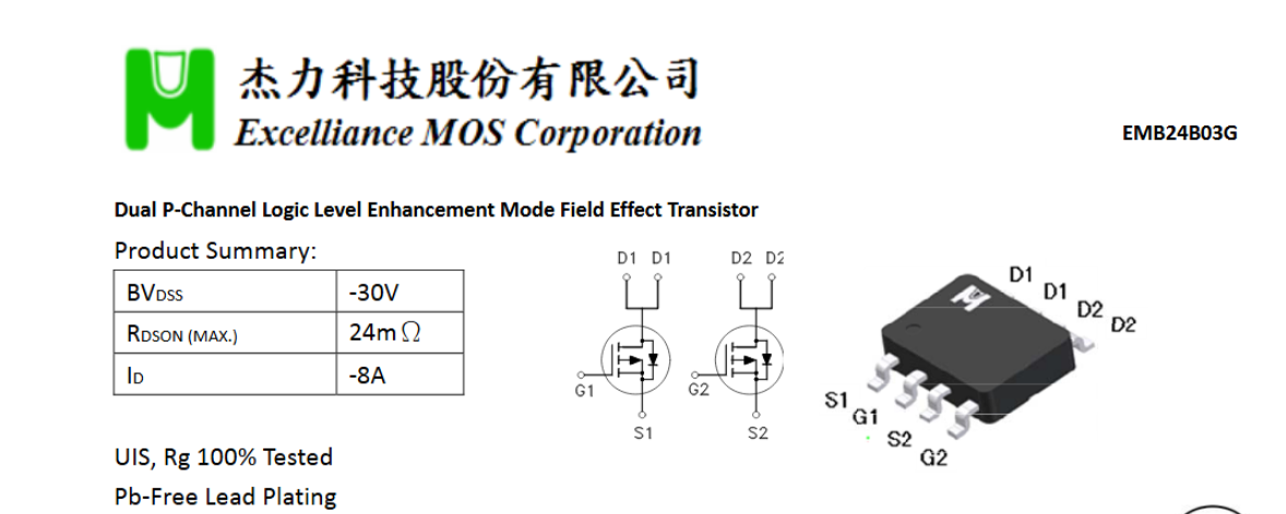

              EMB24B03G PQ1
              EMB20P03V PQ2

                          I only wrote to you about one. EMB24B03G
                          Dual P‐Channel Logic Level Enhancement Mode Field Effect Transistor
                          I'm now writing to you about a P-Channel Logic Level Enhancement Mode Field Effect Transistor.
                          EMB20P03V
                          B20 P03​
                          Source & Drain, 66,4 K ohm
                          Source & Gate, 19,7 K Ohm
                          Gate & Drain. .570MG

                                Can you confirm that for the DUAL P-channel mosfet, you have indeed measured the resistance across each leg as requested?
                                The posted S1 and S2 measurements are for this single device?
                                Internal view of the dual mosfet:
                                The PQ2 mosfet is a single P-channel mosfet which is also low in resistance.
