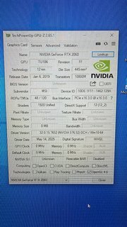

          Ok sorry it's maybe a bit confuse. Just starting to learn, so i am throwing what i'm finding until i can know enough and connect the data together.
          So starting again from Zero.
          MSI GL75 9Se have an additionnal Nvidia RTX 2060 GPU.
          This GPU is not working.
          Using GPU-z we can't see any BIOS or Clock frequency. But the GPU is recognized.
          Click image for larger version  Name:	20250601-111700-resized.jpg Views:	0 Size:	77.8 KB ID:	3651387
          Windows indicate in the device manager " this device have a problem, must be stopped" with a code 43 indicated.
          We have first try to update all drivers and GPU bios like it's explain by Nvidia to solve this problem that seem to be really common these days.

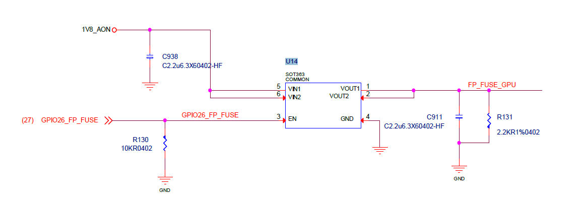

                              Thanks for helping.

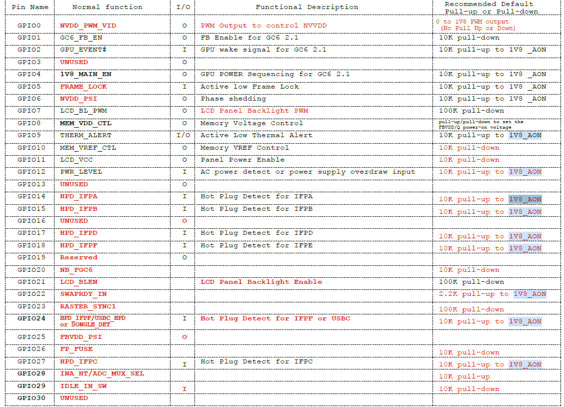

                              I took 1V8_AON ( n°5) and FP_ FUSE (N°1) on U 14.
                              this is very close to the GPU on the back of the motherboard.
                              schematics come from the 17E51-Rev 1.0 MSI motherboard.
                              A lot of things are connected to 1V8_AON. i don't really understand the goal of this signal. Seems that it could "down" by a lot of the GPU I/O in case of problem.
                              resistance measurement of 1V8_AON is 88kohms to the GND.

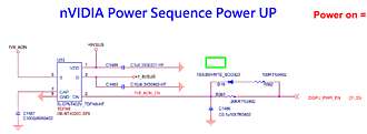

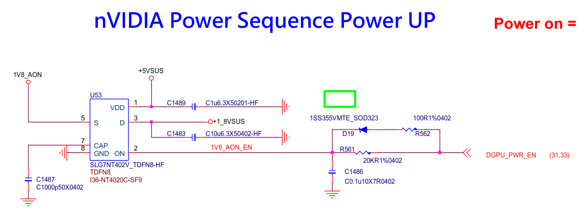

                              • m1ch43lzm
                                • Mar 2019
                                • 500
                                • Peru
                                Maybe check the chip which switches 1_8VSUS to 1V8_AON
                                U53 SLG7NT402V
Name:	Captura de pantalla 2025-06-17 195947.png
                                • totoFR37
                                  • May 2025
                                  • 15
                                  • France
                                  Hi.
                                  ok on U14 i have all the volatage around, and i have 1V8 AON working.
                                  in fact i didn't check correctly before, and i have the 1V8 working.
                                  So .. seems that i have all voltage working properly.
                                  the GPU is heating as soon as it start and the fan are running full speed also (not always)
                                  so i'm not still sure if i had to go to the conclusion that the GPU is the problem ?
