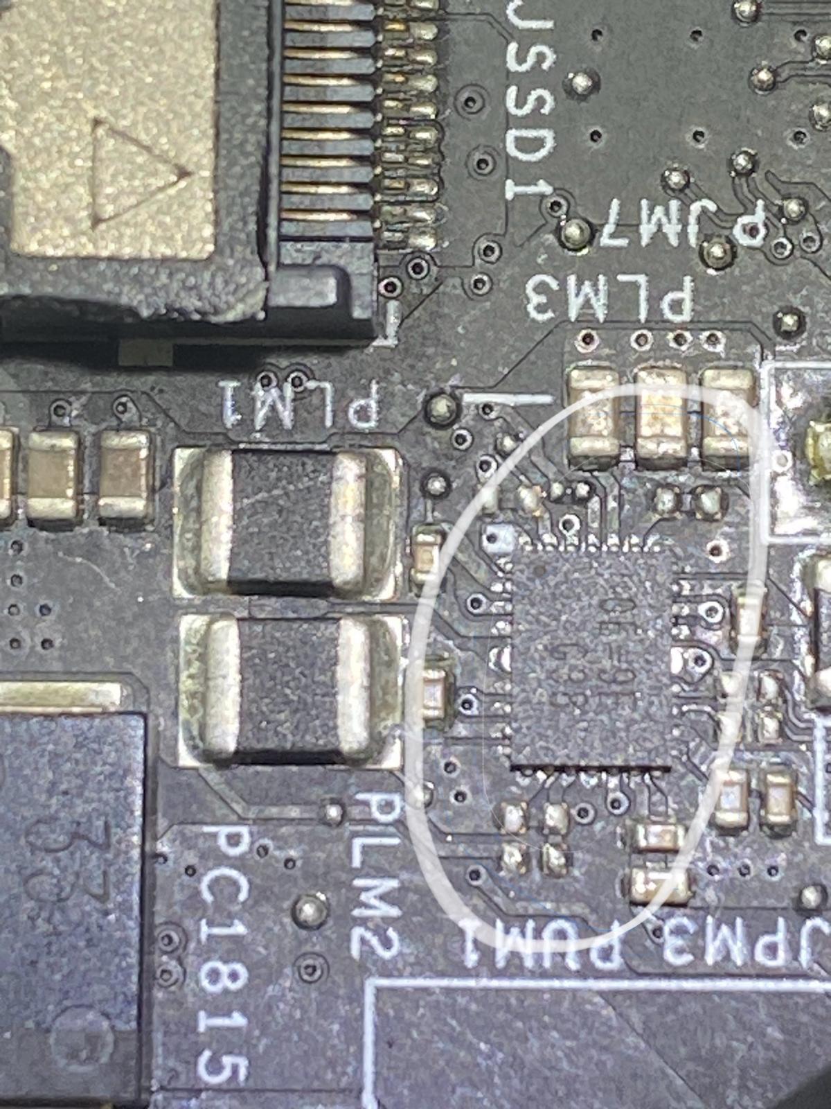

    Can someone help identify the following component ? this component get very hot. This is from a Lenovo legion LA-M822p motherboard.
    any schematics or board view for this motherboard ?

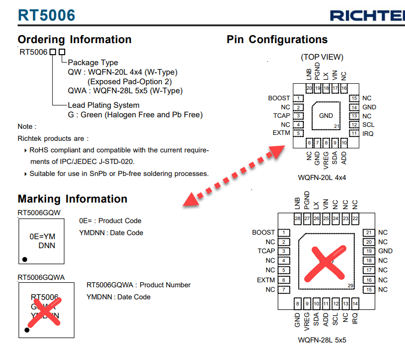

    Hi. See attached.
    Confirm against the topside markings which appears to be 'OE=' = Richtek.
    Richtek # RT5006GQW.
    https://www.aliexpress.com/w/wholesa....home.search.0
    Click image for larger version  Name:	match.png Views:	0 Size:	194.9 KB ID:	3648590
    Datasheet:
    DS5006-00.pdf

      Thank you mon2 however this ic looks more like a rectangle then square. It is 28-pin qfn however the ground Center pad is different.
      https://www.aliexpress.com/item/1005...martRedirect=y

        Noted. Review this part also from Richtek:
        https://www.mouser.com/datasheet/2/1...fBB1oYPE258Ctj
        This one also does not appear to be the same pins North and South. Strange that vendor has so many variations for the same markings. Best to source a matching part from AliExpress. May be a private part for the client.
