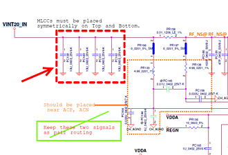

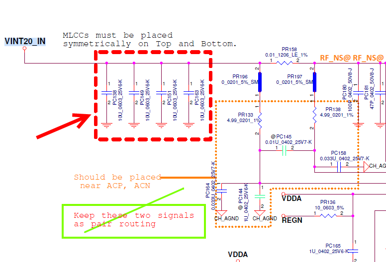

              • mon2
                • Dec 2019
                • 16085
                There is a short on this rail. Suggest to flux and remove PL1 and also PL2 since they are on the same power rail. After these 2 parts are removed, measure the resistance to ground again using the SMD pcb pads where these parts were soldered.
                Which side of the PCB pads is still shorted? Is it the upstream producer adapter side = PL1 pin #1 = PQ2 side or the downstream consumer side = PL1 pin #2?
                My suspicion is that the bad cap will be inside the attached capacitor cluster.
