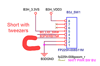

    the sio has a slight glow to it under the thermal camera. pwr_btn stays high at 3.3v after pressing the power button. PCH_DPWROK doesn't go higher than 1.0v. ec_rsmrst stays at 0v

    To save time, always link the schematic.
    The 'NH50HP' schematics are posted in the schematics forum.
    Locate and short the power button signal line to ground to emulate the power button.
        The power button is an active low signal. By default, the parked voltage on this line should be 3v3 when the power button is OPEN.
        When you press the button, the button should pull this line to 0v since the other side of the power button is mated to ground. Confirm it. After the button is released, the pull-up resistor will park the line once again to a value of 3v3.
        If you do not see this action, confirm the wiring to the power button line. As requested, use tweezers to short the pins on the connector block itself. See above and post back the test results.

          i don't see b3j_sw1 on this board

            pwr_btn goes to ground and then back to 3.3v
