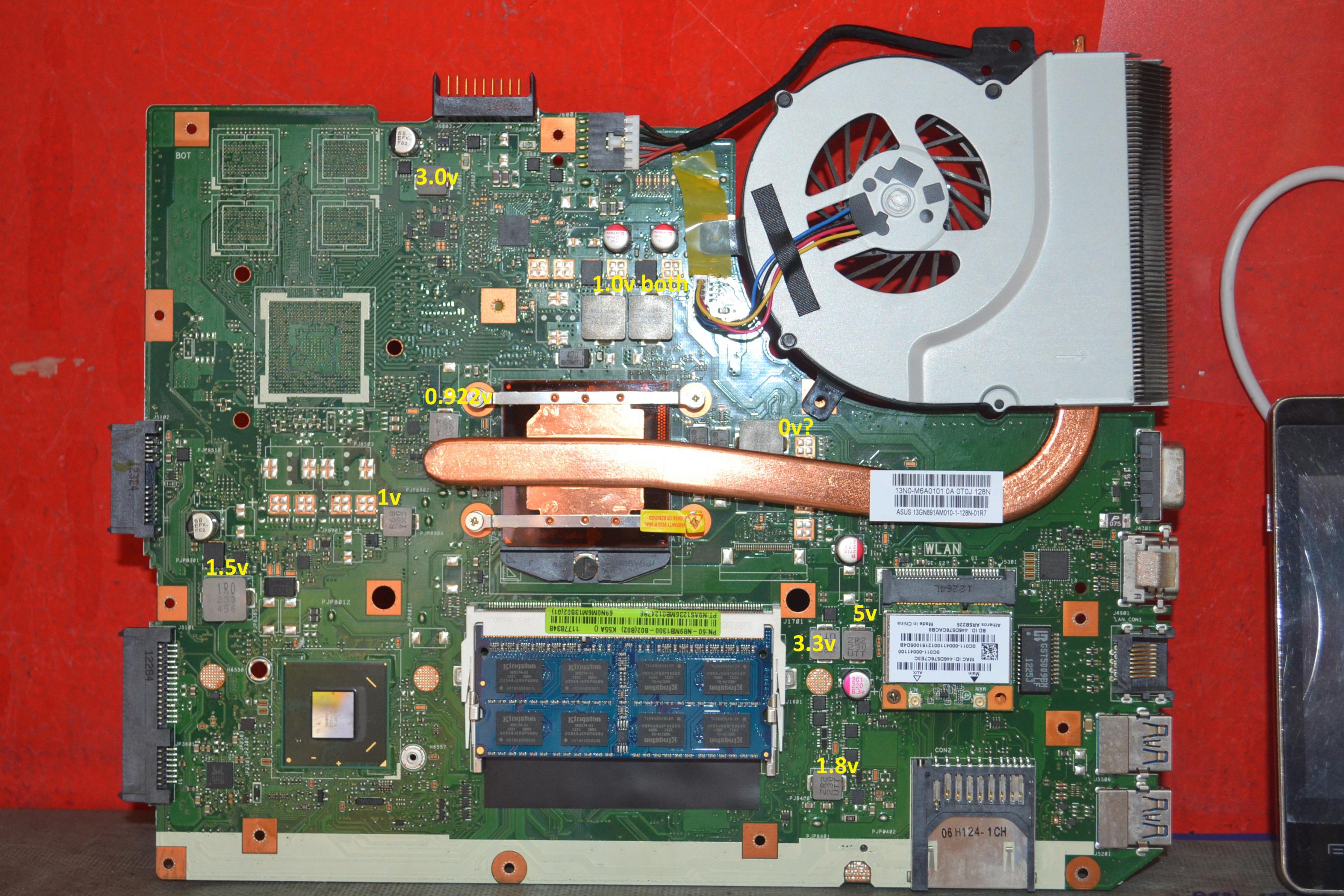

    hi guys i got here asus mobo. can somebody see and help me pls... i got those voltage in coil and one is missing. what might be the problem?

    Re: asus k55a no display
    which voltages u got?
      intel graphic voltage is missing (0.4v or 0.5v ). on some HP model reflow southbridge or flash bios can solve this issue
        CPU also can be bad as you don't have dedicated gpu on this board . don't ignore the (DC-DC) chip who supply this voltage can also be bad . good luck
          0v on single big coil near cpu socket. the rest are written on the picture..tnx
            thanks
            where exactly could i find that voltage? i did mild reflow on S/B chip and doesn't work. do you think its bios problem?
              ok i will try that thank you....

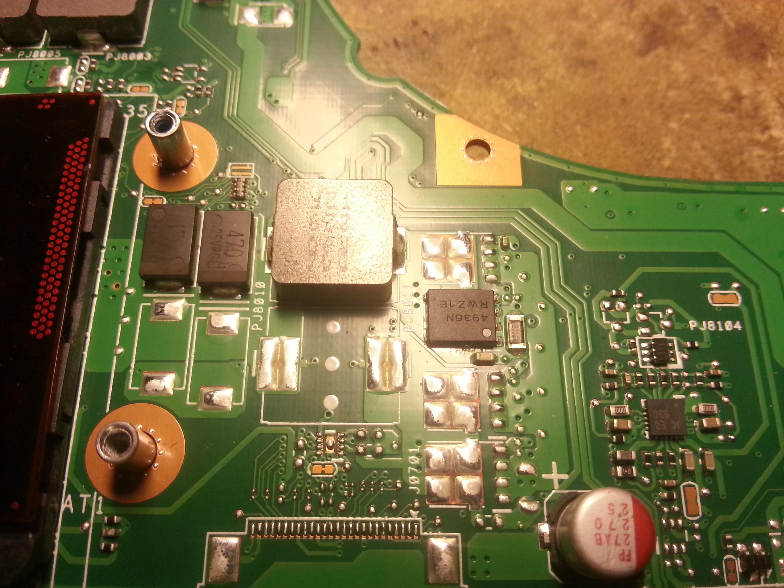

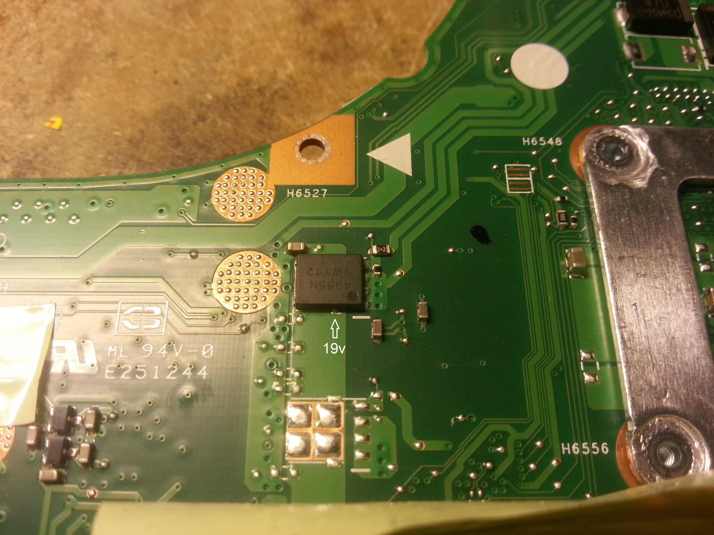

                    No, but i have found a couple of Mosfets that don't seem to have the correct voltages.
                    19v on the Drain with no voltages on the Source or Gate of the mosfet on the rear (4955N) and 1.6mv on the Source on the front (4936N) mosfet.
                      I forgot the photos
                        I have tried a replacement CPU and still the same issue. DC-DC chip problem ?
                          remove coil and check for short.
                            By measuring the resistance between ground ?
                            Nothing on the back.
                            The two diodes next to the cpu show a short until i remove the cpu, is this normal ?
                            Source of the 4939 is to ground also.
                            I'm not quite sure what i'm doing, your help is much appreciated.
