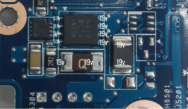

toshiba c855-139 no sign of life
  • ahmetozay
    • Jul 2013
    • 73
    • turkey
    Hi folks, this toshiba c855-139 has 19v. But there is no 3v/5v exist. also there is no voltage at on/off switch. i send the picture where 19v drops to 0.9 volt. thanks

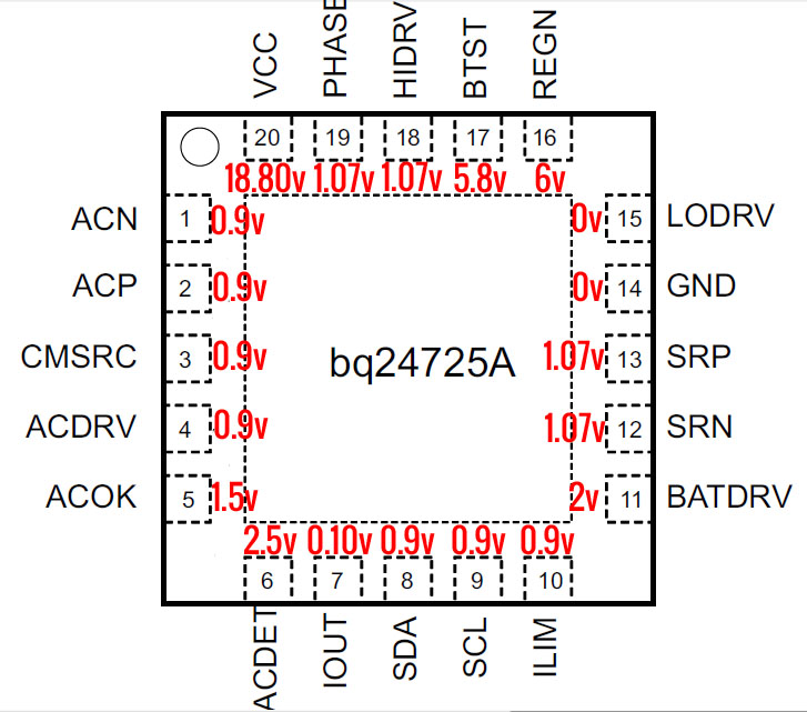

    Re: toshiba c855-139 no sign of life
    here is the charging circuit voltages
      start from there!
      ACN needs to be 19v trace it back and see what is bad
        short somewhere. with multimeter check the 0.9v output to ground(adapter unplugged) ; you must get low impedance
        first check the two N mosfet (big and small one ) on picture for low impedance.
        if no short a this point assume bq24725 might be bad (rarely according to my experience) or one of the components( transistor cap ic chip) supply by 19v on the board is bad
          Thanks for your replies especially Dycc, i cehecked the impedance on big and small mosfets and it is 8 ohm on the small one so i changed it and everything works ok. thanks again
