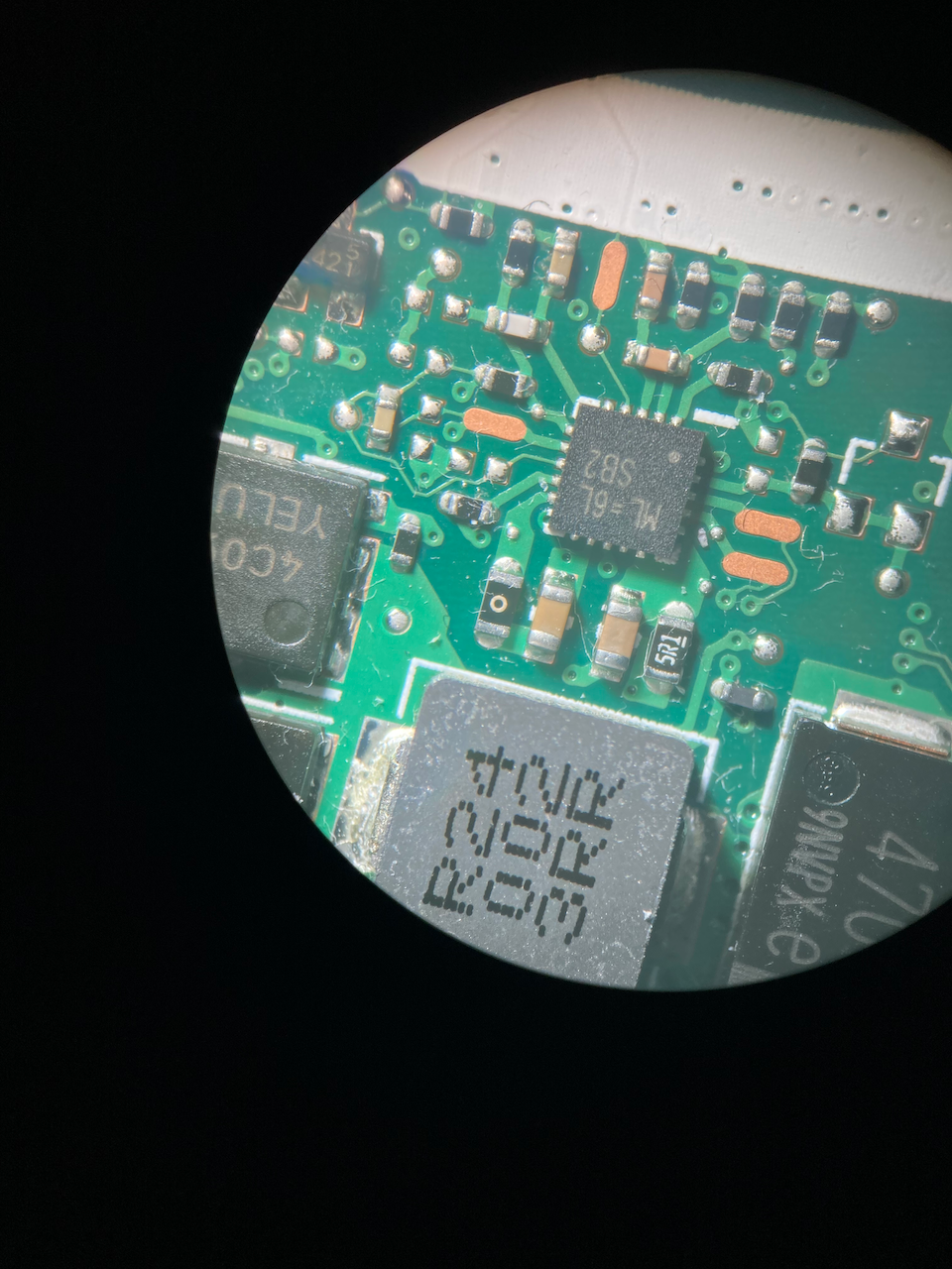

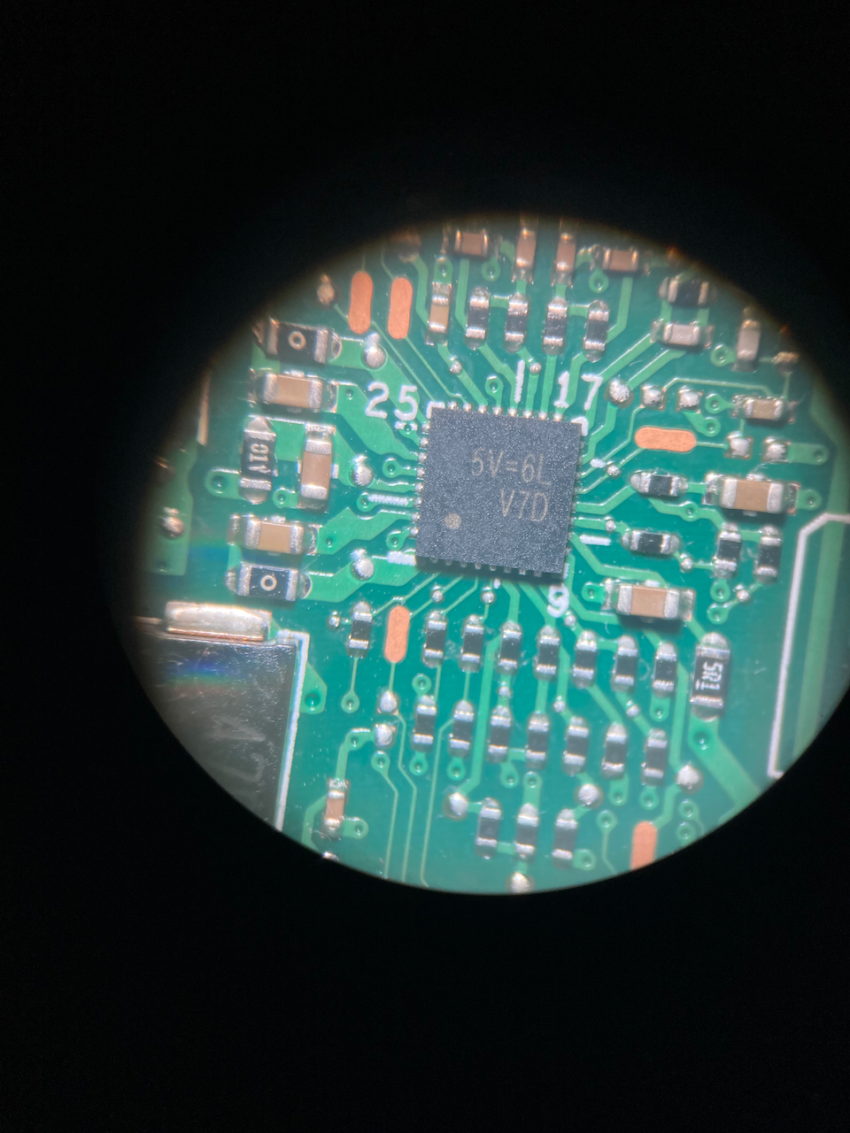

                                  hey, need help with rt ml=6l and rt 5v=6l. both cpu area. got problem with output of 1.8 v with i5 10. gen. this is way to high. no schematics. thank you all!
                                    • 21968
                                    #37
                                    Re: Richtek marking code
                                    They could be these
                                    RT6543AGQW ML=
                                    RT3612EB 5V=
                                    https://cdn.badcaps-static.com/pdfs/...ac3bbd3ad7.pdf

                                      #38
                                      Originally posted by SMDFlea
                                      They could be these
                                      RT6543AGQW ML=
                                      RT3612EB 5V=
                                      wonderful, thank u so much and happy christmas!
                                        • 21968
                                        #39
                                        Both parts are in the LA-J081P schematic,if it helps any
                                        https://www.badcaps.net/forum/showpo...26&postcount=2
                                        Happy christmas to you too
