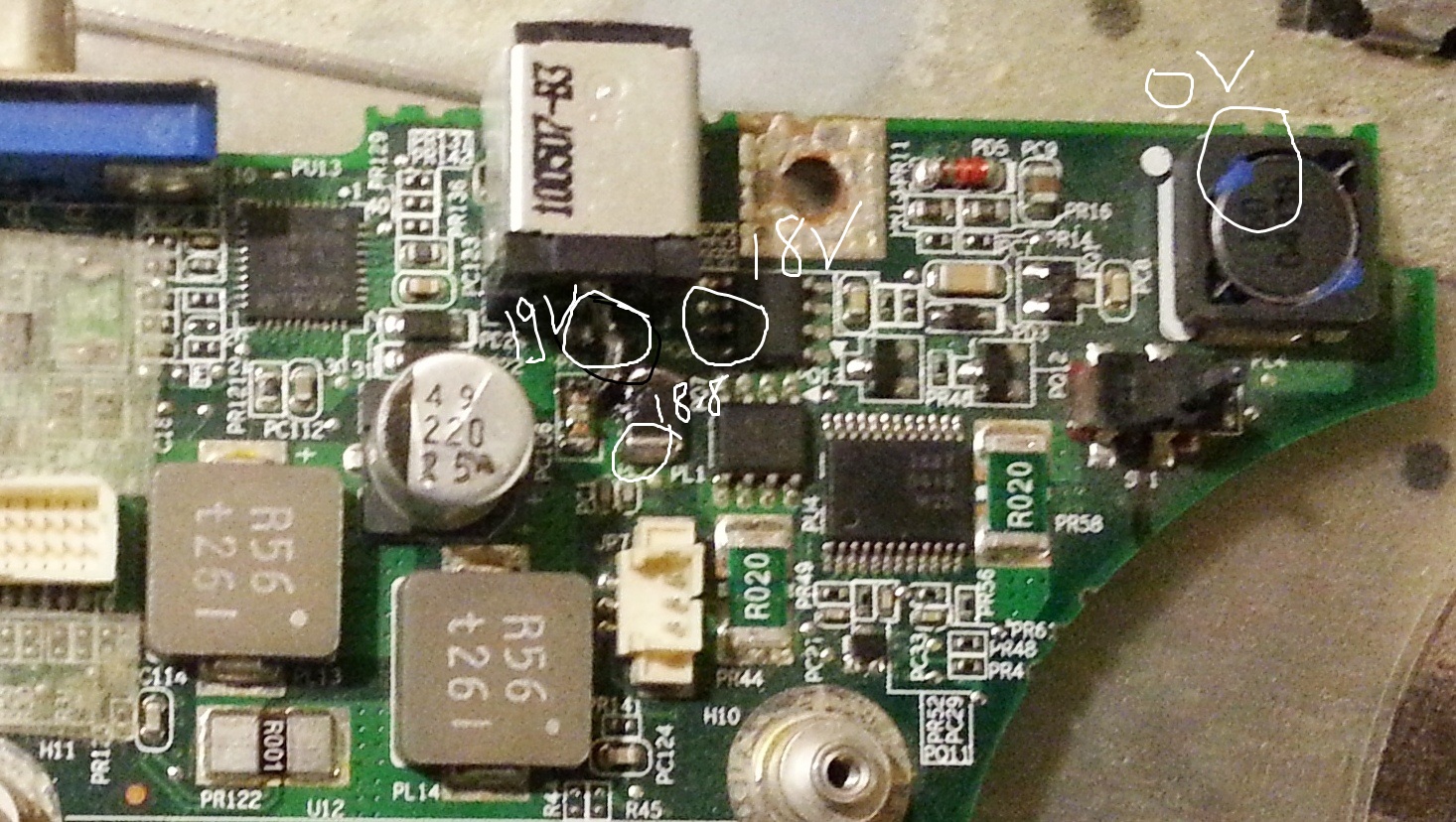

    the problem was easy the plug is damaged in the board, when i put the charger, i have to press it inside to be able to see the charging leds.
    So i disassemble it and changed the dc in jack .
    now the laptop is completely dead. i have these voltages. as shown in picture but the battery terminals have no voltage at all. note: i found the rtc battery 1.8v , so i removed it completely, in order to change it later, but is this battery must be pluged in in order to have charger working(as a reference?) thanks

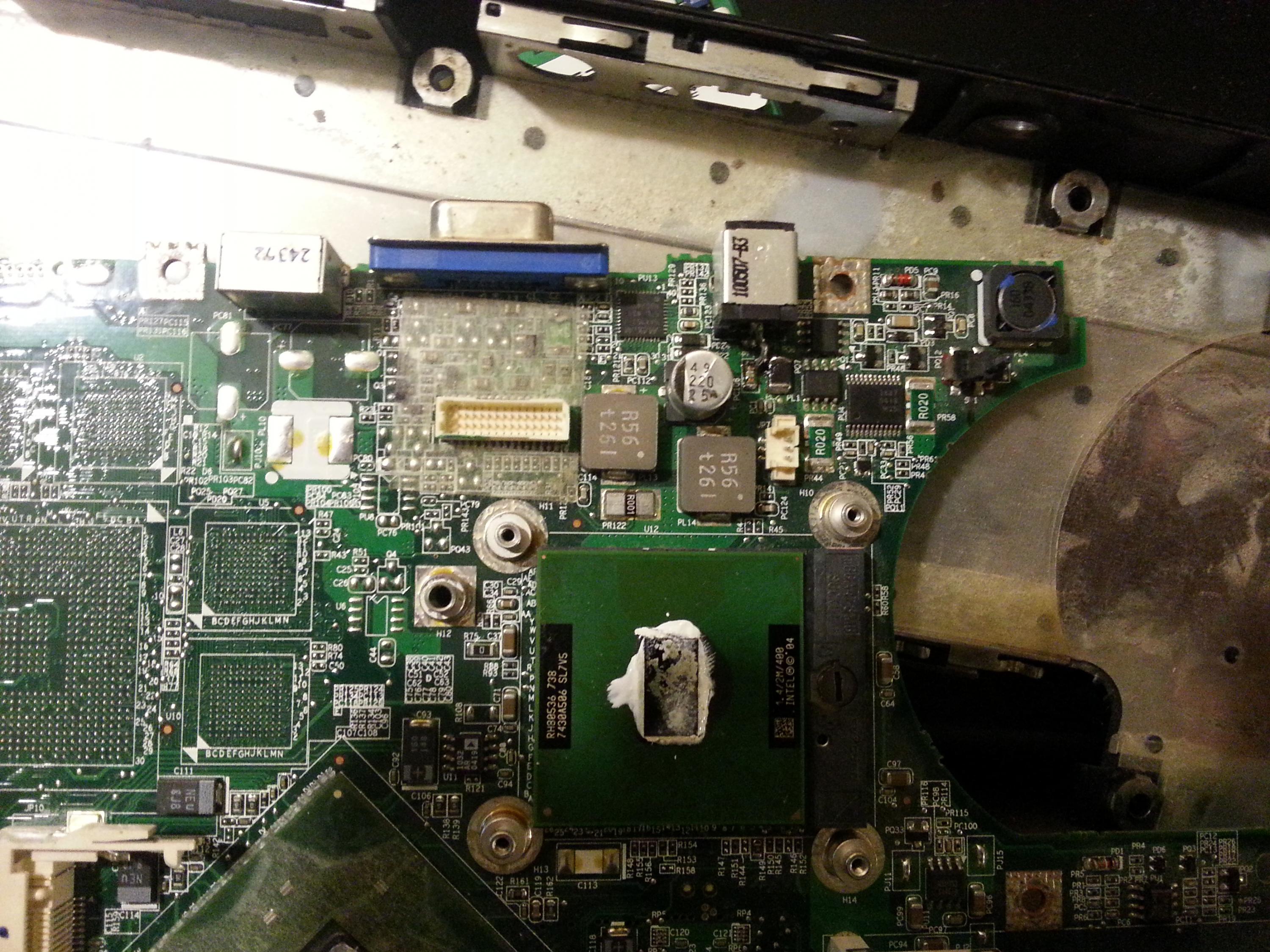

    can you make another photo?
    I think that a nokia 3310 can make a better photo

      this is a bigger photo.thanks

        looks horribly solderedd
          I think that a nokia 3310 can make a better photo;
          great help
