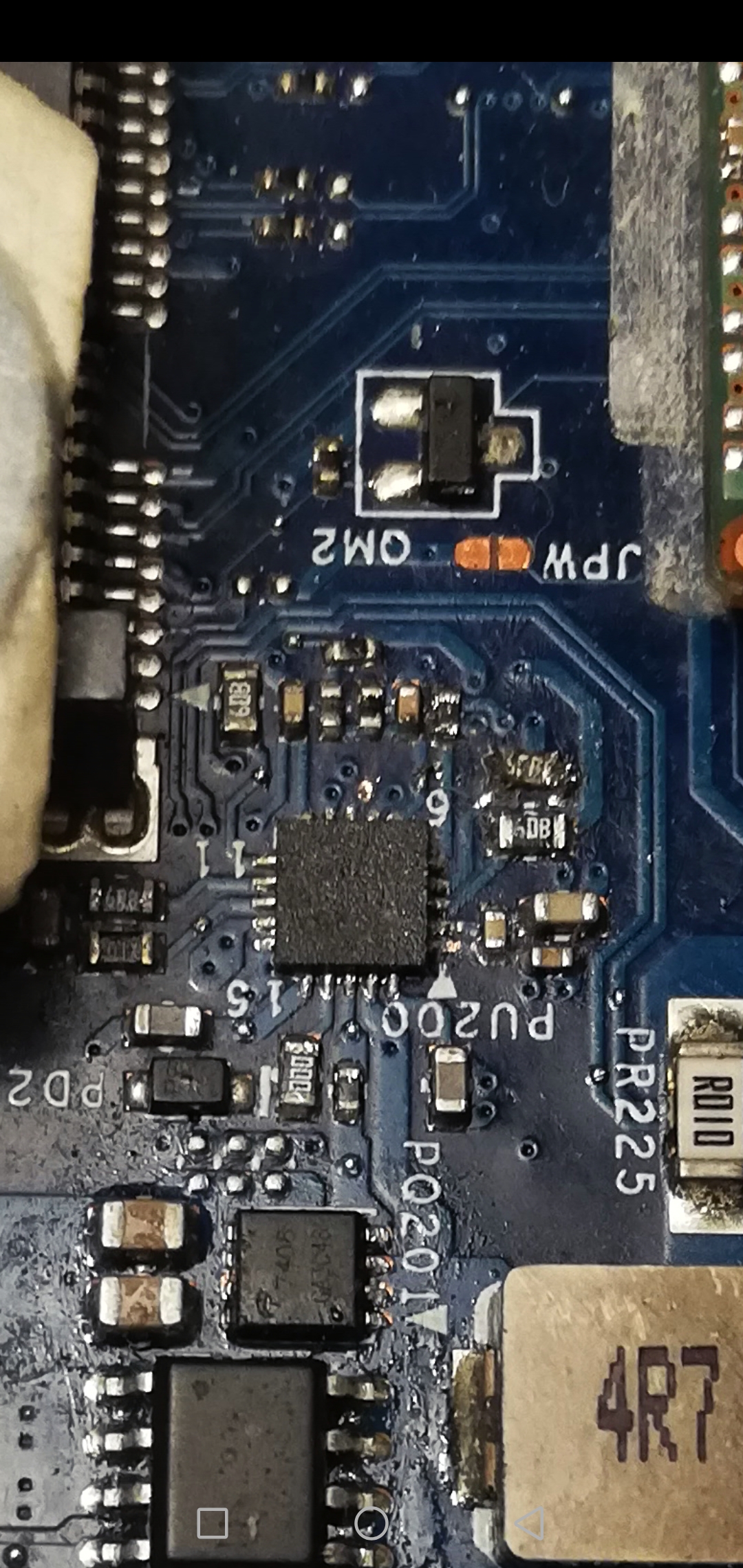

    Hi everyone,
    after a little operating time of my Toshiba laptop, ranging from about 20 to 45 minutes, the Power light goes off, the power supply switches from the charger to the battery and in fact the voltage of both gates of the 2 initial mosfets are at 0V so the 19V does not reach the PL201 inductor and the power comes only from the battery.
    However, when i close the cover to turn off the laptop, the charger starts working again, charges the battery and the Power light turns on in amber color but after about 20 minutes the charger is disabled and the power light off, in short, everything as before.
    Could it be the faulty BQ24725RGRR ?
    The charger voltages I measured when the adapter is disabled are as follows:
    1 ACN about 12.40 V
    2 ACP about 12.42 V
    4 ACDRV 0V
    16 REGN 6.08 V
    20 VCC 19.74 V
    5 ACOK 3.4 V
    on the other pins the values are
    3 = 0.08 V
    6 = 2.69 V
    7 = 0 V
    8 = 3.39 V
    9 = 3.38 V
    10 = 0.67 V
    11 = 18.52 V
    12 = 12.41 V
    13 = 12.41 V
    14 = 0 V
    15 = 0 V
    17 = 12.14 V
    18 = 12.41 V
    19 = 12.41 V
    I also thought of an overheating for which the BQ24725 charger sends 0V to the gates of the 2 initial mosfets disabling the adapter but if i remove the adapter plug and insert it quickly, then the adapter resumes giving power to the laptop but after about 20 minutes (not immediately) it turns off and switches to the battery. Same story with another adapter.
    Schematic: https://www.badcaps.net/forum/showth...914#post558914

    ACOK remains high after the power adapter is disabled so this means the charger IC is detecting the adapter OK.
    ACDRV however is not ok since it should be ~25v to keep the 2 x DCin mosfets ON.
    Often, as per @Piernov's sticky (buns) above, the 2nd mosfet is leaky.
    Remove the ~4k resistor on ACDRV and confirm if the ACDRV outputs ~25 volts which is based on power_adapter_rail + REGN voltage = 19v + 6v = 25v.

                        Re: Charger disabled after a while
                        If you are measuring 0 ohms between pins 4&5 of the charger IC then this implies you have a short between these pins.
                        Post a clear pic of this area.
                        Was a service attempt made on this logic board? Was this ic replaced already?
                          I had measured it with the analog multimeter, now with the digital one I measure 182 ohm.
                          Never service, never ic replaced
                          In the photo, the resistance that I put back looks bad but it's ok
                          • mon2
                            • Dec 2019
                            • 14095
                            The resistance between pins 4&5 should not be so low. If this logic board has not been worked on before then to me, this charger IC is defective and should be replaced.
                            Otherwise consider to apply flux onto the perimeter of this IC and reflow it with low air pressure. The solder will turn to liquid and naturally allow for the ic to return to their solder pads. This is to clean up any possible residue between pins 4 and 5.
                                Do you have a schematic of this laptop? If yes, link it here but do not post the schematic here. Post it in the schematic section only.
                                Based on the conditions, without a load on ACDRV pin, the voltage on this pin should be ~25 volts to enable the DCin mosfets. So without the 4k resistor, ACDRV should be 25v.
                                The gates of the DCin mosfets are commonly shared. Yet, you have 2 different measurements in an earlier post. Remove all power. Meter in resistance mode.
                                Check the resistance from gate pin #4 of the first mosfet to pin #4 gate pin of the 2nd mosfet. What is the resistance?
                                That is, the gate voltage should remain the same of each of the DCin mosfets unless this design is unique.
                                Next issue is the low resistance between pins 4&5 on the charger IC. Be sure there is no power and battery to the logic board when checking resistance.
                                Check the resistance across the mosfet pins:
                                Source & drain
                                Source & gate
                                Gate & drain
                                Post each measurement. Repeat for each of the DCin mosfets.
