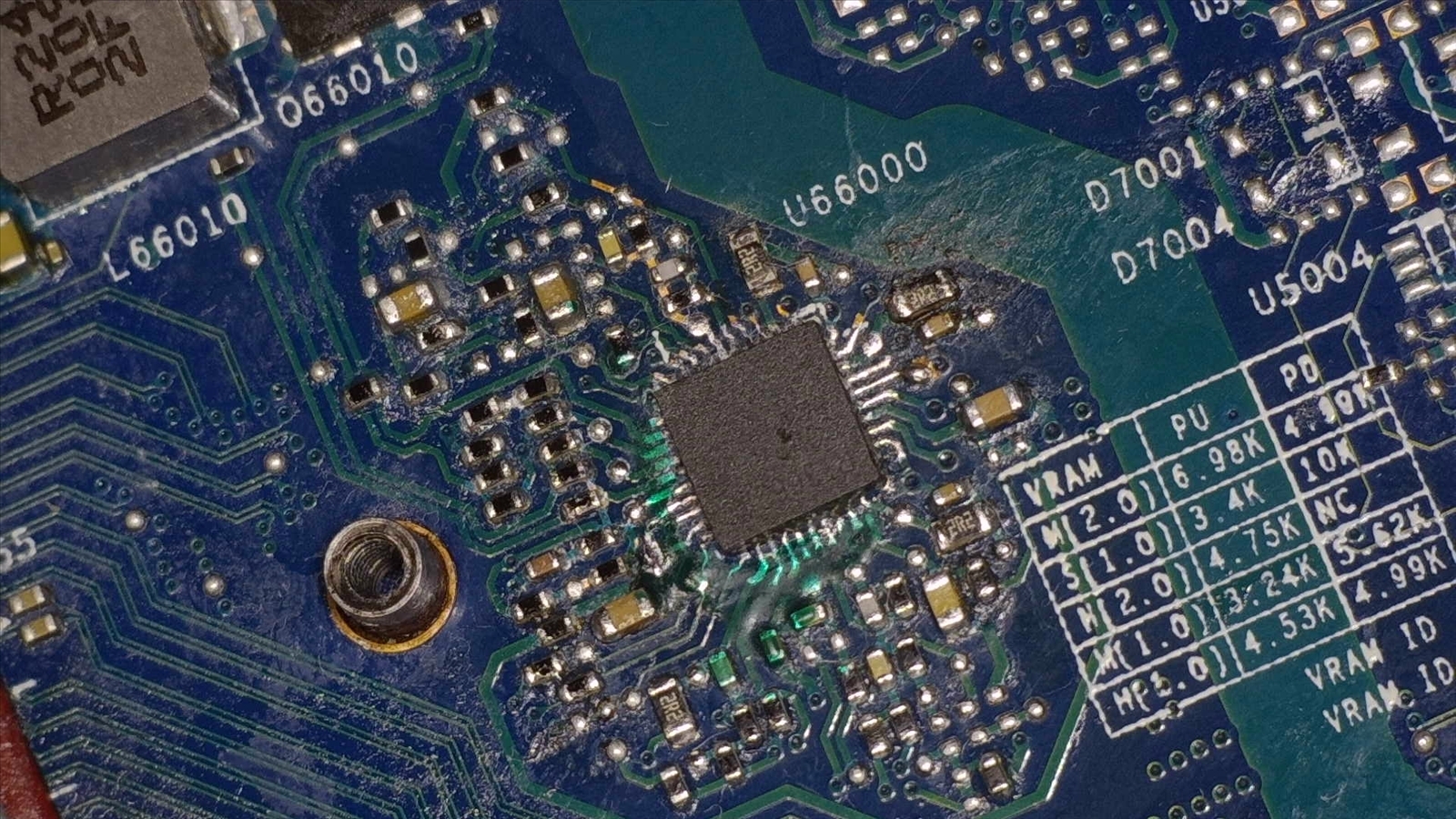

    I have this laptop HP 14-dk1003dx which has the following problem:
    Power LED and fan cycle abuut 4-5 seconds on, 2 sec off, current draw is around 20mA from bench PSU
    Board model: 6050A3176101-MB-A01, no schematics found, closest boardview is this 6050A2983601 : https://www.badcaps.net/forum/troubl...-x01-boardview
    Original fault was shorted main 19v line by mosfet Q66610, no LED at charge port, i replaced original mosfet SIZ988DT with AON6992, short no longer present, charge port LED turns white, and orange when i plug in the battery
    There was some liquid damage around U66600 RT3662AC, solder mask was darker at some places, which scraped easily, a broken trace at pin 14, which I fixed
    I replaced RT3662AC twice, the first one immediately blew Q66610, replaced both and now the issue is as described above
    Missing VCORE and VCORE_NB (controlled by Q66610), all other voltages are present
    - 5v
    - 3.3v
    - 1.8v
    - RAM voltages (1.2v, 2.5v, 0.6v)
    - 0.9v near the CPU
    Attached picture of U66600 area, i tinned those traces and applied uv solder mask where i fixed the broken trace at pin 14
    Any ideas?

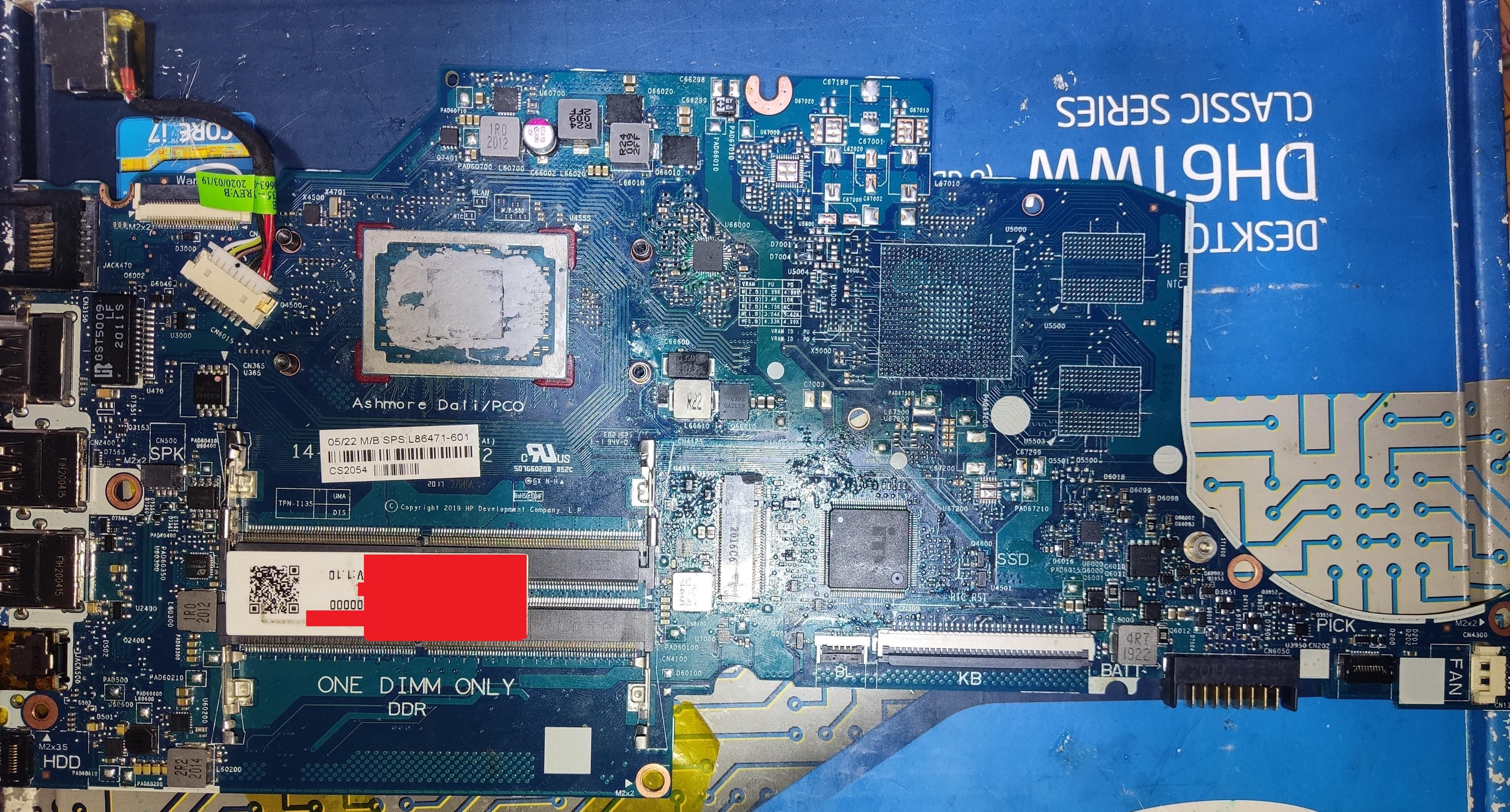

        Update: ended up replacing the board with a 19C1 Hagrid 2.0 HAGRID20-6050A3056501-MB-A01 with Ryzen 3 3200U CPU
        Everything working fine, now need to edit BIOS with serial/windows key from dead board, currently says "HP Laptop 14s-dk0xxx", BIOS was tampered with, soldering looks a bit crooked
        I can confirm boards marked "Hagrid" are interchangeable with "Ashmore", in the HP 245 G7 / 245 G8, and HP 14-dk, 14-cm, maybe other models with similar chassis
        It was listed supposedly as 6050A3176101-MB-A01 "R3-3250 R3-3200", got this one instead, Aliexpress sellers...

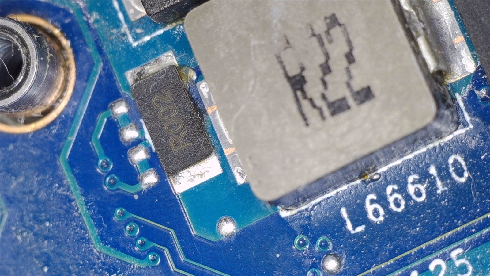

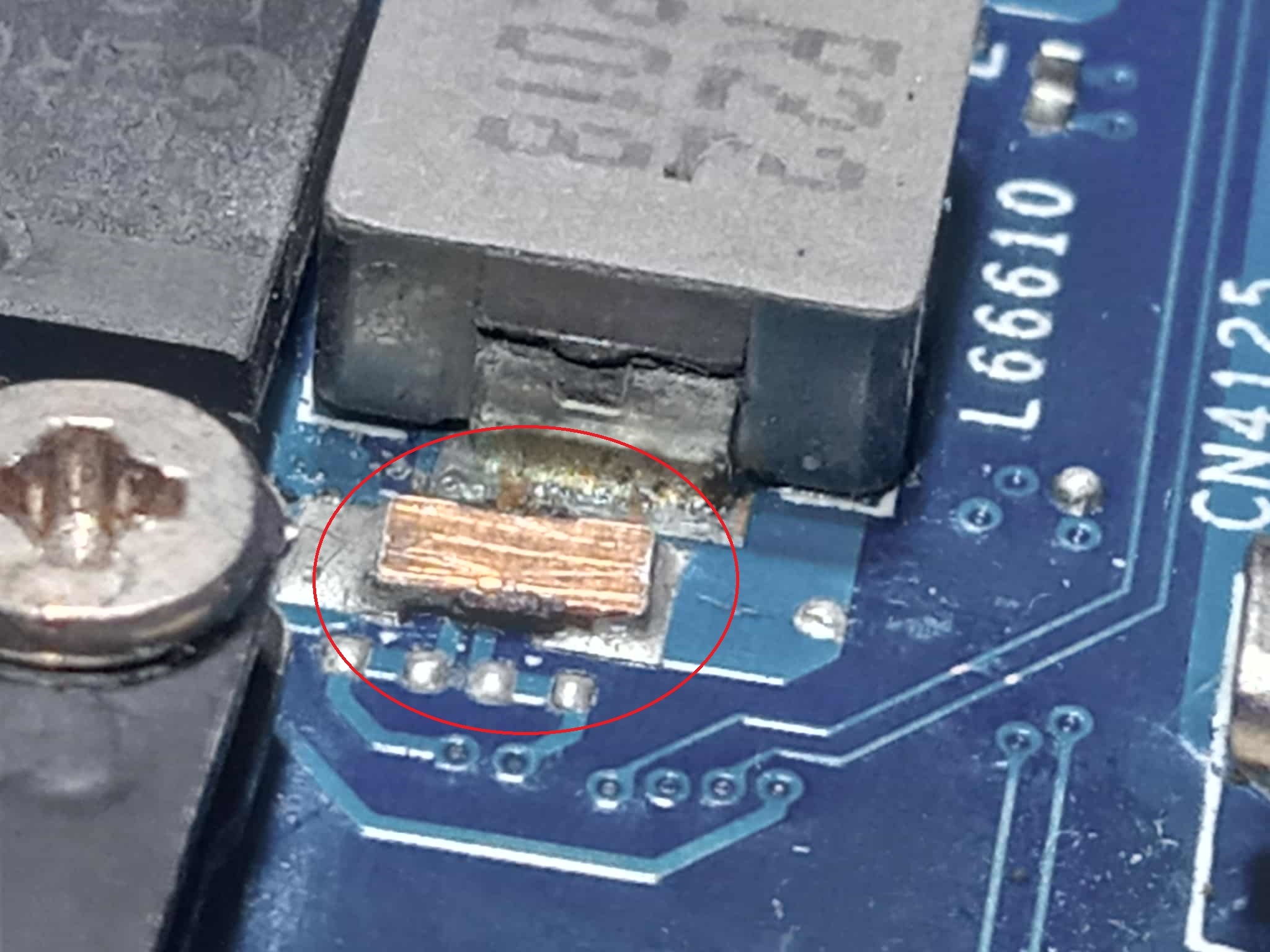

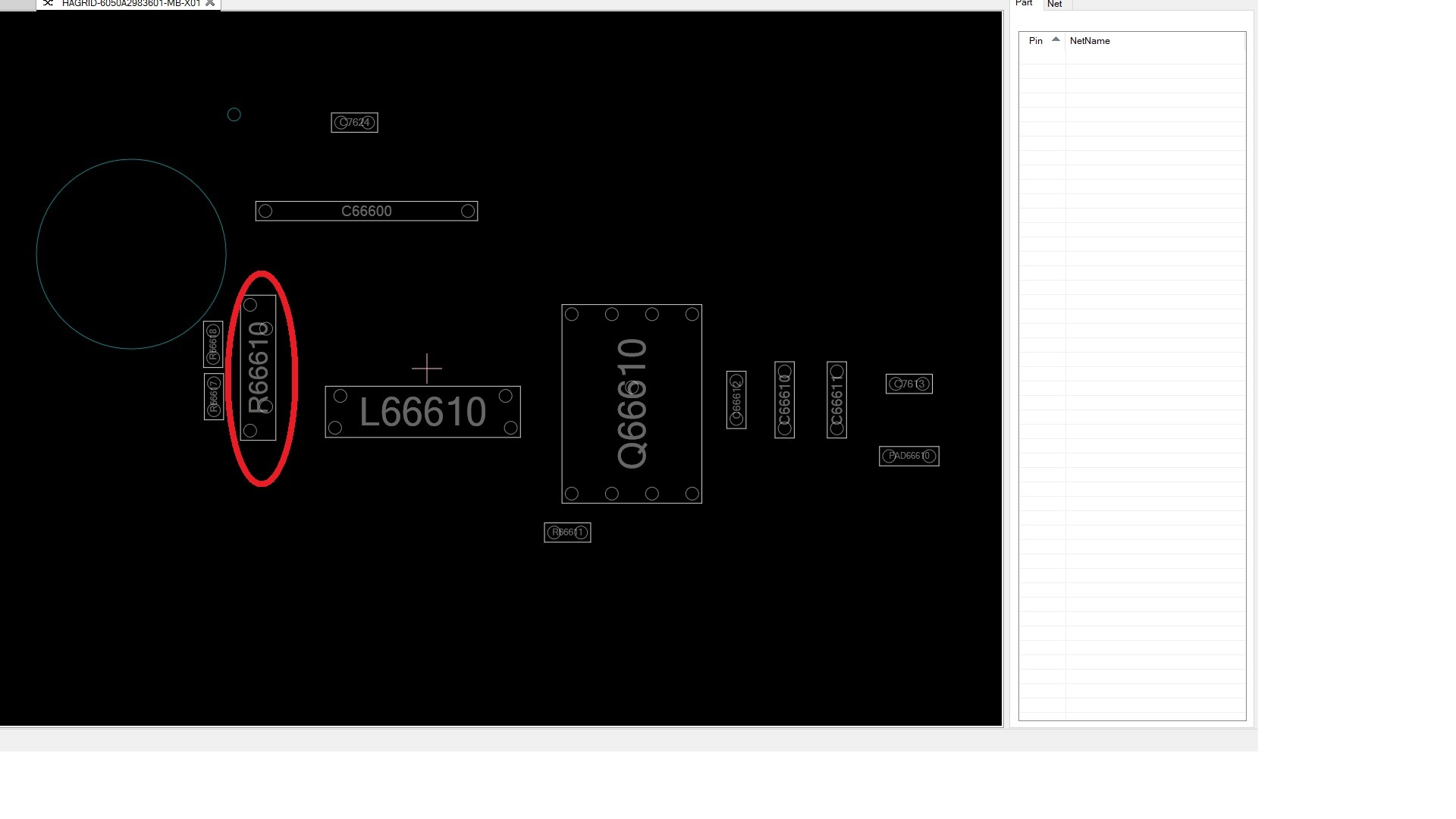

          got same unit with thermal shutdown warning issue. but it's already tampered. based on boardview at post #1 the R66610 somewhat got damaged and i don't know what the exact value or info of R66610. someone could give an ID of R66610?'
          thanks...
          • m1ch43lzm
            • Mar 2019
            • 927
            • Peru
            Hi, it's marked R002
