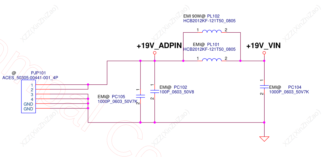

    laptop lights wont turn on, wont power on. When plugged in I get 0.4v-0.8v directly from the DC jack plug on the motherboard. 19v from the charger.
    Thank you.
  • mon2
    • Dec 2019
    • 14663
    Measure the voltage to ground on each side of the DCin power jack EMI coil(s) @ PL101 / PL102. Post each measurement. You should see 19v pass through.

      PL101: 0.4 -0.8v. All my power adapters keep tripping I think. Light blinks
      PL102 doesn't exist. Doesn't look like it's ever existed

        Remove all power / no battery.
        Meter in resistance mode. Measure the resistance to ground of PL101 - check both sides of this coil. What is the resistance? You can use a metal shield on the board for ground.

                      Ok. Locate the 2 x DCin mosfets. Still with no power -> measure the resistance to ground of each of PQ303 (5-6-7-8 = Drain pins). What is the measurement in ohms? This is the main power rail for the logic board.
                      Your issue is when you mate a working power adapter to this logic board so someone in the power path is shorted and causing the adapter voltage to tank.
                      The next step is to check the resistance across both of these mosfets as follows:
                      source (1-2-3) & drain (5-6-7-8)
                      source (1-2-3) & gate (4)
                      gate (4) & drain (5-6-7-8)
                      Post each measurement. If your meter reports 'OL' = over limit, then switch to a higher resistance scale till you have a reading. Checking for a low resistance = defective mosfet.

                          Which mosfet was measured? Each of the measurements - especially the source - gate is showing a leak.
                          If you are comfortable, flux and remove this mosfet and allow it to cool on your work table. Then measure this part again while it is on your bench. This mosfet appears to be defective.

                                  source (1-2-3) & drain (5-6-7-8) 20k - 14.40
                                  This is a low resistance for a working mosfet. This mosfet should be replaced.
                                  While this mosfet is off the board, measure the resistance to ground of the drain pins (5-6-7-8). This is to confirm that the main power rail of the board is not shorted. What is the measurement?
                                  You can either find a replacement mosfet from a donor board or order fresh compatible ones from Digikey / Mouser / Arrow and perhaps Mobile Sentrix (Toronto). Post back if you need help to locate a replacement from the stores.
