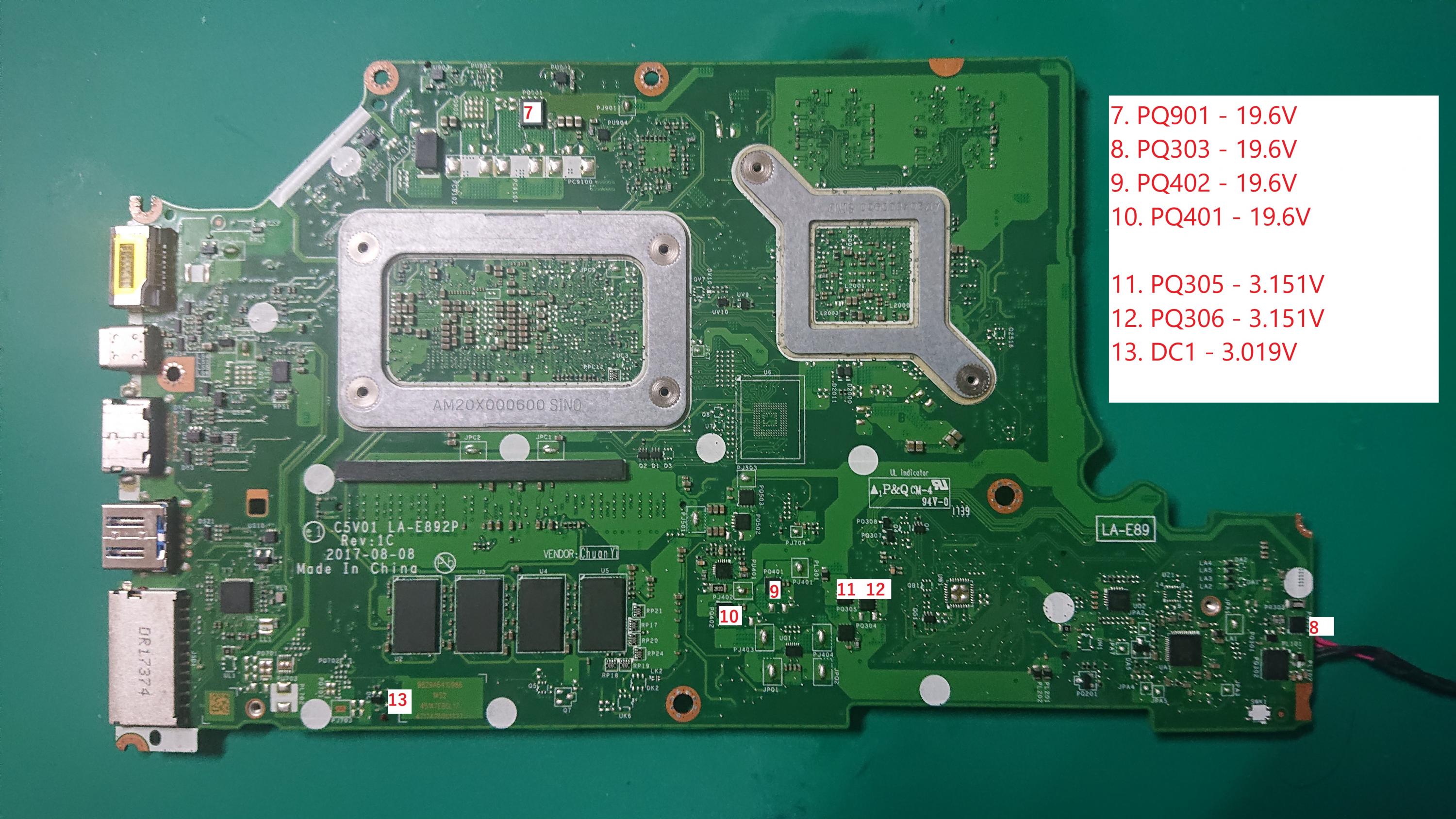

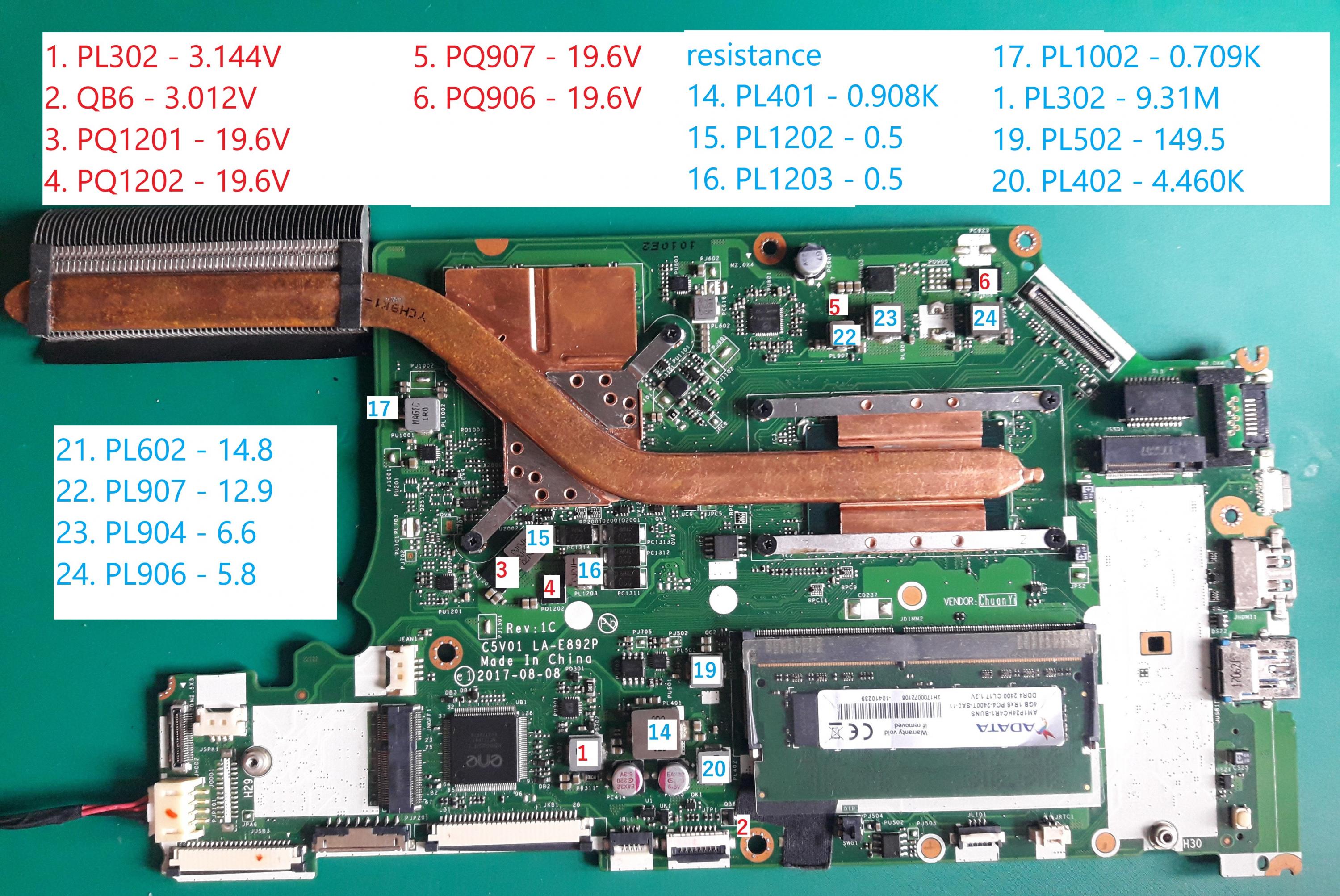

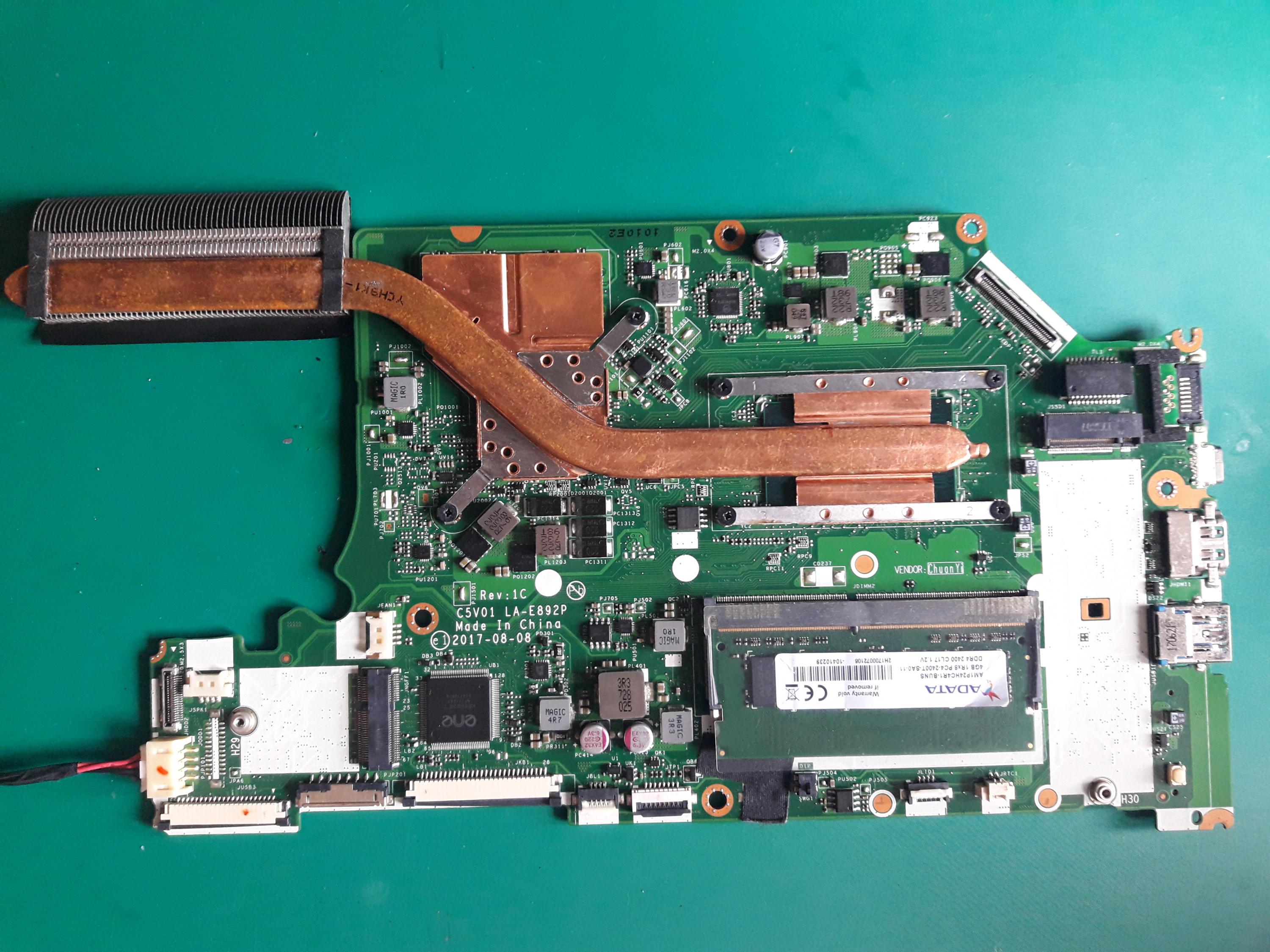

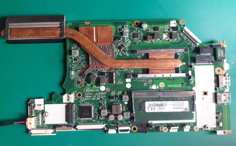

    hi everyone!,
    I'm looking for help to repair this motherboard, I followed a few threads and many youtube videos but still, I cannot figure it out
    Reason: Liquid Damage
    Model: acer aspire a515-51g
    Motherboard: C5V01 LA-E892P REV: 1A
    I already make some tests:
    ON/OFFBTN 3.2V OK
    EC_ON 3.17V
    SPOK 2.15mV
    SOC_RTCRST 3.006V
    PL401/402 no power
    PQ403 19.6V
    PU401 PIN
    6 - 0.03mV
    7 - 1.16mV
    8 - 0.11mV
    9 - 4.6V
    10 - 0.05mV
    11 - NO POWER
    EN 0.03mV
    RB 0.03mV
    DB1 (chip side(left)) 7.55mV, right 0.06mV
    I need your help.
    Thanks in advance.

        Re: acer aspire a515-51g c5v01 no power
        3V_EN_R Present?? PQ302/303 voltage on Pin1/4/8??
          Hi, thank you for your response
          3V_EN_R 0.02mV
          PQ302 PIN
          1 - 19.6V
          4 - 25.59V
          8 - 19.6V
          PQ303 PIN
          1 - 19.6V
          4 - 25.59V
          8 - 19.6V
            Probably multiple issue to solve. I'd need a overview about voltages (nothing except 19V and 3V LDO present) and especially resistances of each power rail. Check at least the coils.
            Otherwise iirc on this board 3.3V and 5V come up only after power press. So first thing you should do is to check whether the power button does indeed still work as expected.

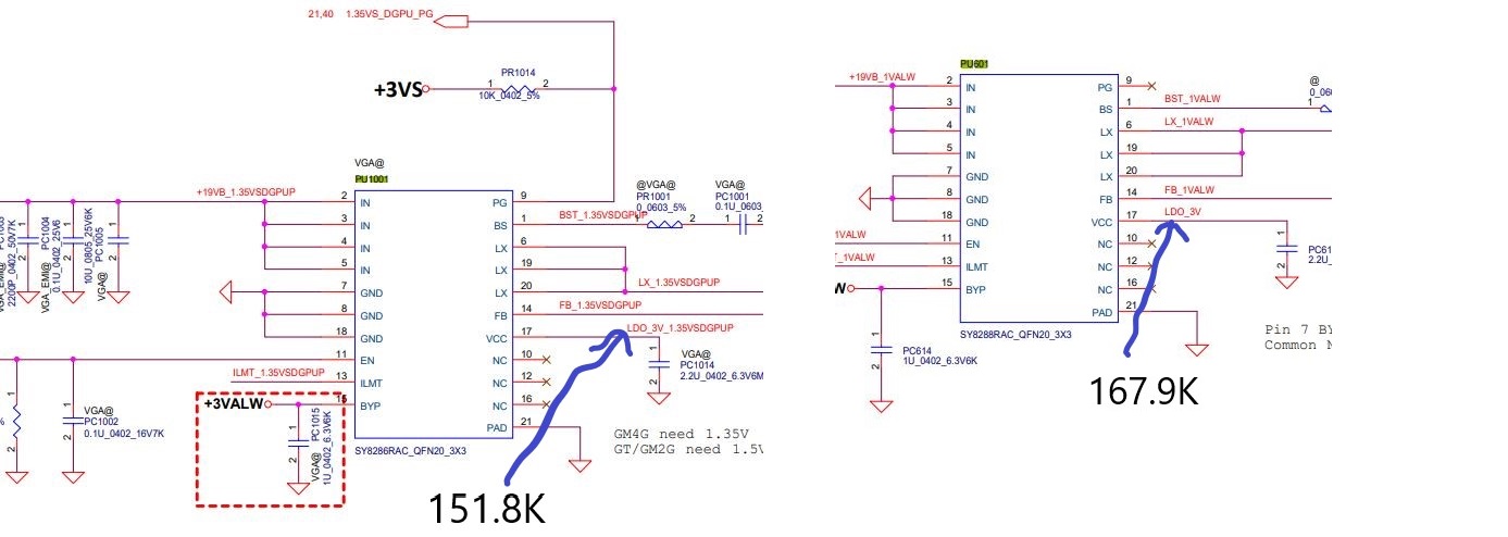

                hi I appreciate your time,
                if i update voltages on these pins PU301, PU501, PU401, is it enough for checking?
                resistance to ground 474.1k
                and sorry actually i don't know how to check the resistances of each power rail. i can check component resistances but have no idea how to check on rails. can you guide me to check that?
                • mon2
                  • Dec 2019
                  • 14657
                  Remove all power / no battery.
                  Meter in resistance mode.
                  Place one meter probe onto one side of the inductor / coil. Other meter probe to ground. Record the measurement and meter scale used for the test.
                  If the resistance is very low, the local power rail may be shorting due to a defective capacitor or another component.
                  Each coil / inductor is linked to a local power supply rail.
                  If your meter shows a '1' or 'OL' then switch to a higher resistance scale on your meter till you can measure a proper resistance value.
                      Resistance on 3V LDO??
                      • funybux
                        Akila-D
                        • Sep 2022
                        • 13
                        • Malaysia
                        hi, please check the attachment, im not sure i measured correctly.
                        • funybux
                          Akila-D
                          • Sep 2022
                          • 13
                          • Malaysia
                            Measure resistance og +3v LDO directly on PU401(PC401). Is 3v present there?? If present, remove DB1 & RB17. Now check again whether you get 3v_En_R on pin1 of RB16
                            • funybux
                              Akila-D
                              • Sep 2022
                              • 13
                              • Malaysia
                              resistance - ldo3 25.27k
                              Is 3v present there? yes
                              removed DB1 & RB17 but still 3v_En_R 0v

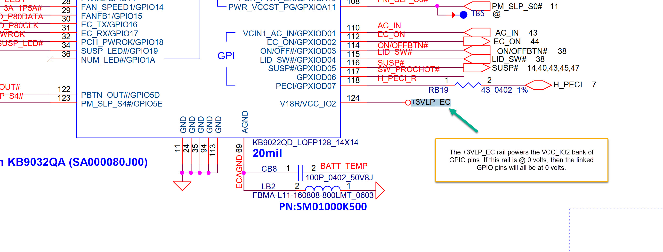

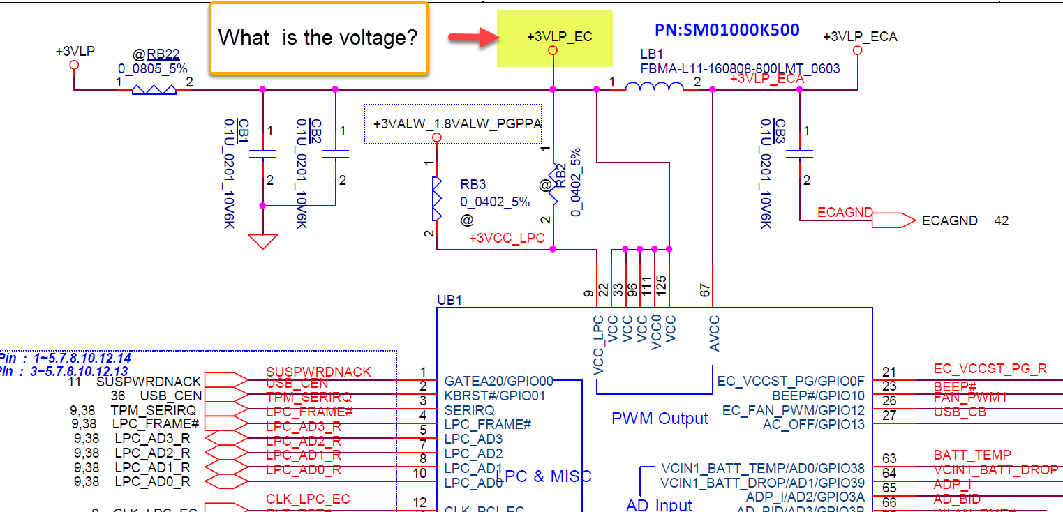

                                  3v_En_R is driven by KB9022. Confirm that UB1 is being powered.
                                  • funybux
                                    Akila-D
                                    • Sep 2022
                                    • 13
                                    • Malaysia
                                    thank you for the response.
                                    ub1 has power but +3VLP_EC is showing 0.0054v
                                    • mon2
                                      • Dec 2019
                                      • 14657
                                      Very good. LB1 must be defective. Can you check the voltage on both sides of LB1 inductor ?
                                      This not a critical part and if required, can be bridged with a piece of wire (after power is removed of course) for testing.
                                      Update:
                                      My power path flow may be in error but you are on the proper track.
                                      The +3VLP_EC has to receive power to power the GPIO pins on VCC_IO2 bank. If this rail is 0 volts, then the batch of GPIO pins on UB1 will not be powered.
                                      See attached.
