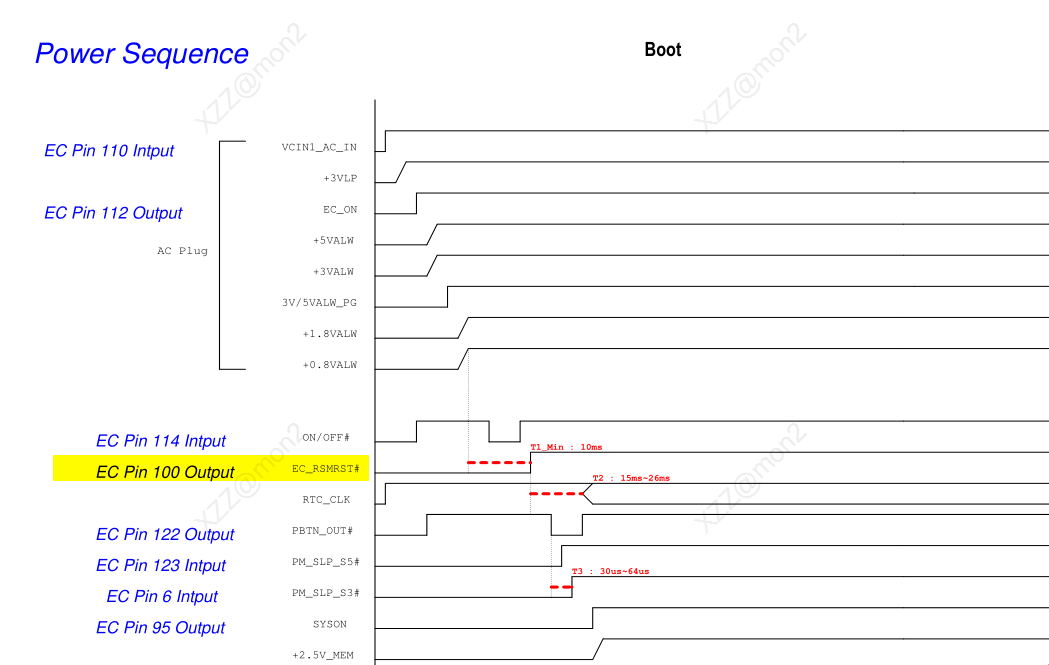

    Hi Everyone.
    Board number is: LA-L171P Rev: 1A
    This laptop came to me as faulty.
    After some measurments I have noticed that 3.3V line has 5ohms resistance. After injection, EC was lit up like a christmas tree.
    EC removed, Short is gone, and every other line shown normal resistances so I have ordered a new pre-programmed EC
    EC come and I have soldered it. (Checked pins 4 times for shorts and connections to pad)
    Now when AC plugged in, The following lines come up normal:
    + VCIN1_AC_IN = 3.3V
    +3VLP = 3.3V
    + EC_ON = 3.1V
    + 5VALW = 5.1V
    + 3VALW = 3.3V
    + 3V/5VALW_PG = 3.2v
    + 1.8VALW = 1.8V
    + 0.8VALW = 0.75V
    + ON/OFF# (3.3v and goes to 0V for a moment when power button pressed, checked on the EC pin also)
    My Problem is that EC_RSMRST# signal stay 0V never rises. (pin nr 100#)
    Resistance is 100 ohms after AC plugged in (at NO power state the resistance is 32Kohm)
    What could be a problem?
    Thanks for any help!

                Good.
                Review this boot sequence. Where does your board fail?

                  EC_RSMRST never goes high. stays at 0.005v
                  ON/OF is 3v and when power button pressed goes to 0v for a sec then back to 3v

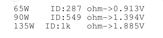

                                    What is the voltage to ground of ADP_ID? This analog voltage defines the power rating of the power adapter. If this voltage is not matching the schematic values, then the adapter will be considered to be not suitable to power the board.
                                    Is the vendor for this pre-flashed EC reliable?
                                      Click image for larger version  Name:	PS_ID.png Views:	0 Size:	18.2 KB ID:	3587461
                                      EC_SMB_CK1 = 3.2V
                                      EC_SMB_DA1= 3.2V
                                      EC_SMB_CK2 = 0V
                                      EC_SMB_DA2= 0V
                                      ADP_ID = 1.8V (135W charger correct)​
