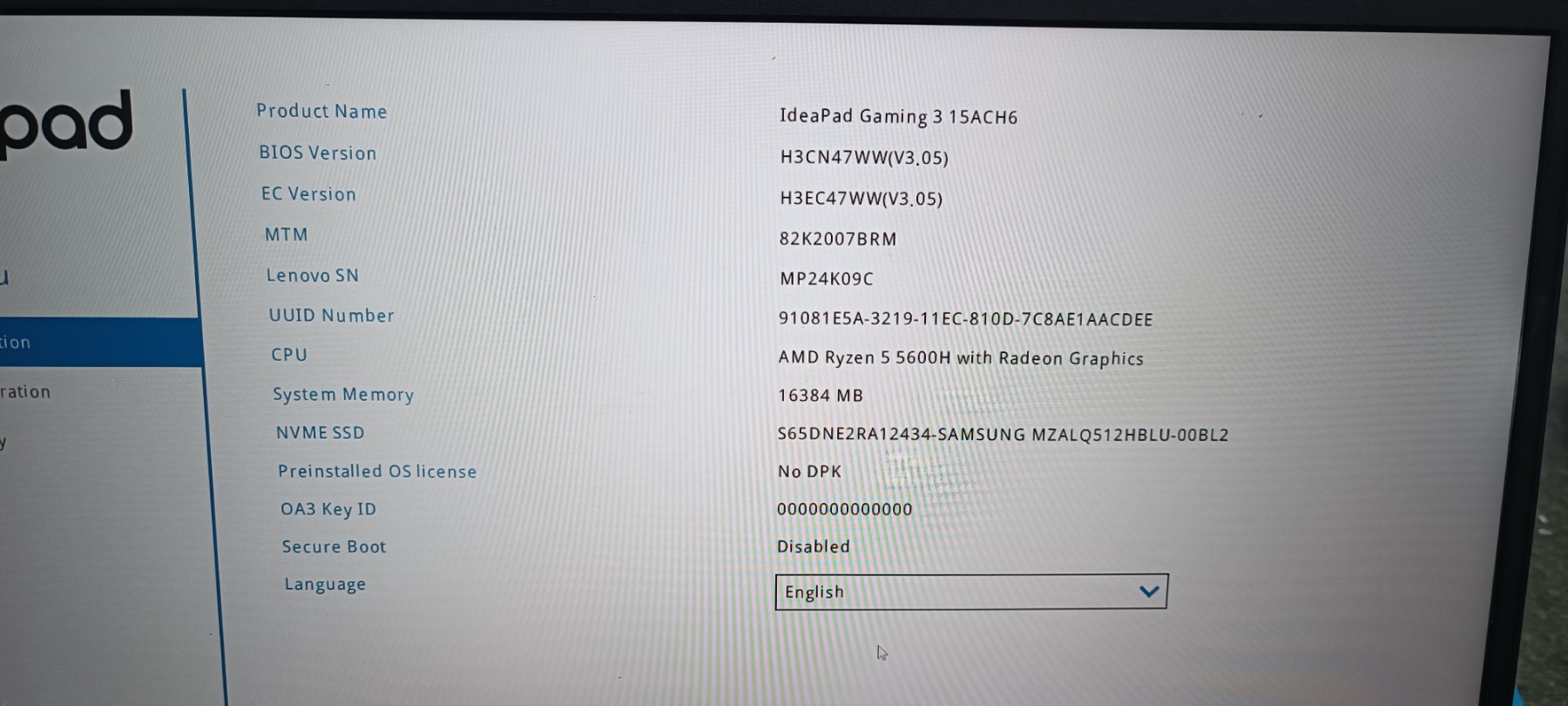

    Serial number ?

      hoaca388 Please find attached picture.

      • m1ch43lzm
        • Mar 2019
        • 2212
        • Peru
        Try EC extracted from your BIOS, it's identical to the one extracted from GOG20305B.rom from BIOS update, there's 2 EC versions packaged in BIOS update from Lenovo website
        S/N MP24K09C

          I have programed EC chip with the file "star EC ENE", and still the same problem.
          CPU fan is not working, and buttery is not detecting, also red charging light is blinking (previously was solid red light while charging). Beside these issues, laptop is booting fast into Windows.
          Any suggest for resolving this problem?
          • m1ch43lzm
            • Mar 2019
            • 2212
            • Peru
            Schematics, post 15: https://www.badcaps.net/forum/troubl...22#post3519722
            Check for shorts on EC_FAN_PWM2
            Since there's 2 versions of EC firmware for this laptop model, i attach the other version
