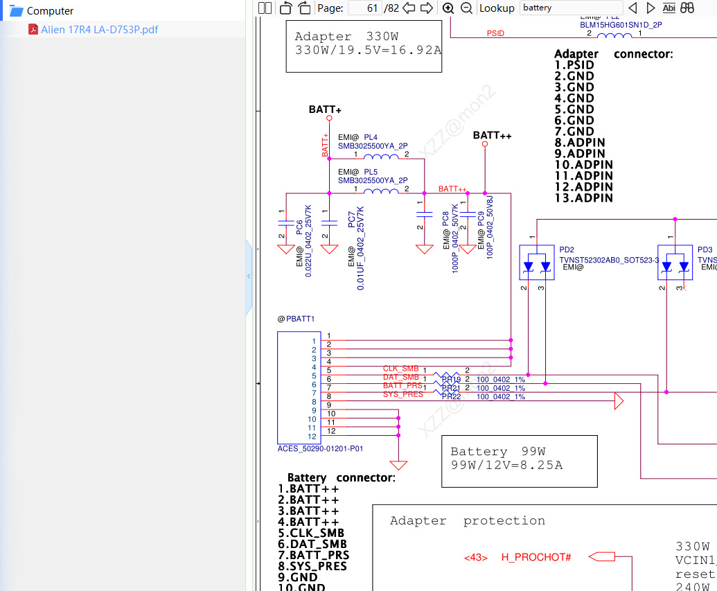

    I am chasing the battery connector for the board, I think it's a female 10 pin connector but I cannot be sure and I really need one - any ideas where I can find them that aren't part pulls from donor boards? I just don't want to have to buy a board for this job.

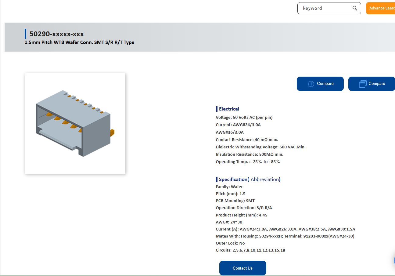

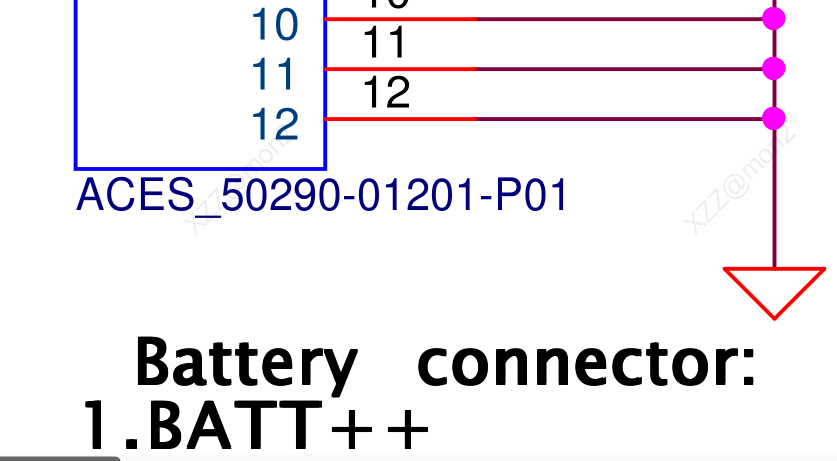

    See attached.
    part # ACES_50290-01201-P01
    Vendor is ACES
    https://www.acesconn.com/series/50290-xxxxx-xxx/2809
    PS: The website is a bit ghetto and shared a broken URL. Have reported to the mfr for correction. Regardless, this part is very common to other vendors. Will post the full datasheet once the mfr replies back for this exact part.
    This part should be available from many others. Post a clear pic of the location on your board that makes use of this connector.

        Full datasheet is attached (thanks to Aces for the support):
