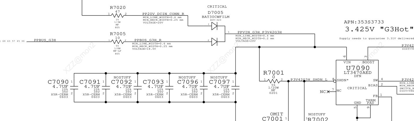

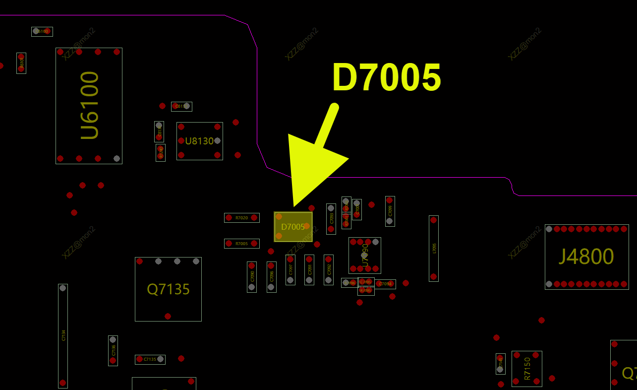

        See attached. Review D7005 = dual, common cathode diode.
        Remove all power. Disconnect the battery. Disconnect the power adapter.
        Meter in DIODE mode.
        Place the red meter lead onto pin #1 of this diode (anode); black meter lead onto pin #3. Meter should conduct.
        Reverse the meter leads and the meter should now block (OL).
        Repeat with pins #2 and #3. Post each measurement.

                mon2 Hi, finally i got time to work on this board. just to be clear i'm still learning things and i'm not a pro in here. can you please tell me which chip i have to test. Thank youClick image for larger version
                THank you
