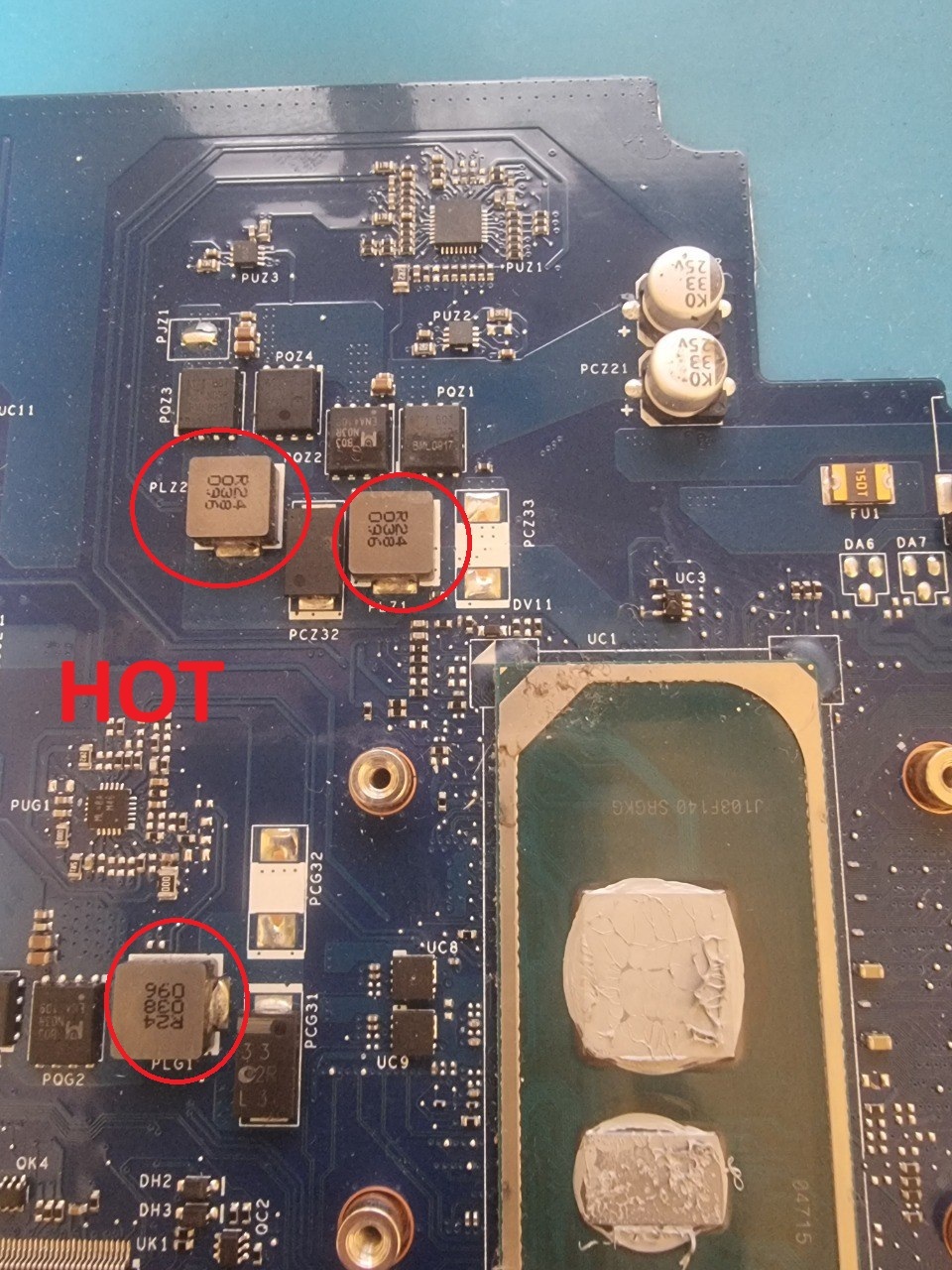

    Hi.
    I got HP 250 G8 which has blinking Caps Lock - 5 long, 3 short - This condition indicates the embedded controller cannot reach the BIOS within the established time limit.
    When I got the laptop, it did not turn on at all. The power button was dirty. After cleaning the button it stops at blinging Caps Lock.
    When I power on the board, I get a fan spin at the start, then it stops. Then the CPU and inductors get really hot. The fan does not turn on for cooling.

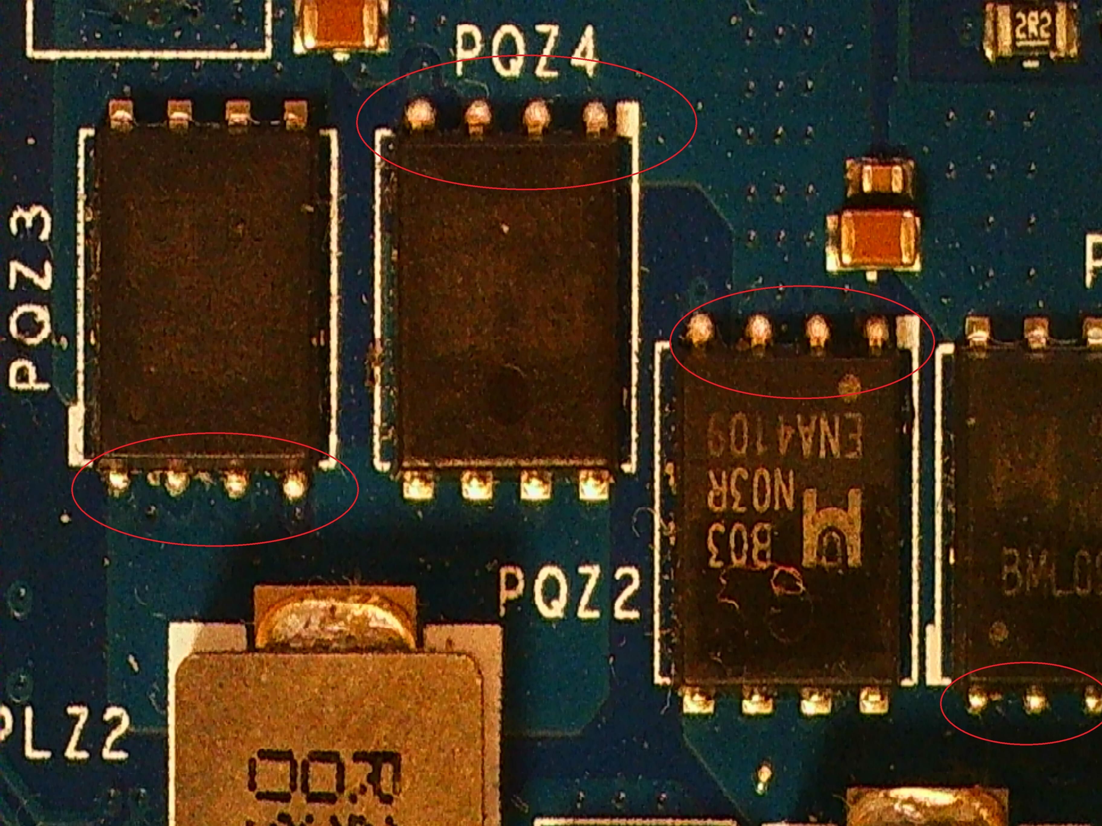

    Then I notices that MOSFETs have a solder balls on the pins, like they got really hot as well (but I couldn`t feel by hand).
    Could it be a bad CPU drawing too much current?
    Where do I start to look?
    Thank you.

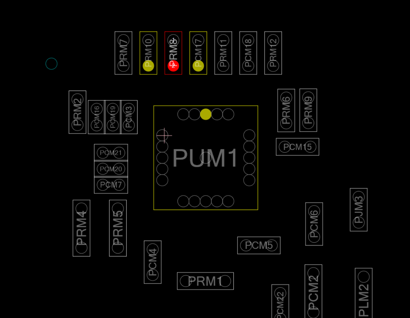

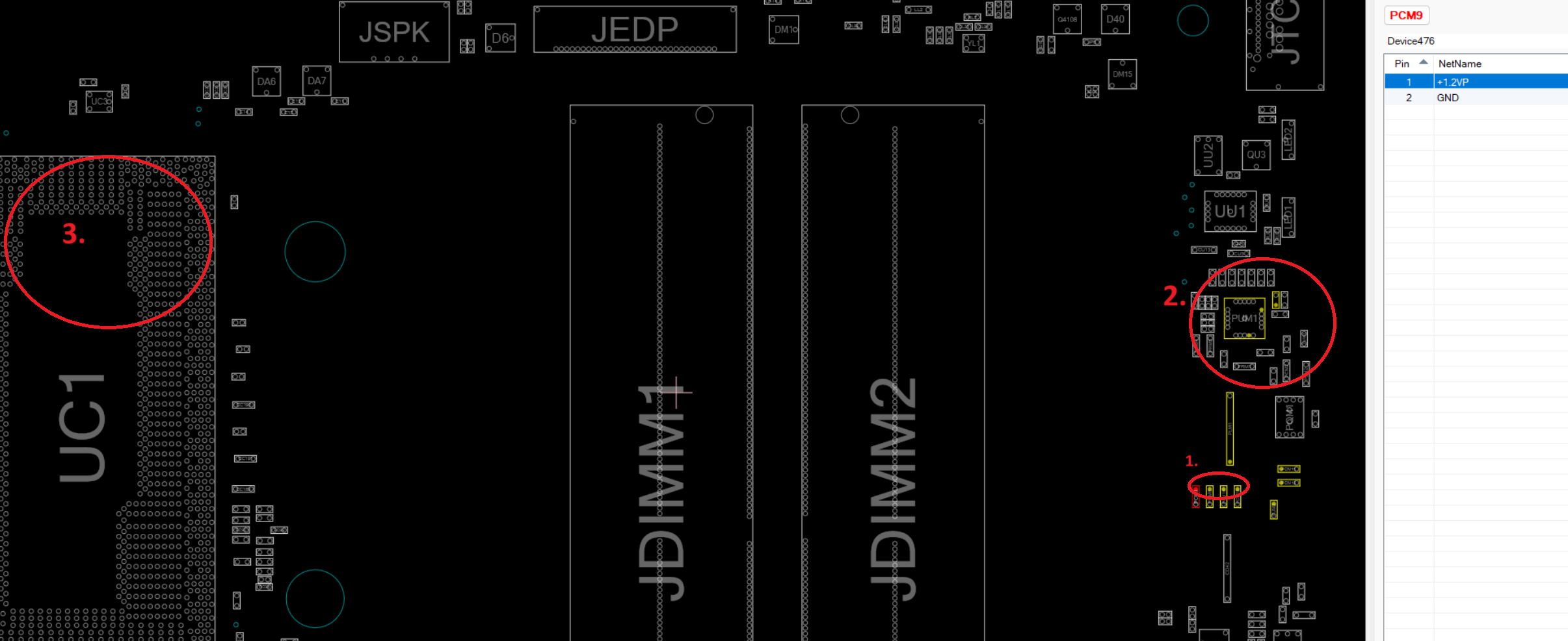

                              PLT_RST to ground - 70k Ohm
                              Today I went through the voltages again and I noticed the board was missing 1.2V.
                              Then I found that there was a short on 1.2V line (0.0 Ohm).
                              Click image for larger version  Name:	HP_250_G8.png Views:	0 Size:	519.5 KB ID:	3581614
                              1. Where I noticed the short.
                              2. I removed the PUM1 controller and short was still there.
                              3. I injected 1V2A into the short and the part of the CPU circled in picture got warm.
                              Also, I was making measurements on PUM1 controller, and noticed, that when I was measuring voltage on PIN8, there would be a clicking/sparking (like a relay) sound coming from CPU. It measured 3.0V. In BoardView there should be resistors and capacitator connecting to SYSON, PG_2.5V and GND, but on board they are unpopulated.
                              Click image for larger version  Name:	HP_250_G8_clicking_sparking.png Views:	0 Size:	186.2 KB ID:	3581615
                              Could the CPU be bad?

                                You had SYS_PWROK - 3.3v in post 12, so at that time your 1.2v must be ok.
                                Do you loose SYs_PWROK now?
                                It's 0 Ohm résistance they often Forget thoses résistances and just jump the tracks. Just look Closer you Will see continuity.
                                1.2v Line is used to power ram, try to remove ram and measure again.
                                You can try to open PJM2 and Check if short is still présent on both side of jump PJM2.
                                If short is gone try mcplslg123​ suggestion, that really make sense With your problem.

                                  The SYS_PWROK still has 3.3V present, but 1.2V line is still shorted.
                                  I opened PJM2 jumper, and short was gone from PUM1 controller, but still present going to RAM slots and CPU.
                                  I inspected RAM slots and everything seemed fine. But I did resolder all the PINs. Still shorted.

                                    I guess cpu is dead or balls are shorted…
                                    Last chance if you are lucky and have Good ultrasonic machine: you can try to clean the board.
                                    • mcplslg123
                                      • Jun 2015
                                      • 7262
                                      • india
                                      If the short on 1.2V line is on consumer side, CPU is for replacement for sure.
