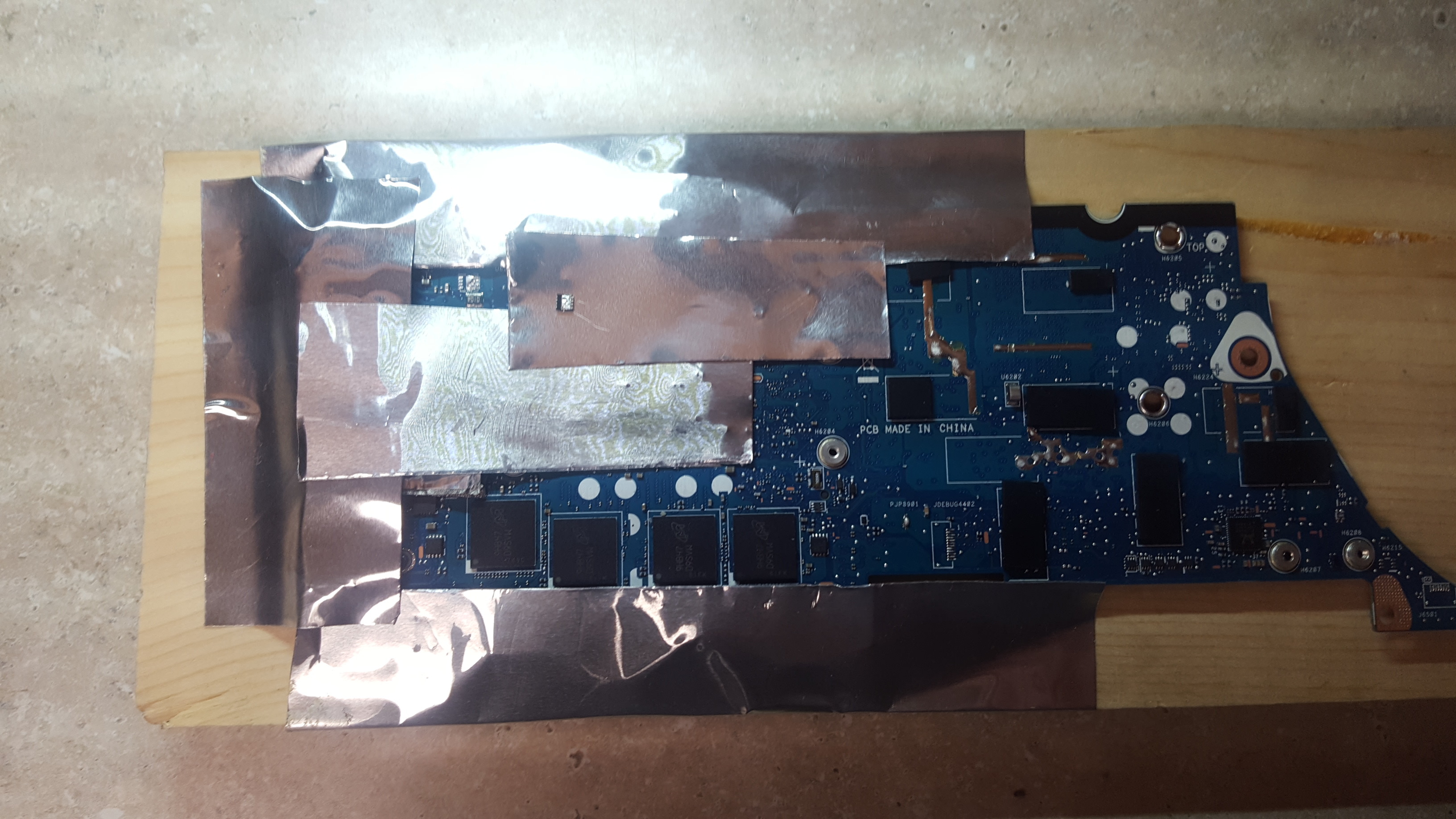

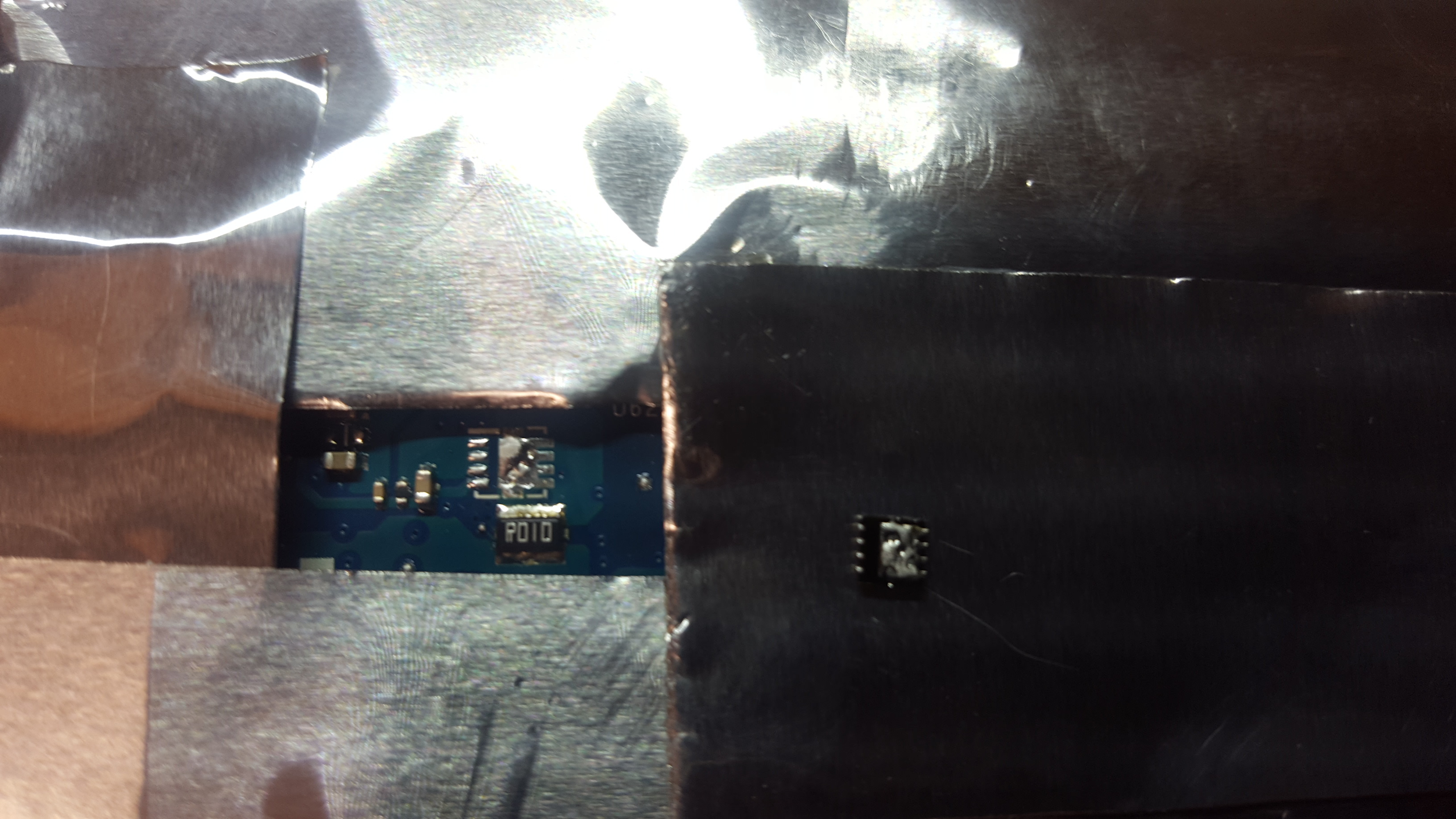

    Took literally 5 seconds to get the mosfet removed, my 1st time using the hot air rework station and it was most pleasant experience ever. 380C @ 60L/min with a dab of flux. Didn't have Kapton tape but had plenty of aluminum tape to dissipate heat. Worked like a charm!

      Very nice. Now flux and solder coat that region with leaded wire solder and remove access with desolder braid. This coating will make soldering back a fresh mosfet easier due to the low temp solder. For the desolder braid, we use a high temp pencil soldering iron from Weller with a blade tip. Ample heat to make the solder turn to liquid state. The PCB has multiple layers so acts like a heatsink and the braid can get stuck to the board if your soldering iron is not hot enough.

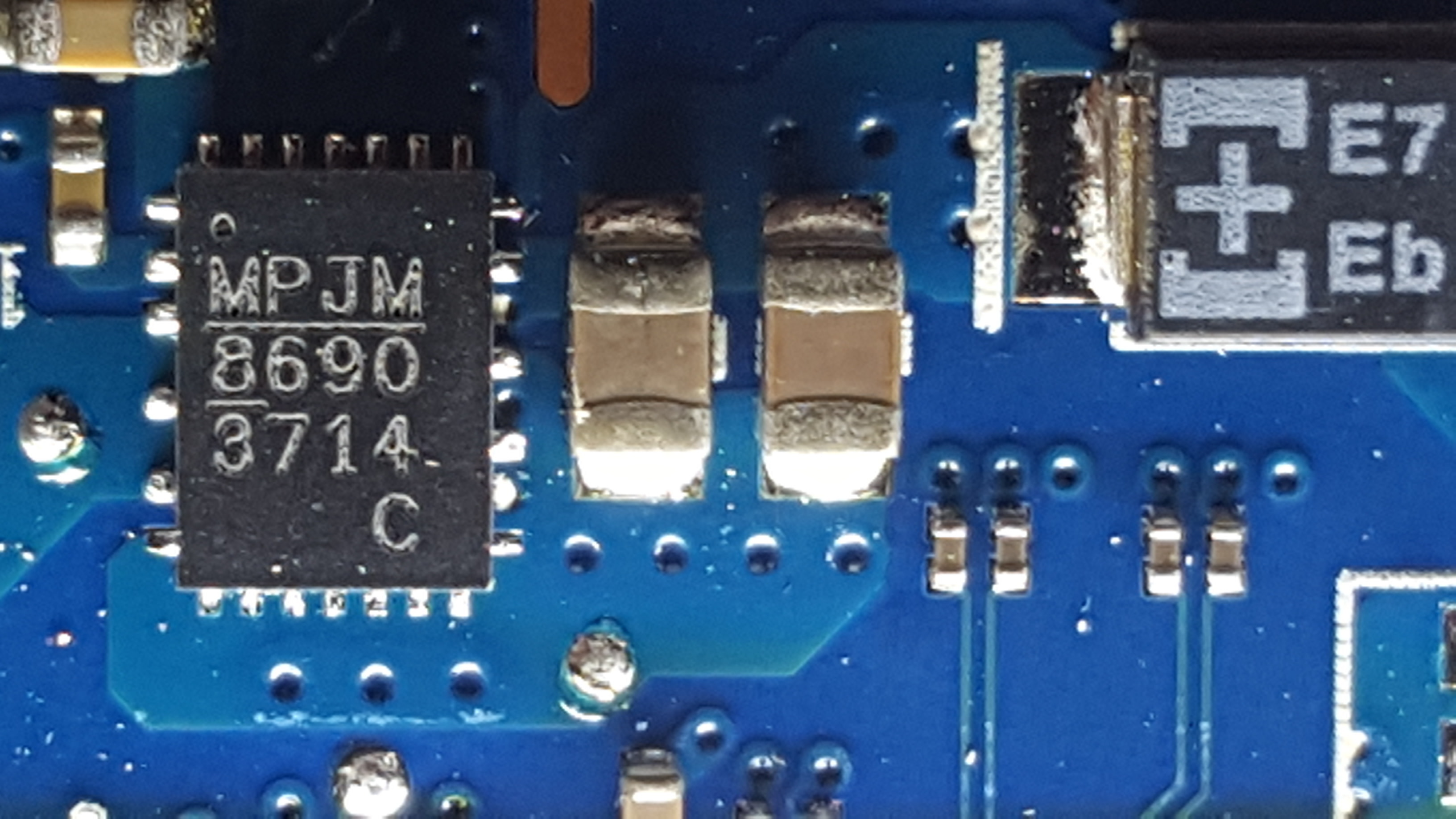

        With the 2nd mosfet removed, the values of the 1st mosfet (M3056M) from the front side of the MB are as follows:
        Source <> drain = 5.88 Mega Ω
        Source <> gate = 4.6 Mega Ω
        Drain <> gate = 1.34 Mega Ω
        Those values look great to me, what do you guys think?
        Edit: measuring the removed mosfet shows same low resistance values
        • mon2
          • Dec 2019
          • 14672
          Perfect. Replace the defective mosfet.

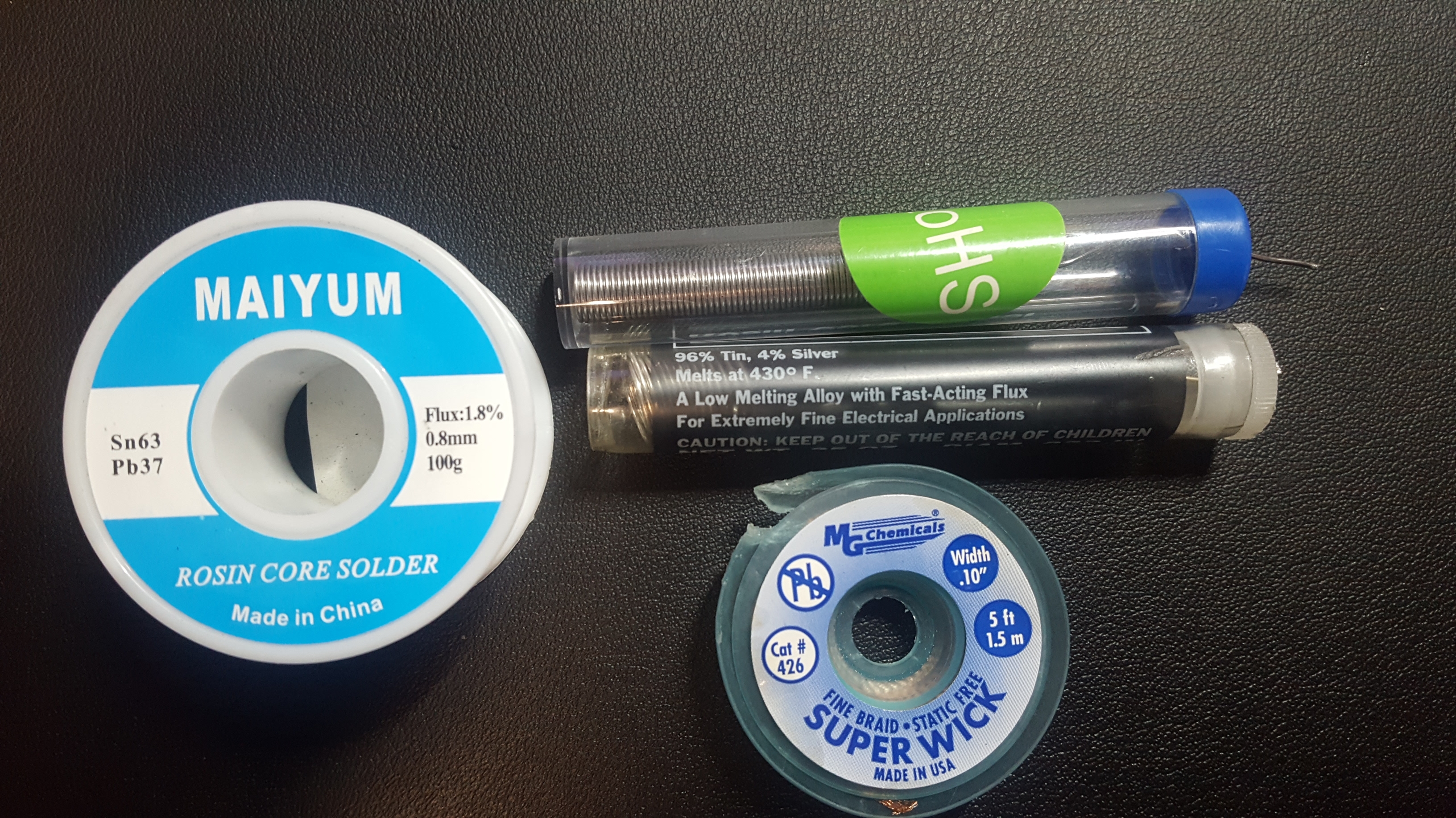

              This is the best I have on hand, some super wick and 3 solder wires:
              The no name brand (blue cap RoHS tag): According to the MFG tag its 99.5% Sn and 0.1% Lead
              Gray Craftsman Lead Free Rosin Core is Low Melting Aloy 96% Tin and 4% Silver
              The roll of Maiyum Rosin Core solder is 63% Sn and 37% Lead
              What would you recommend out of the 3 options I have?

                Suggest to use 60/40 leaded solder, not lead free solder for rework. Then you will have a lower temp to melt the 60/40 solder.
                We buy this stuff in bulk from Amazon:
                https://www.amazon.ca/Austor-Activit...s%2C87&sr=8-11
                Guessing you will have something similar. Lead free solder will eat away at your solder tips.
                Desolder braid is fine.
                Let me check the mosfet options and post back. I believe that I linked a few good ones from DK already from Alpha Omega. You do have the metal bottom pads so this is ok for the replacement as well.

                      Cheap leaded solder from Aliexpress generally performs worse than lead-free solder. Really suggest sourcing a good spool locally. At the very least check how both flow on another PCB with low iron temperature, but I wouldn't trust that to make good solder joints.

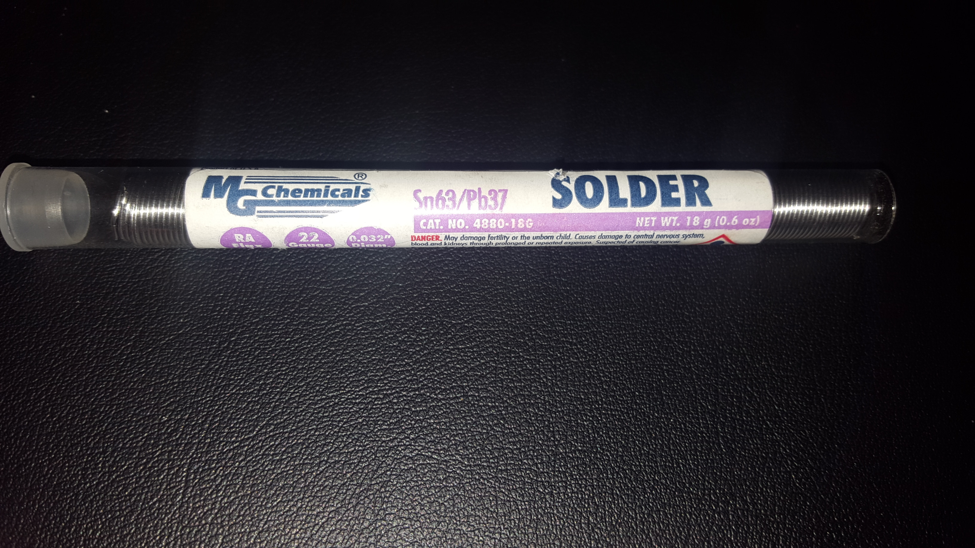

                          Found a good one today, non Aliexpress brand.

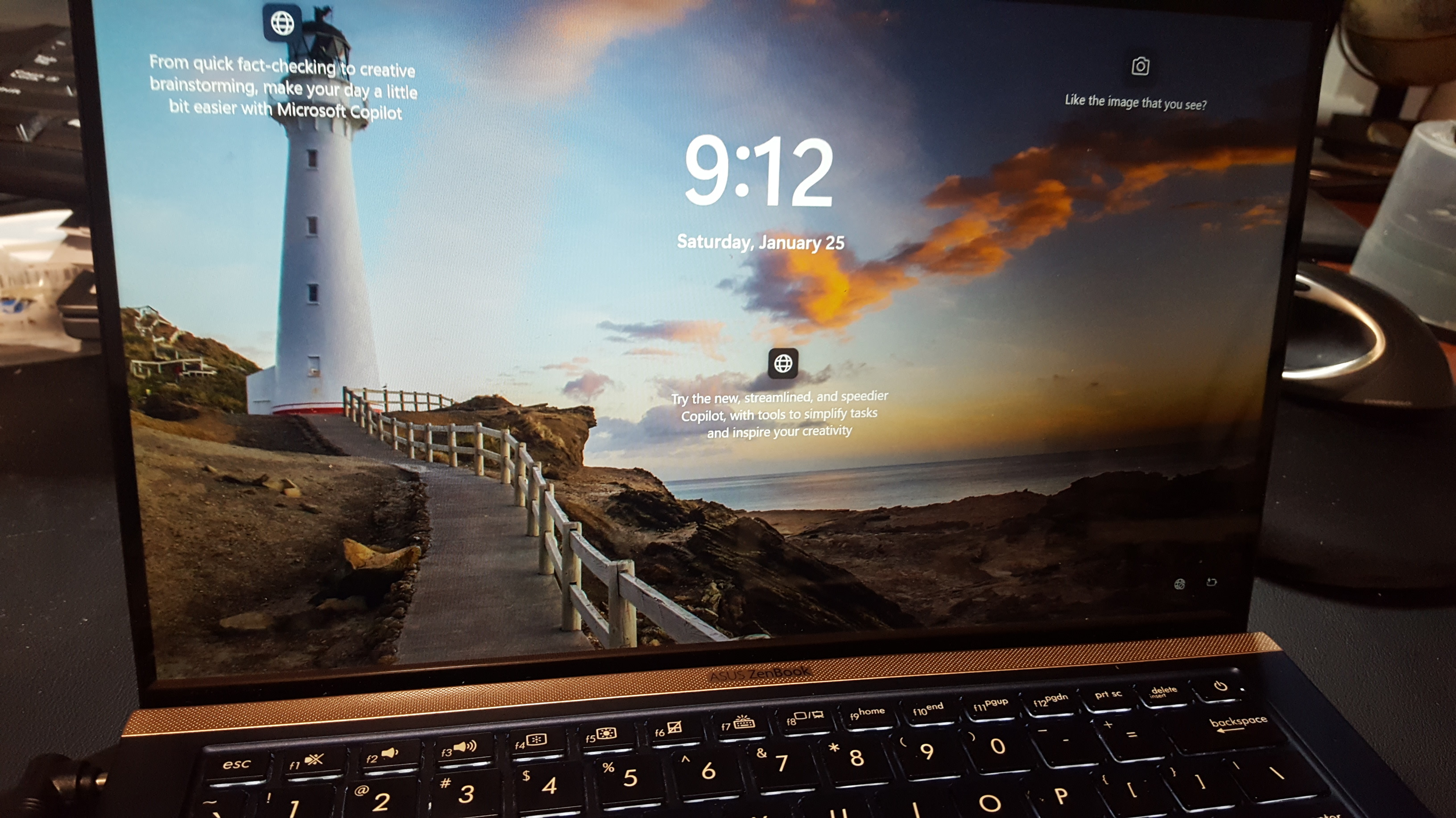

                                I received Digikey delivery today on the two AON7528 mosfets, at 1st glance the new mosfets were larger than original, but they were still able to fit on the board. I got it soldered in with hot air station no problem, bit crooked.
                                Assembled the laptop and we have picture, that's crazy!
                                Battery is charging, orange light is on and everything seems to work.
                                I'll take it apparat again and show my 1st mosfet install ever, not the cleanest..

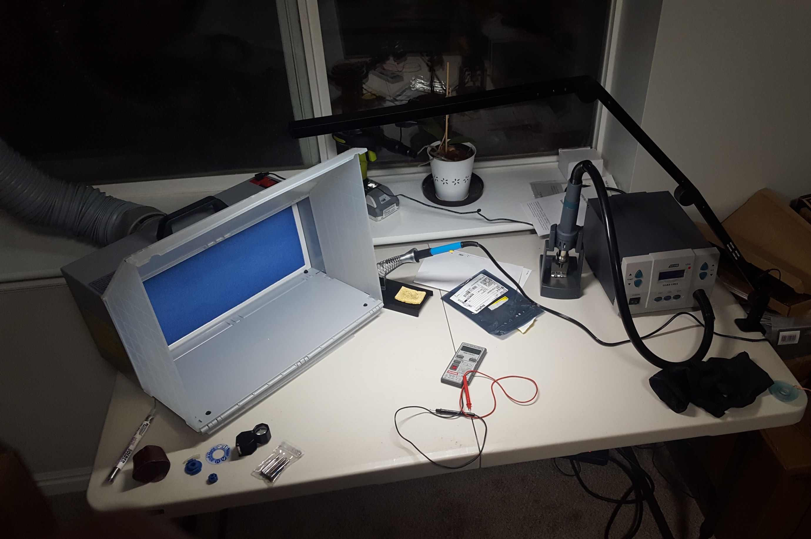

                                  Here was my makeshift setup for the day
