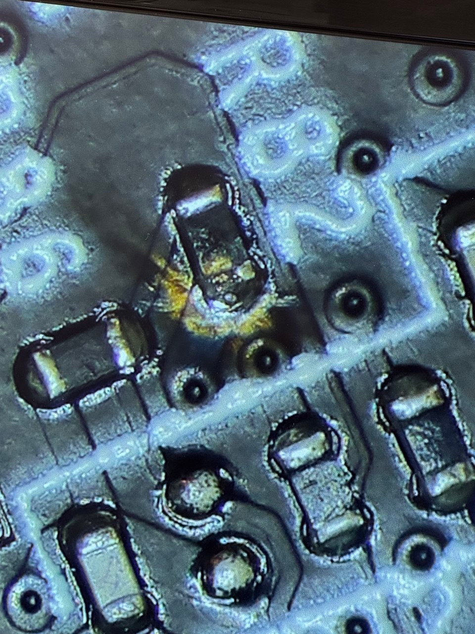

                  NVVDDS_PWRGD 19.12v HOLY S... found the issue right here, just because i was measuring the wrong IC, and i've found R82 completely burnt Here photo:

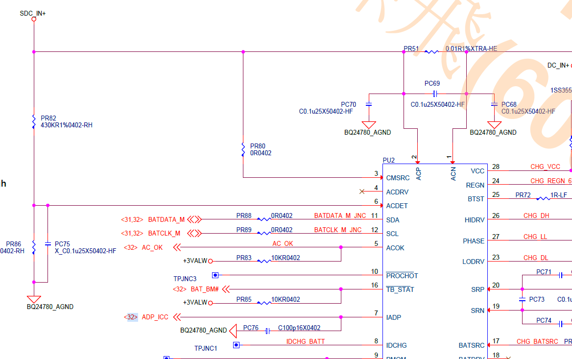

                  Should be the issue just this resistor? The customer told me that the original battery leaked, it was replaced but didn't turn on anyway, so this happened with the original battery... but how...?

                    Yes observation is really, really, really boring but so important you need to Check whole board before mesuring anything. 😁
                    This ugly resistor is here to drop the voltage Of the charger with PR86, it's a voltage divider, used by the IC to detect your charger.
                    If the rƩsistance is really blown you may not get charger presence led or charging led.
                    Of course you can replace it, but i m not really confident it Will solve your problem.
                    Do you really have 19V on NVVDDS_PWRGD​? šŸ¤”

                      I've barely saw it, that was only pure luck!
                      No, LOL, I was measuring the wrong chip! I've 0.30v on NVVDDS_PWRGD, no pulsing. Forgot to mention.
                      By the way, talking about PR82, I've measured it but seems to be OL. I will replace it and check the all trace, then report back!
