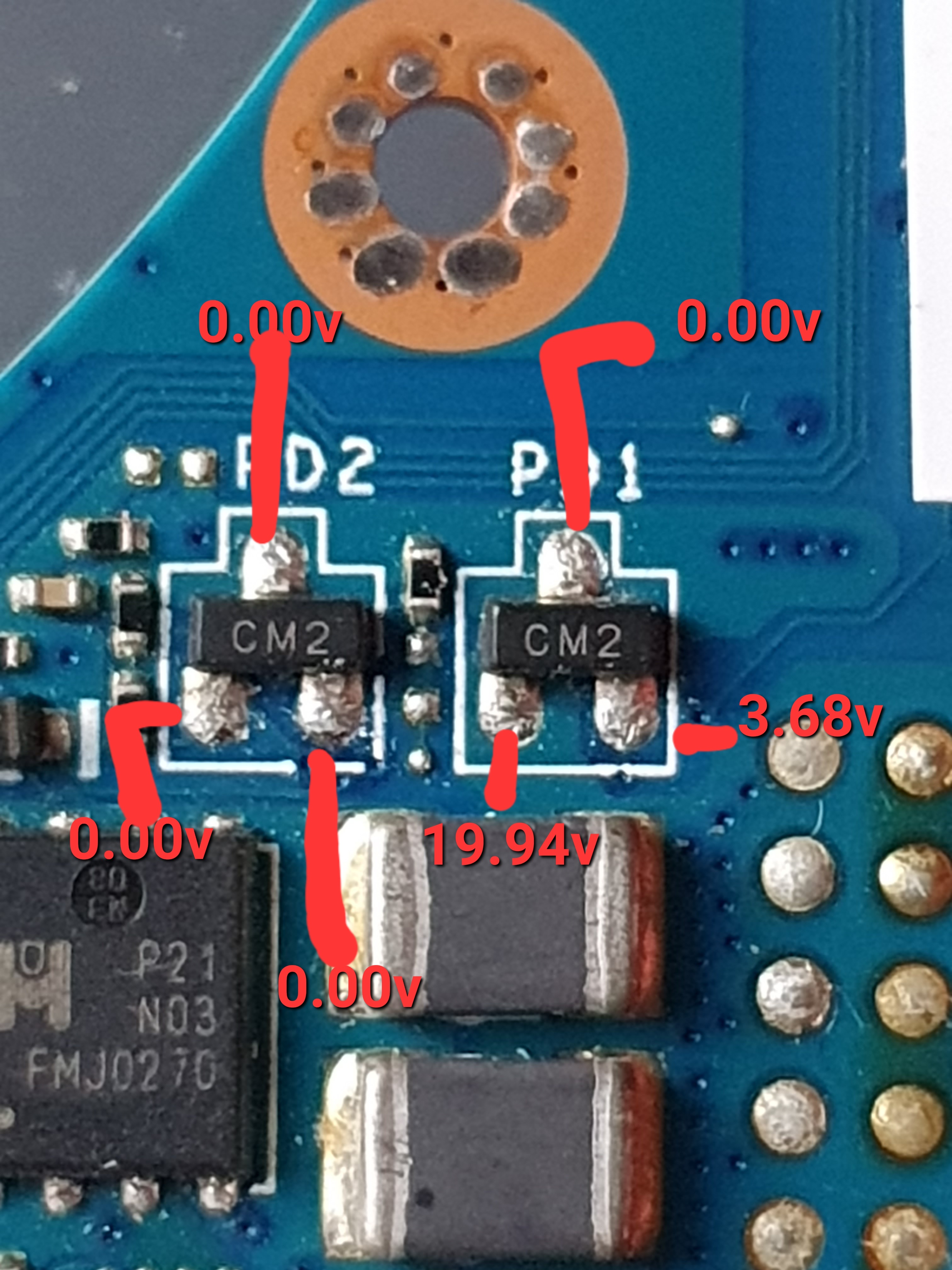

    Hiya i had a problem with my laptop which is HP OMEN 15-DH1005NA, it stopped working and the LED charging light stopped working, it stopped charging the battery aswell it was completely dead, I started checking the ac adapter to see if the voltage is going through and that ended up fine, so i had to check on the motherboard itself, i took it out and checked the power port if the voltage is going through and that looked fine, i checked a little futher where i saw 2 components PD1 and PD2 after checking the voltage it looked very odd to me which i have sent the results in the picture below, i tried to look for the schematic but couldn't fine anything for days,
    The 2 components i found was PD1 and PD2 which results was odd but i don't have any clue what they are? and what they are used for? i will send a picture of it below, if anyone knows what they are for and what the voltage should be than please let me know so i can get this laptop up and running again
    Thank you

    See attached. Believe the linked parts are ESD diodes.
    Each will trigger if there is a transient higher than the threshold voltage.

          At this time, we do not know if these parts are damaged or not. If there was a true ESD event then yes the part is sacrificial and would shunt itself to ground and prevent further use of the part.
          To check, remove all power. Meter in resistance mode. Measure the resistance to ground of each of the pins on the side with the 2-pins. The single pin side is ground. We are checking if either of the internal diodes are blown.
          Post the resistance measurement for each of these parts.
          Then, configure the meter in DIODE mode. Place the red meter probe to ground = single pin side of the part; black meter probe onto the 2-pin side. What is the measurement? Repeat for the other pin on the part. Repeat for the 2nd CM2 part.
          We are again checking if the diode is blown from an earlier ESD event.

            Hiya thank you for helping me i have test which you have said,
            on resistance mode as you said i added the red probe on the top pin and the black one on the bottom 2 pin the results i got is as follow:
            PD1 - bottom right 20.03k, bottom left 0L
            PD2 - bottom right 0.92k, bottom left 0.92k
            on diode mode as you said i added the red probe on the top pin and the black one on the bottom 2 pin the results i got is as follow:
            PD1 - bottom right 0.748, bottom left 0.749
            PD2 - bottom right 0.648, bottom left 0.648
            Thank you
            • mcplslg123
              • Jun 2015
              • 7262
              • india
              PD2 seems suspicious.

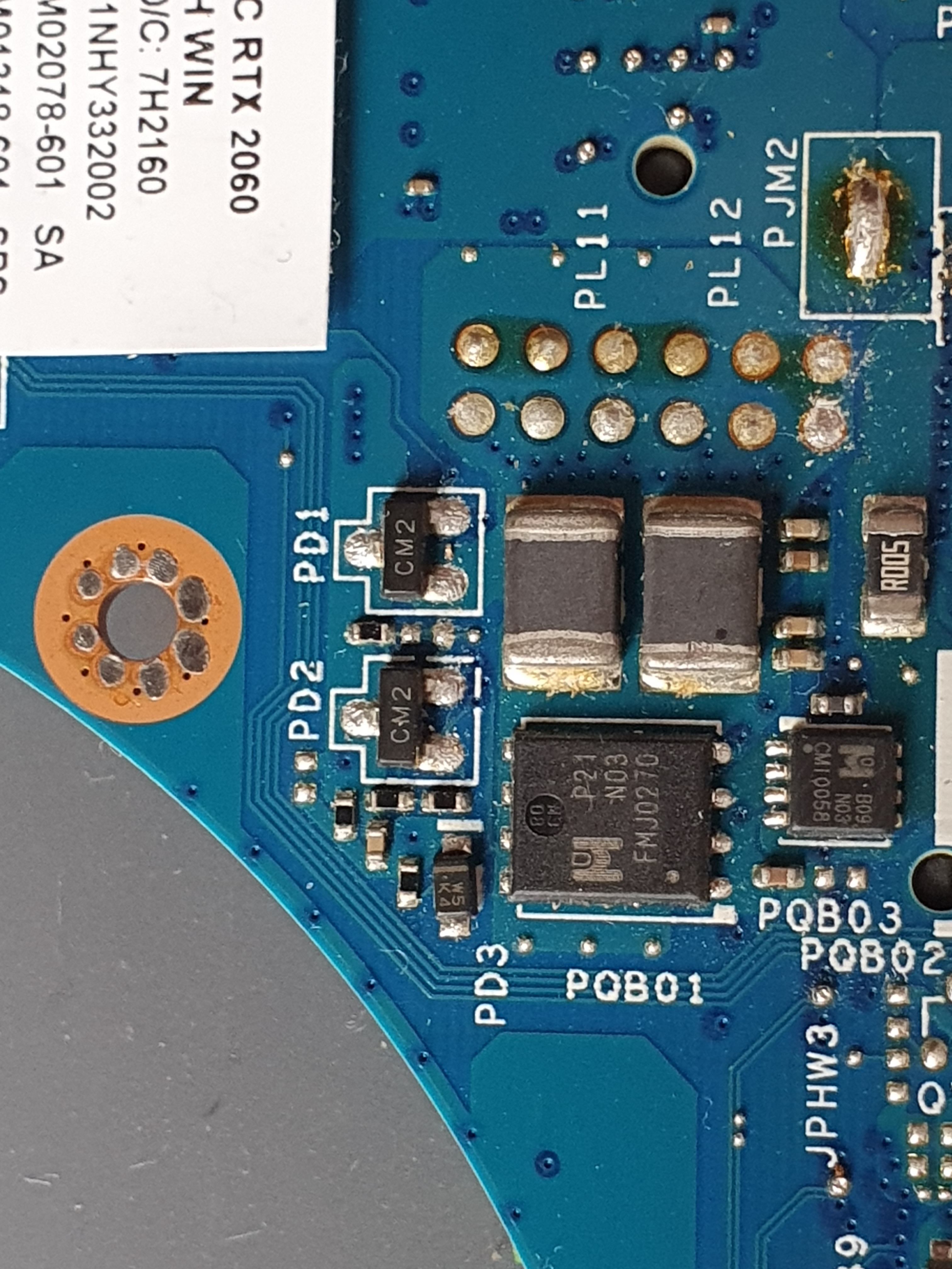

                • irfan-1
                  • Jan 2025
                  • 30
                  • United Kingdom
                  I was checking on different chips for the voltage but on one chip i saw a spark, can you have a look what that chip is? I don't understand why it blow up the corner lead when i was just checking the voltage?
