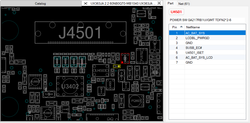

    Hi guys, I'm repairing a motherboard from an ASUS UX363JA R2.2 that won't turn on, I found a component exploded near the display connector.
    I don't have the diagram so I can't figure out what code it has, also if I power the main with the USB-C I have a draw of about 2A at 5V and it doesn't go to 20V.
    I checked the mosfets and inductors and everything seems ok, but I don't know what to do.
    Do you have any ideas?​

    try Click image for larger version

      thanks!!! can you send me the whole brd view and the schematic if available?
