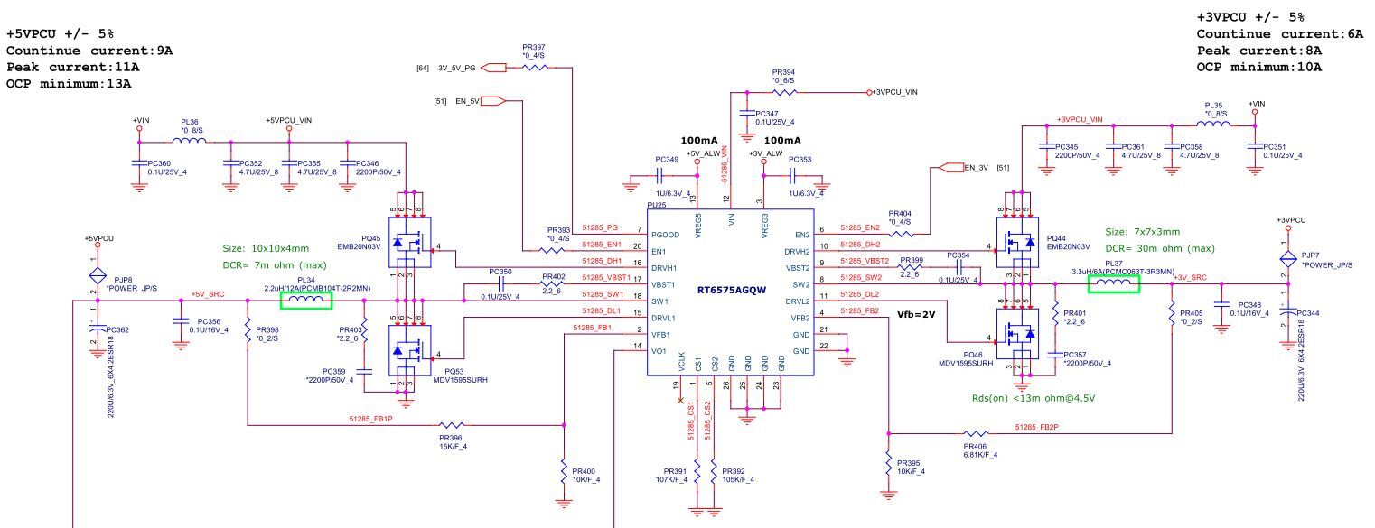

    HI ALL.
    I HAVE M/B DA0X83MB8H0 REV:H WHICH HAS SHORT THE +3VPCU RAIL.
    WHICH POINT CAN I INJECT VOLTAGE IN ORDER TO FIND WHERE IS SHORT AND AT WHAT AMPS!
    I GOT A LOT OF CAPS SHOWNING SHORT.
    THANKS

        • FriedFred
          • May 2024
          • 138
          I suggest to disconnect the DC-DC converter and check the DC-DC converter and the rest of the +3VPSU rail.
          For this, you just open the PJP7 connection and then you can test the DC-DC converter by itself.

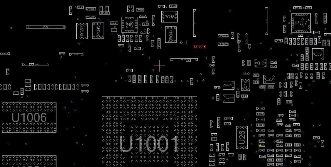

          • NConstantinou
            • May 2017
            • 348
            • Cyprus
            Unfortunately there are no PJP junctions on board as described on schematics that is why is more difficult to find out the problem.
            • FriedFred
              • May 2024
              • 138
              In the black colored screen-shot above, there is a red marked item. This is the "PJP7" junction, you need to open.
