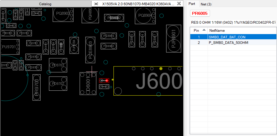

                    try Click image for larger version

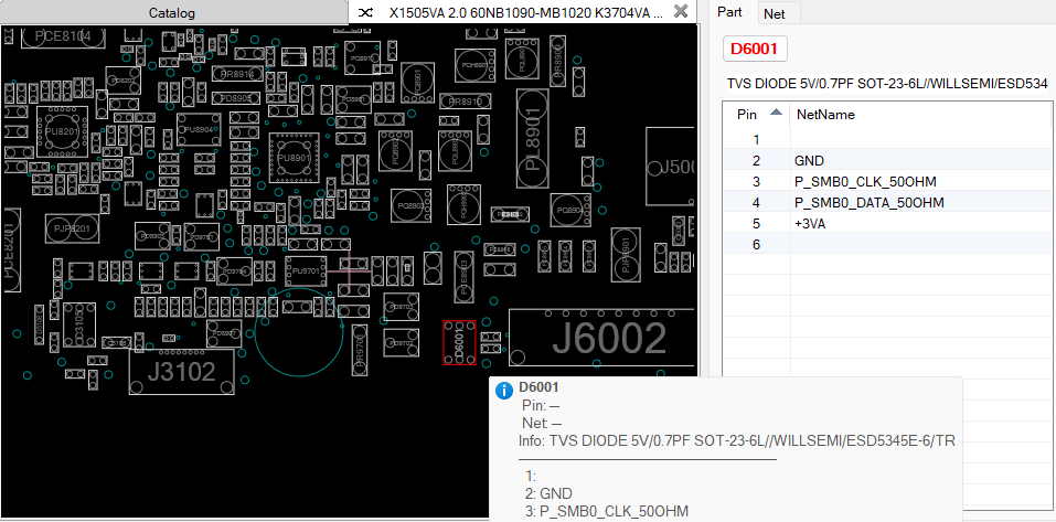

                    • FriedFred
                      • May 2024
                      • 137
                      It looks like a transient voltage suppressor diode array. Yes, I'm right - in your boardview you can see "TVS". :-)
                      Anyway, the board shall work also without this IC.
                      Which line is the shorted line? Please be more specific.

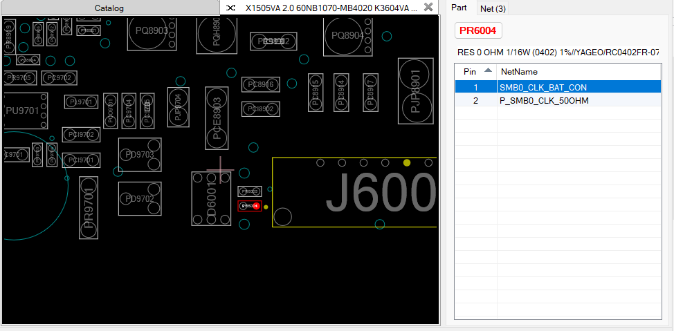

                        Hello noname2024
                        Can you tell me the value of the 2 resistors betwwen the battery connector and the TVS chip ?
                        After replacing SIO and Charge IC laptop works but does not see the battery % nor it charges.
                        But it holds with the battery if I remove dcin.
                        So I think its data/communication issue, could be those 2 resistor.
                        They measure 0ohm both on the board.
                        Thanks if you can help!
                        • mon2
                          • Dec 2019
                          • 13971
                          The SMBUS line labels show 50 ohms. These will be any low resistance resistors that are used to current limit the lines in case of a short circuit. You can place 10R-100R without issues. We use 33R for a lot of our product designs for the same task.
                            Originally posted by magneh
                            Hello noname2024
                            yes 0hm Click image for larger version
                                Thank you noname2024
                                So they are good... not sure what else to do here... still same problem does not see the battery level or charges battery.
                                But machine stays on when I remove DC charger... so frustrating

                                • mon2
                                  • Dec 2019
                                  • 13971
                                  Measure the voltage to ground on each of these smbus lines. Post the measurements.
