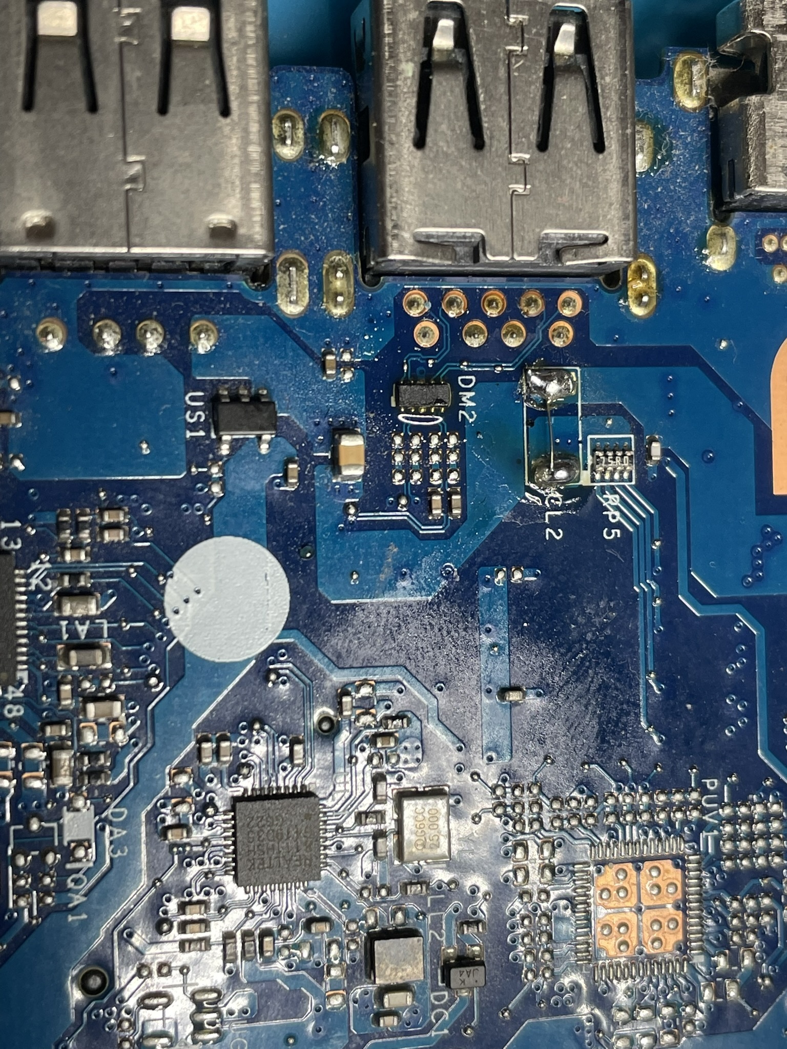

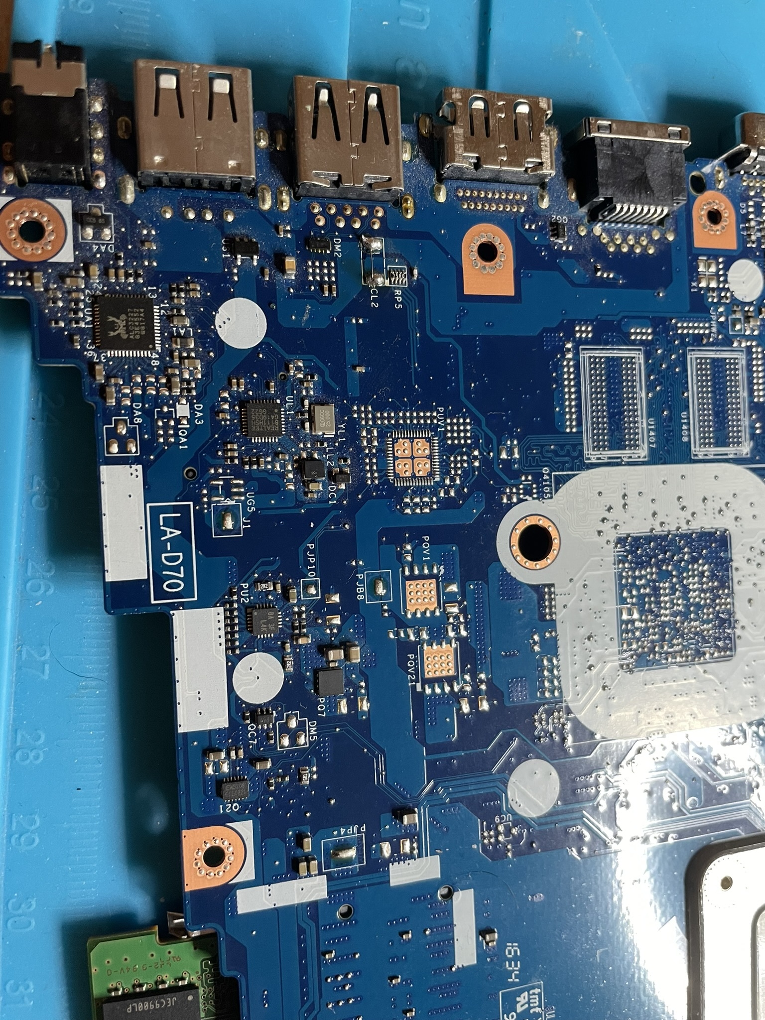

    Hi there
    Would anybody be kind enough to point me in the right direction for purchasing this component / fuse please?
    Initially it was dead, and multiple faults, so I found this O/C Fuse, or at least I assume it is a fuse.
    The problem was a jammed in USB Mouse / Keyboard dongle, that was so hard to remove
    I dont have any schematics, but I woukd be interested to know what the Fuse is for
    On the board you can see it is in the top right CL2
    Anybody else had this fault?
    Thankyou

    Board for that is LA-D704P, should see the full number in the middle of the board (usually near the RAM slot).
    It's actually a capacitor, not a fuse, so should measure open circuit. It's part of the ESD protection for the LAN connector and is rated at 3kV according to the schematic.

      Hey Reformatt
      Thankyou again for your response.
      Thats weird, I thought it was a fuse
      What would you suggest I should replace it with, or purchase on eBay?
      Thanks again for your knowledge.
      Have a Blessed day
      ps - Hey Reformatt - I couldnt find the component, when I did a search for CL2, so I searched for the Resistor Pack next to it RP5, and it found it with P/N SE167100J80
      I would still like to know, what replacement to use?
