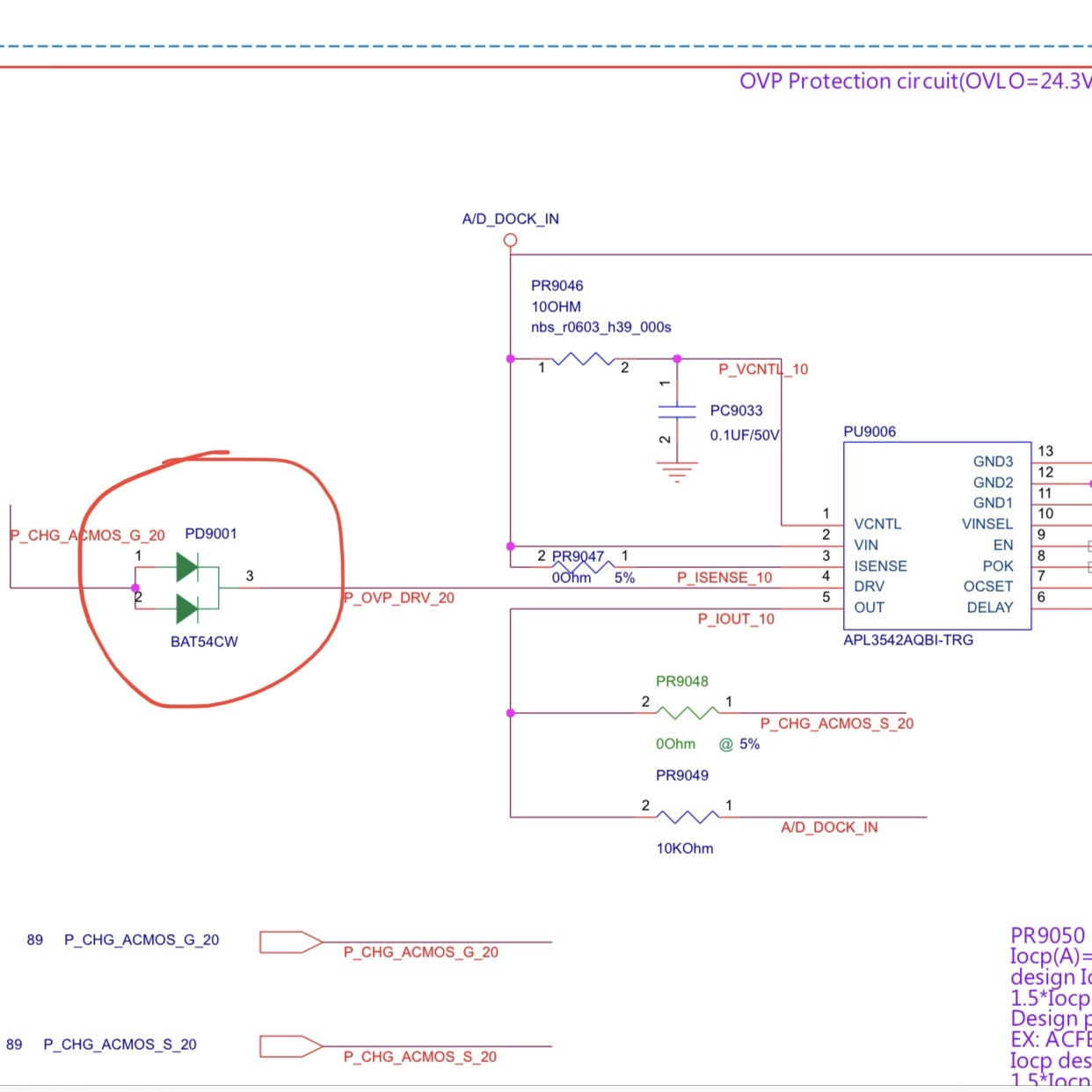

    Hi all..
    long story short when i disassemble a laptop (asus gl504gs) for cleaning. I found some component deliberatelly removed from the board by unknown technician.
    turns out this component is a diode BAT54CW
    For a power protection circuit
    i installed this component and now laptop not charging anymore
    its detect the ac adapter but not charging the battery
    i removed the component again and know it start charging normaly
    i just curious why this happen, i mean it should be there from factory but why when i installed it and it make the laptop not charging? Click image for larger version
