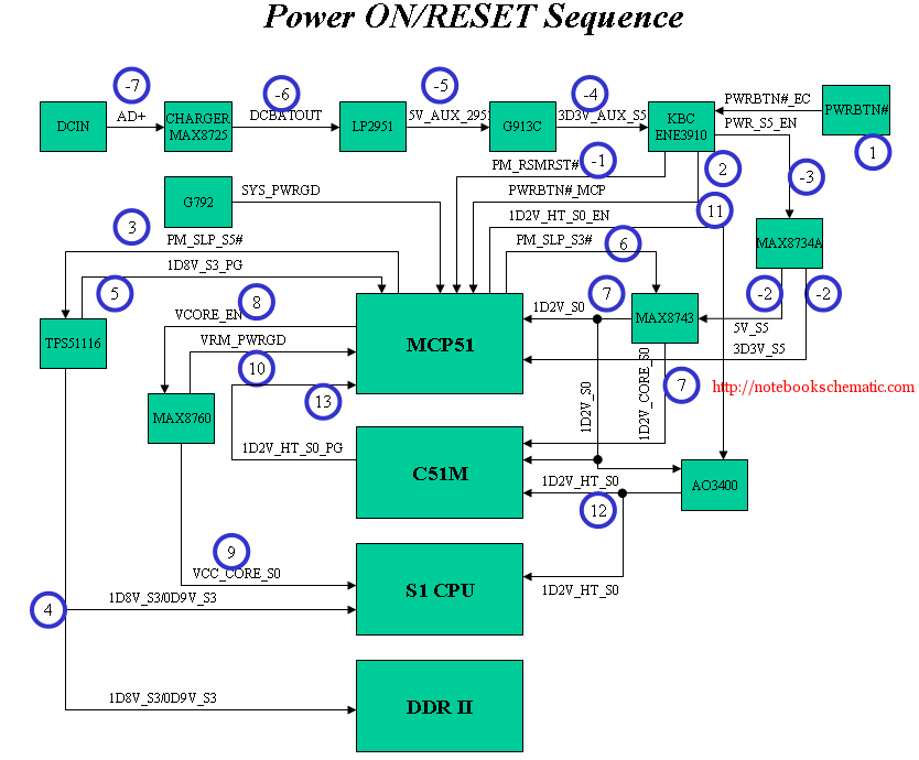

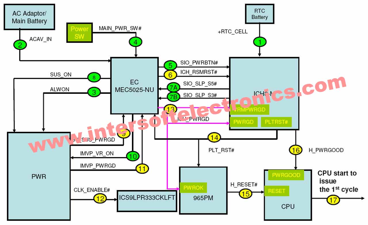

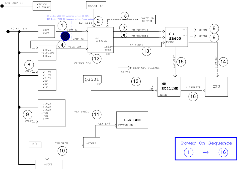

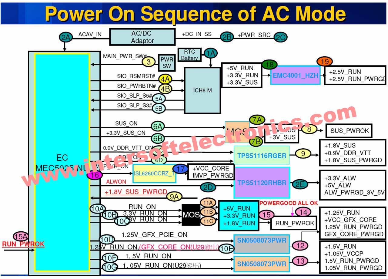

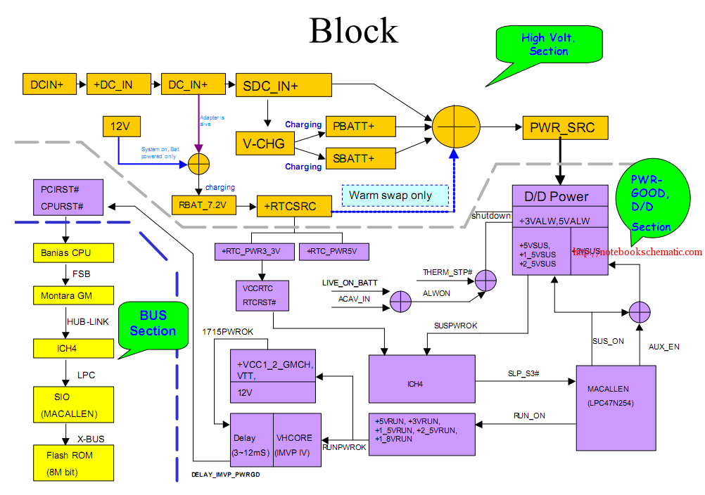

    i googled a bit, stumbled upon this
    a few power sequence examples, helps a bit newbies like me, hope it comes handy to you too
    its Vietnamese i think, google translations here
