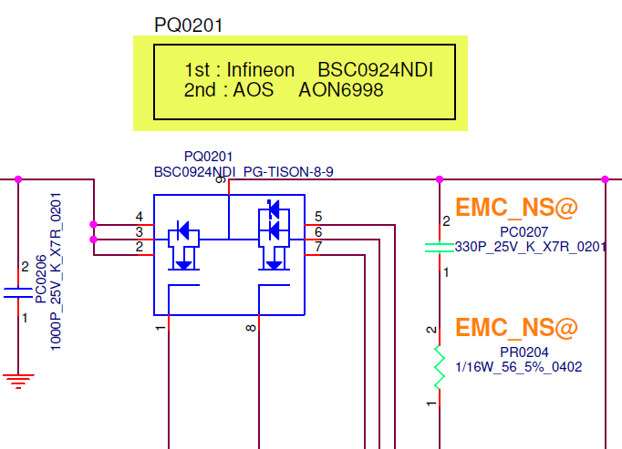

            On my board, the PQ0201 is a Dual N-channel MOSFET:
Name:	Screenshot from 2024-12-07 18-40-17.png
            Here are the measurements:
            pin measure pin measure
            1 ~400mV 5 0v
            2 20v 6 0v
            3 20v 7 0v
            4 20v 8 5.8v
            9 ~308mV

                My bad...indeed a dual mosfet inside a single package.
                However, in the schematic there are 2 part numbers used for this component. Each is a DUAL N-channel mosfet so this implies that the gate voltage must be higher than the voltage being passed betwee source / drain pins to enable.
                On the BQ series, the N-channel driver pin should be ~25v and is based on adapter voltage + REGN voltage = 20v + 6v = ~25v to enable the mosfet.
                Noting that we do not have this voltage from the BQ charger IC, proceed to test the following pins of interest.
                Remove all power. Meter in resistance mode.
                Measure the resistance across each mosfet pin:
                source / drain
                source / gate
                gate / drain
                of the 1st mosfet inside this package
                then repeat for the 2nd mosfet inside this package.
                We are checking if there is a low resistance which often means the mosfet is shorted and needs to be replaced. Each measurement should be hundreds of k ohms or higher if normal.
                Assuming the resistance checks are ok, carefully review the voltage to ground of the following pins of interest on the charger IC:
                VBUS ; pin # 1
                REGN ; pin # 28
                ACN ; pin # 2
                ACP ; pin # 3
                See attached for the datasheets for the dual mosfet parts used at this location by the PCBA shop:

                  The Dual MOSFET on the board is marked 0924NDI, so it's the Infineon.
                  High side (gate:1 -- source:9 -- drain: 2,3,4)
                  source / drain 150k and raising
                  source / gate 220k
                  gate / drain 450k and raising
                  Low side (gate: 8 -- source: 5,6,7 -- drain: 9)
                  source / drain 87k
                  source / gate 210k
                  gate / drain 346k
                  On the IC charger I find:
                  pin name measure
                  1 VBUS 20.12v
                  2 ACN 20.11v
                  3 ACP 20.12v
                  28 REGN 6v
                  • mon2
                    • Dec 2019
                    • 14868
                    #29
                    The low side mosfet inside this dual mosfet looks to be quite low (87k ohms) for a good mosfet.
                    Suggest to flux and remove this dual mosfet and test the component while it is on your workbench. Are these measurements still this low on your bench? Each should be hundreds of k ohms or higher. This part may be defective.
                    Can you measure in the same manner the dual mosfet @ PQ0202? Post your measurements.

                      Here what the PQ0201 shows when off the board:
                      source / drain 4M
                      source / gate OL
                      gate / drain OL
                      source / drain 123k
                      source / gate OL
                      gate / drain OL
                      And the PQ0202 (in circuit):
                      source / drain 160k and raising
                      source / gate 219k
                      gate / drain 229k
                      source / drain 141k
                      source / gate 201k
                      gate / drain 340k
                      • mon2
                        • Dec 2019
                        • 14868
                        #31
                        Both PQ0201 & PQ0202 look too low for me. Suggest to flux and replace both dual mosfets. Before you do this, measure the fresh ones while they are on your work table. You can use the measurements as a comparison of a known good mosfet. Each will be much higher in measurement. Recommendation is to source from tier 1 distributors like Digikey / Mouser / Arrow and only if you must, Aliexpress but select a vendor with very high ratings.
