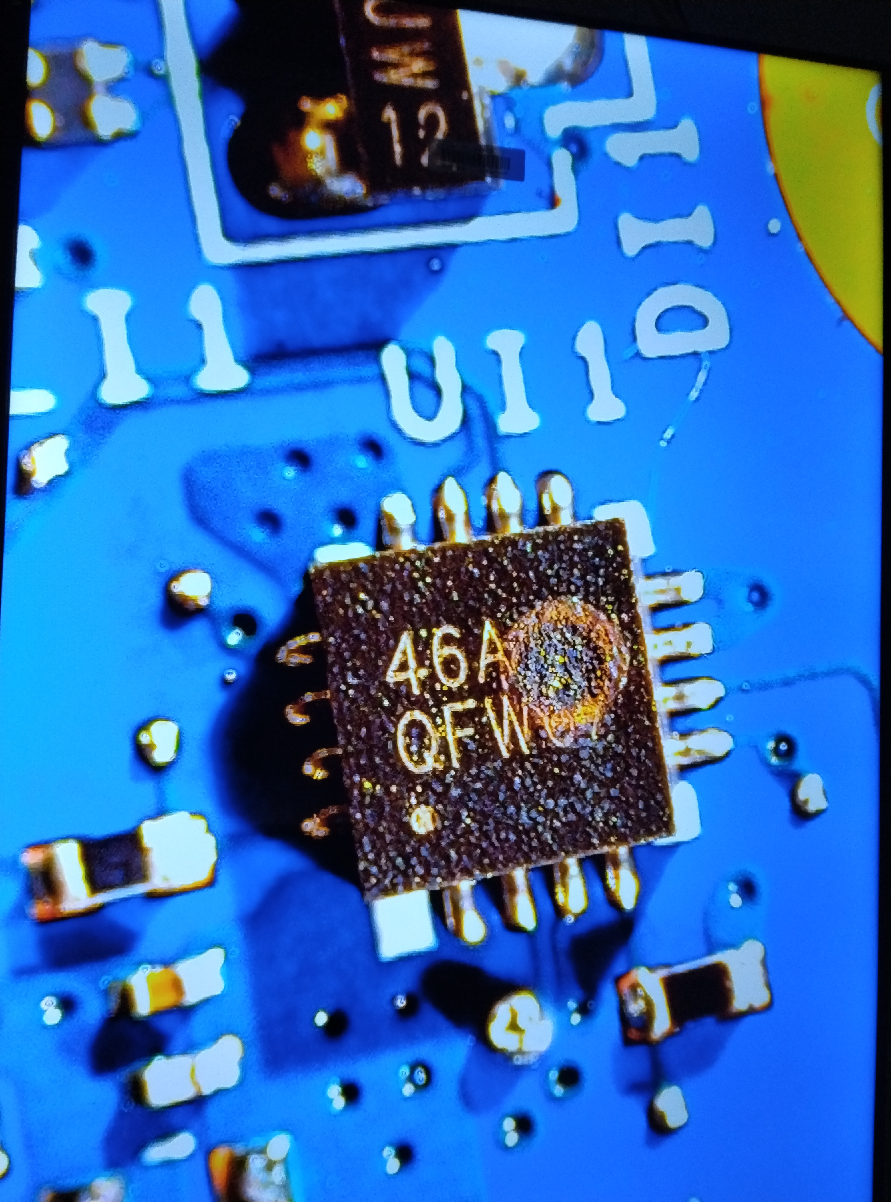

    Hi i need help with a Dell latitude 14 5420 GDF40 LA-K491P Rev 2.0 (A01) 2020-11-16

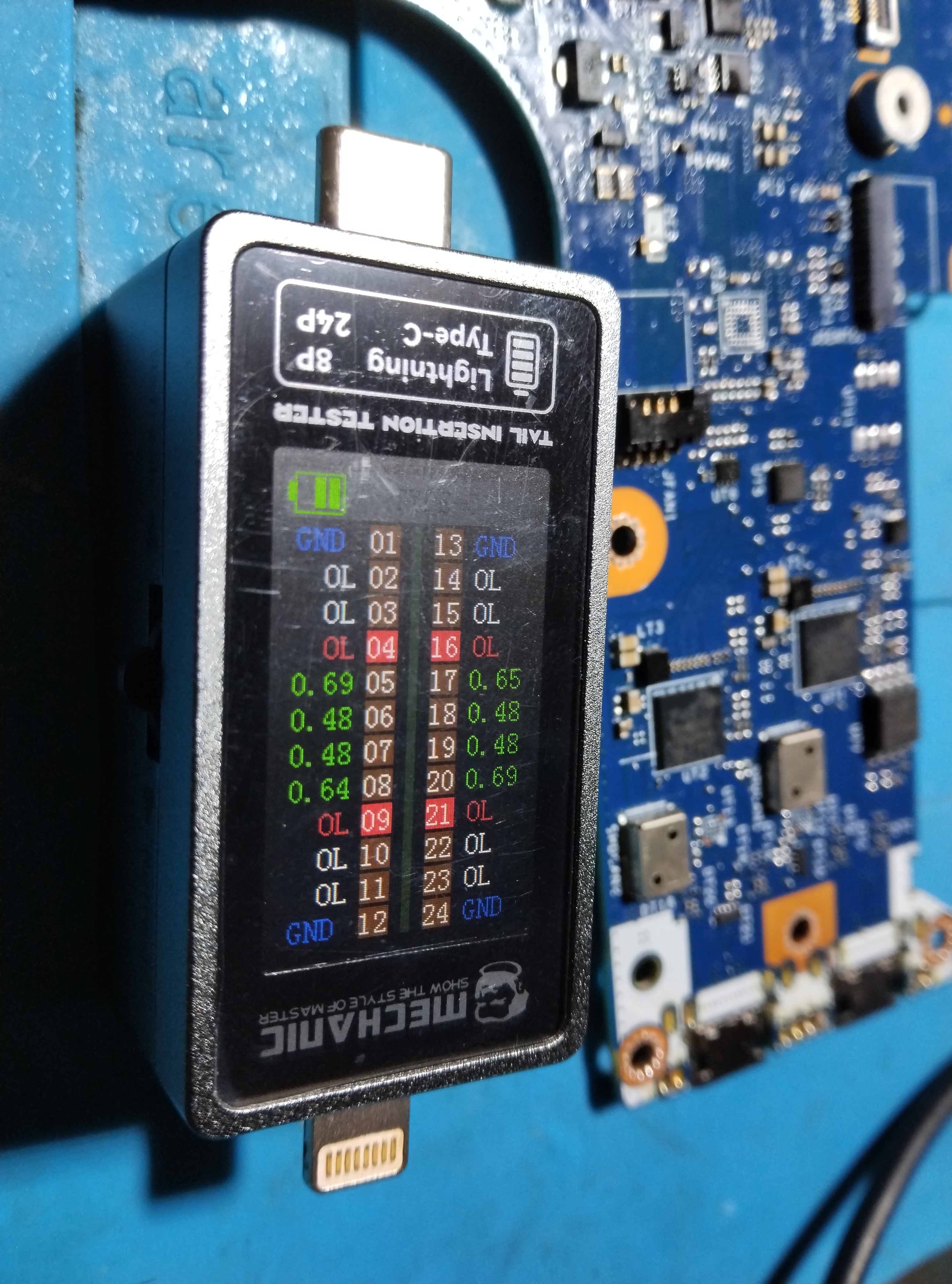

    Hi i need help with a Dell latitude 14 5420 GDF40 LA-K491P Rev 2.0 (A01) 2020-11-16 , it charges on usb type C i checked the charger with a pd decoy and a electronic charge its ok when, i tested the usb c jack with a tail tester it reads ok Click image for larger version
Name:	laptop tail reading.jpg

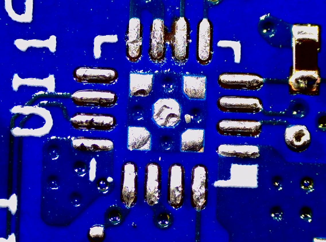

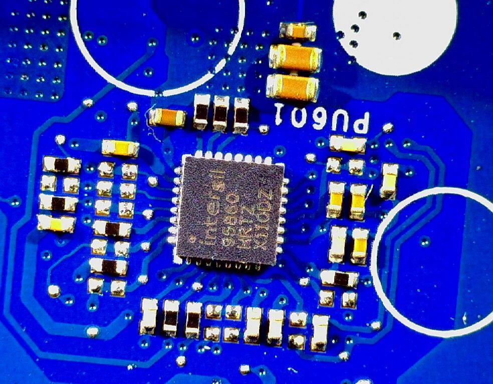

ID:	3637350 (photo incluided), then with a usb charge tester it looks like its trying to negotiate the PD but ressets i openned the laptop and with a thermal camera i noticed 3 ICS getting hot the TPS65994 (UT3) the ISL95860HRTZ (PU601) and the IC SLGC55544CVTR (UI1) this one Click image for larger version
ID:	3637351 checking it on the micoscope looks damaged visually (picture incuided) and looking on the Boardview im not 100% sure if the ic it shows on the board view its correct could you guys helpme if its correct or wrong

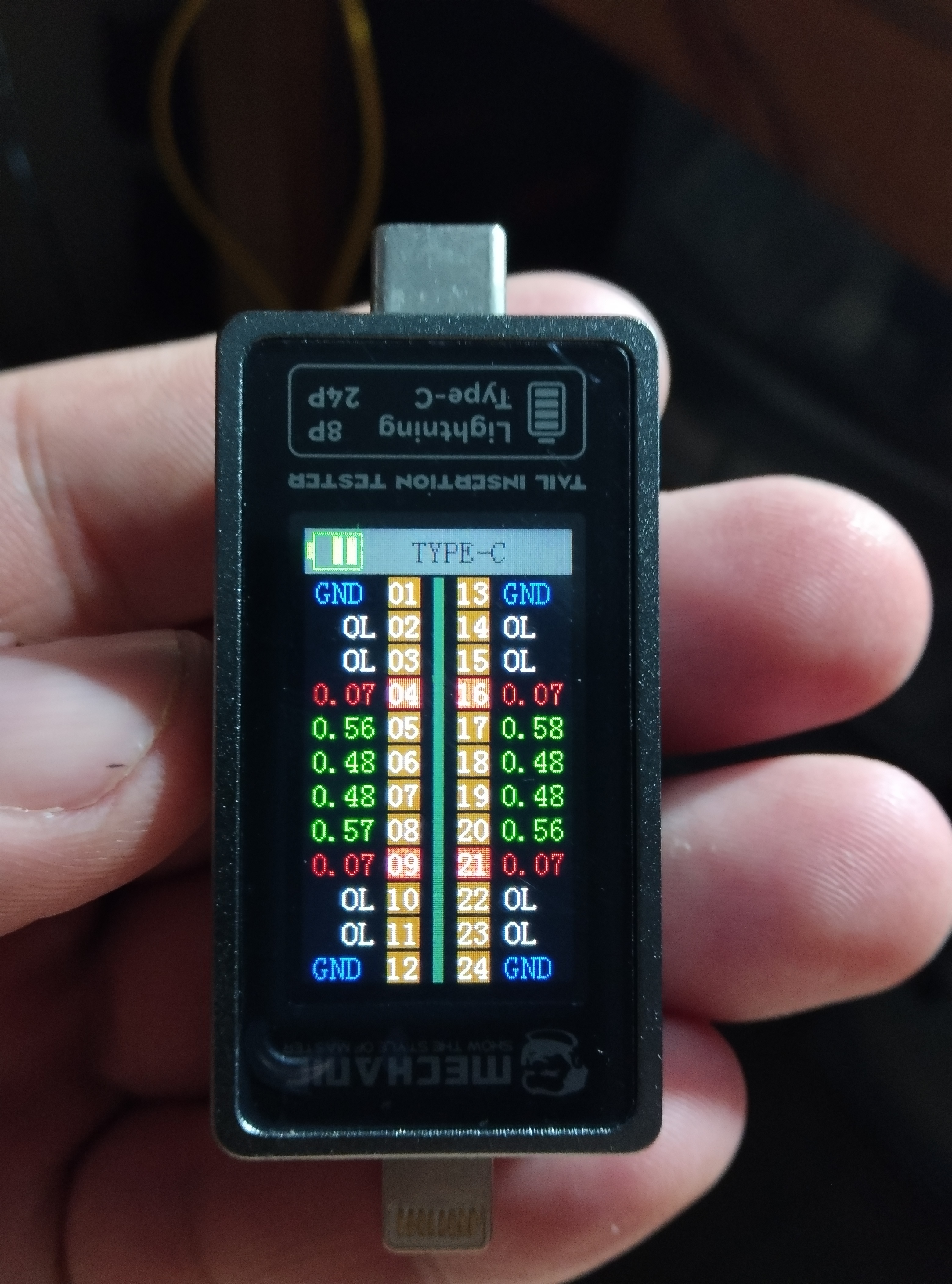

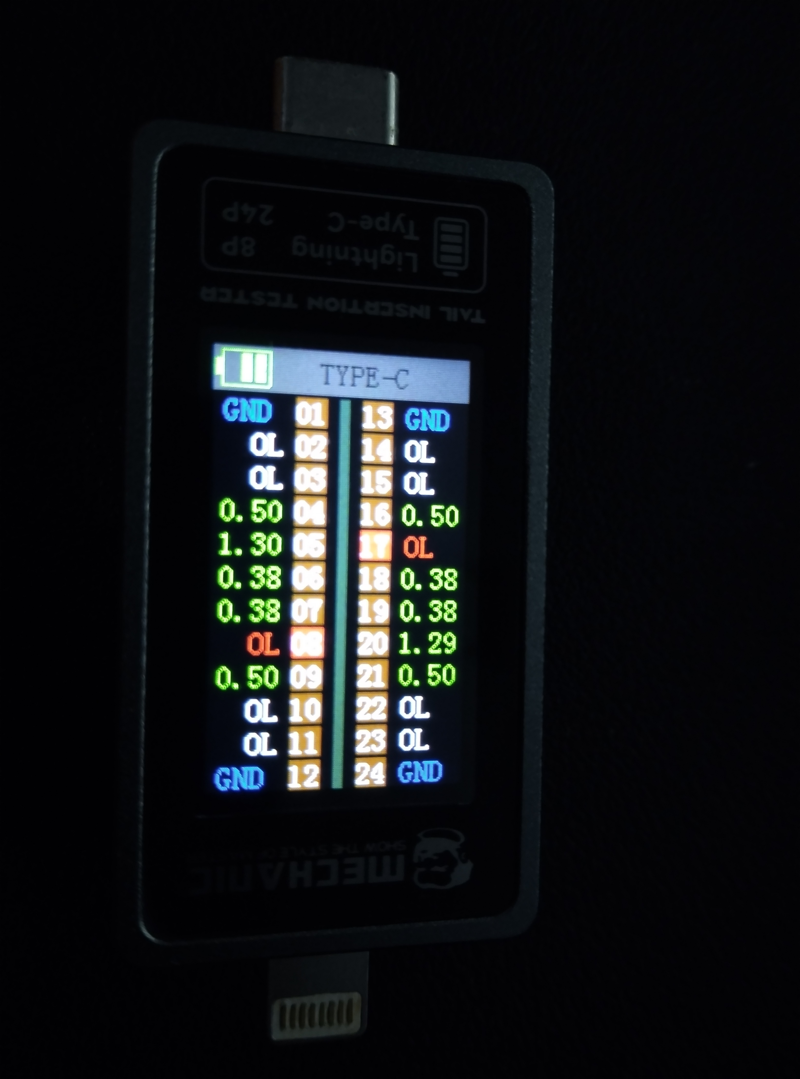

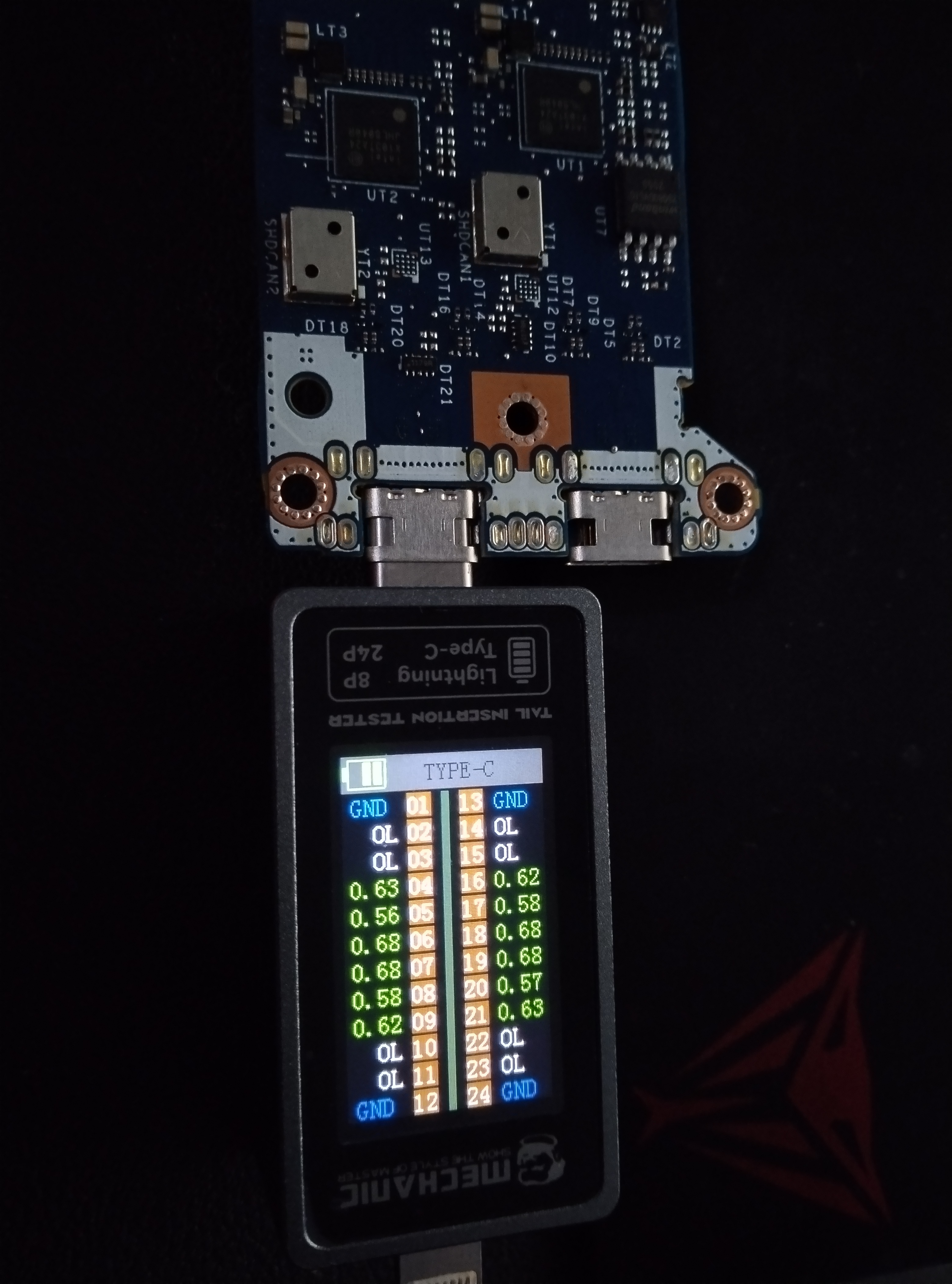

    the ic that gets more hot is the the TPS65994 (UT3) , i removed the UI1 IC that looked damaged, and tested again, with the tail tester Click image for larger version
ID:	3637379 and comparing it to the port 2 Click image for larger version
ID:	3637380 and my phone Click image for larger version
ID:	3637381 it looks like pins 04,09,16,21 are on short(its my first time using this tool) and my first usb type c charger laptop im trying to fix, it still doesnt turn on, the TPS65994 (UT3) still getting very hot and the ISL95860HRTZ (PU601) is getting also but not that hot, ill check where those pins go and see if its the TPS that is on short or what

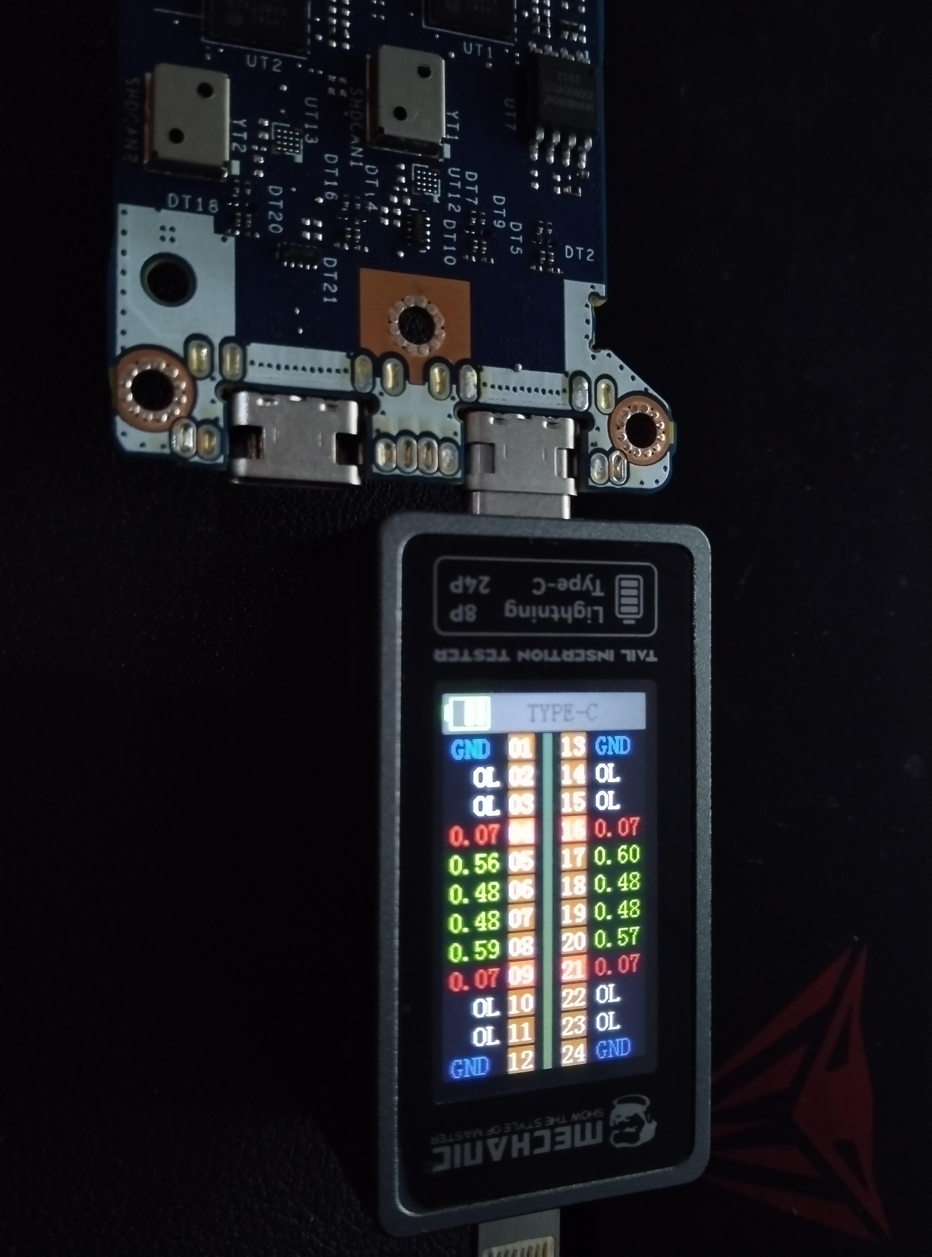

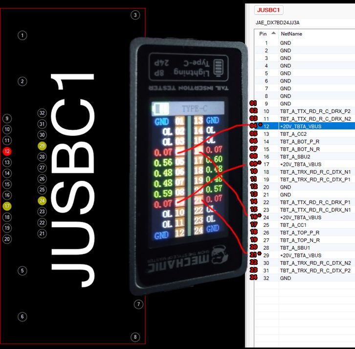

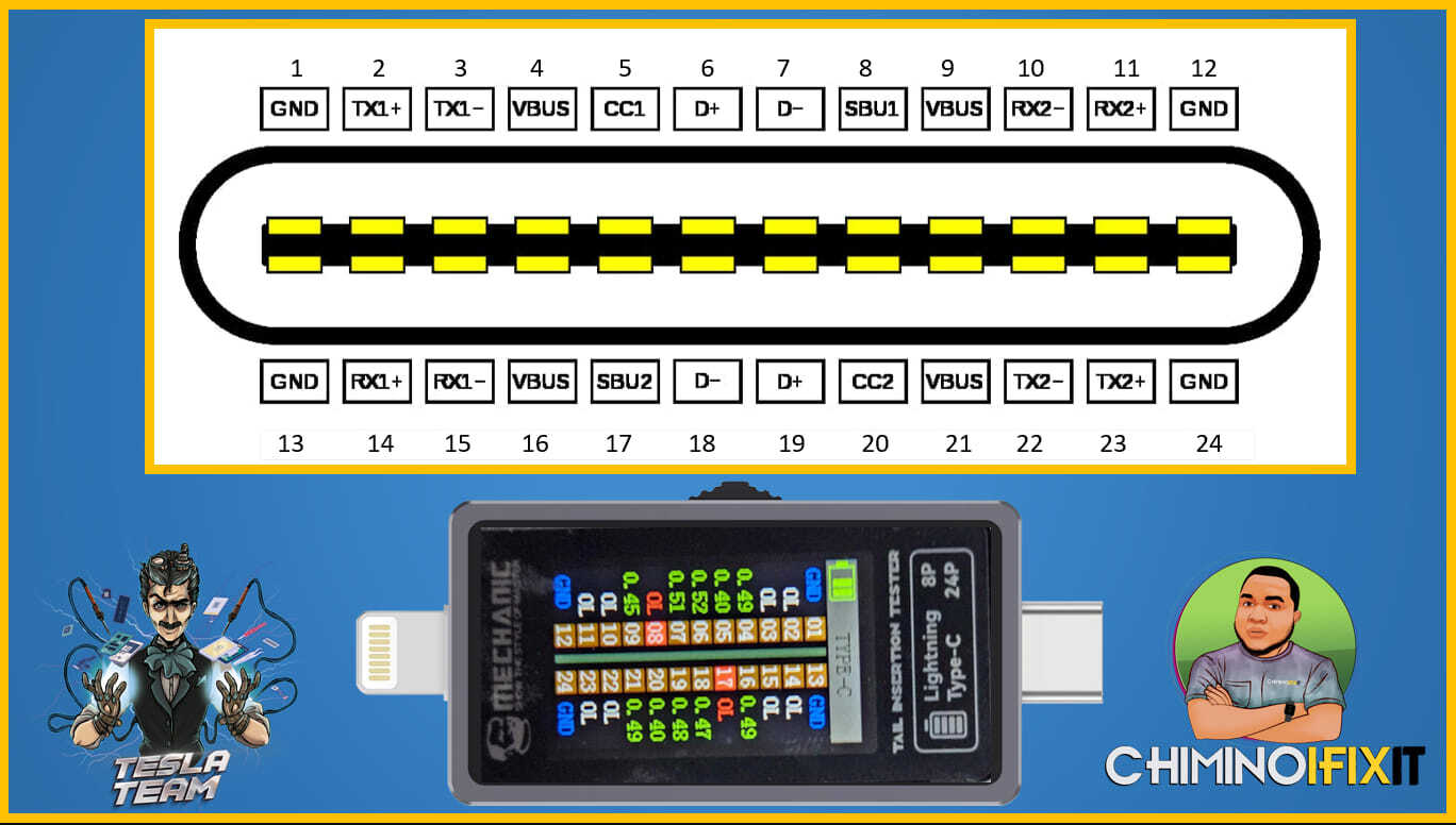

      found the pinouts for the tail tester Click image for larger version
Name:	type c tail 2.jpg
ID:	3637389 Click image for larger version
Name:	type c tail.jpg
ID:	3637388 now to check them on the boardview
      • djpaesgana
        • May 2021
        • 25
        • México
        YUP.... its in SC Click image for larger version
Name:	pinout on boardview.jpg

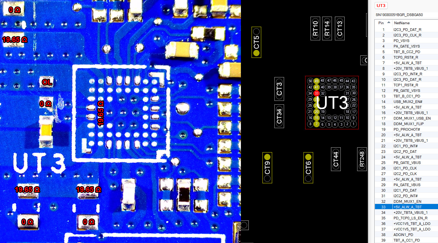

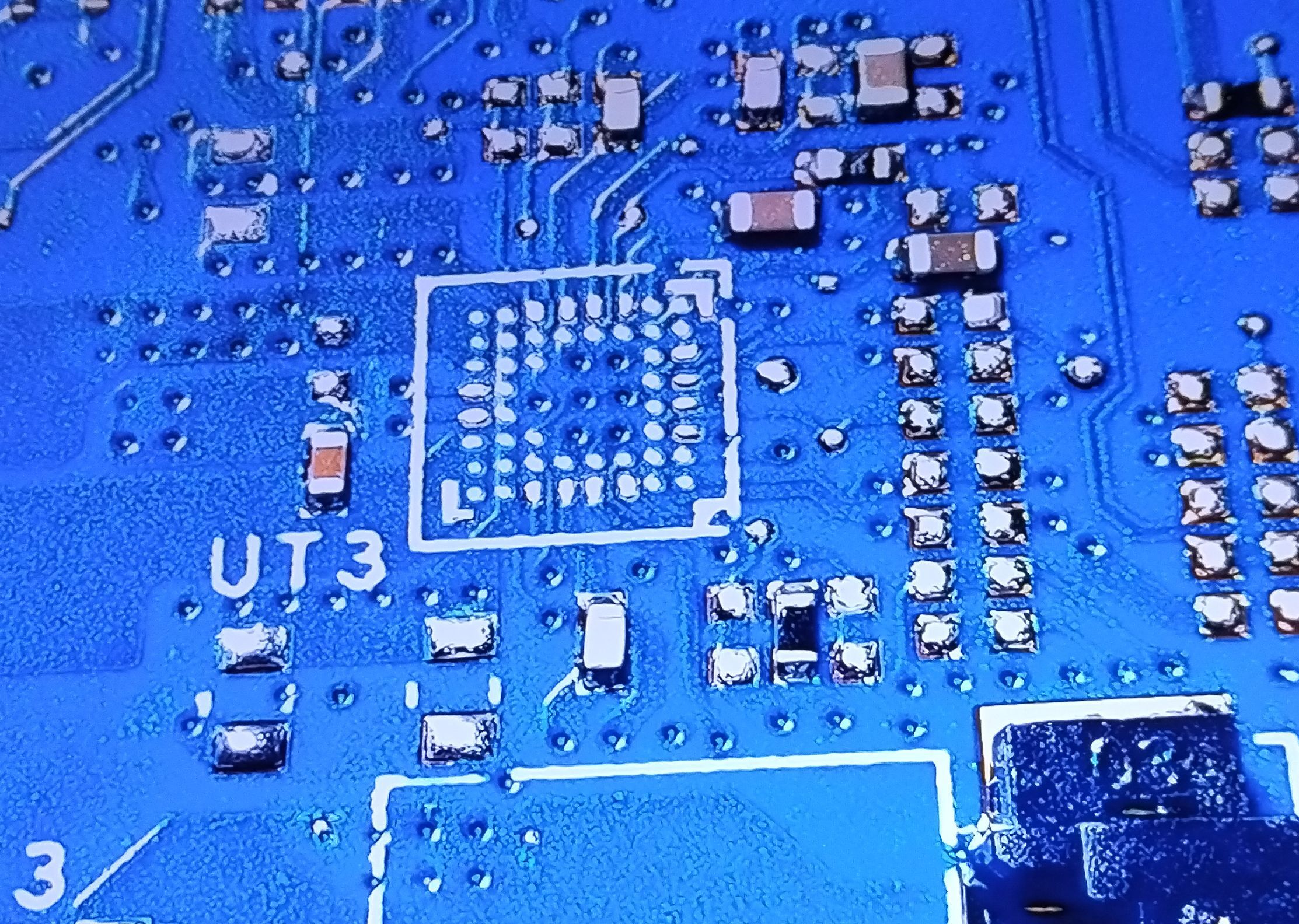

            i removed the ut3 and some caps Click image for larger version
Name:	ut3 removed.jpg
ID:	3637495 and still read on short where the caps pads, tested with the tail tester and the short went to open Click image for larger version
Name:	tail tester without ut3.jpg

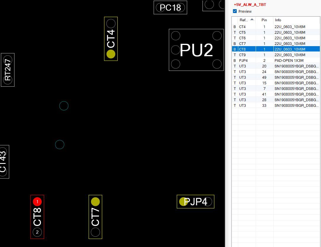

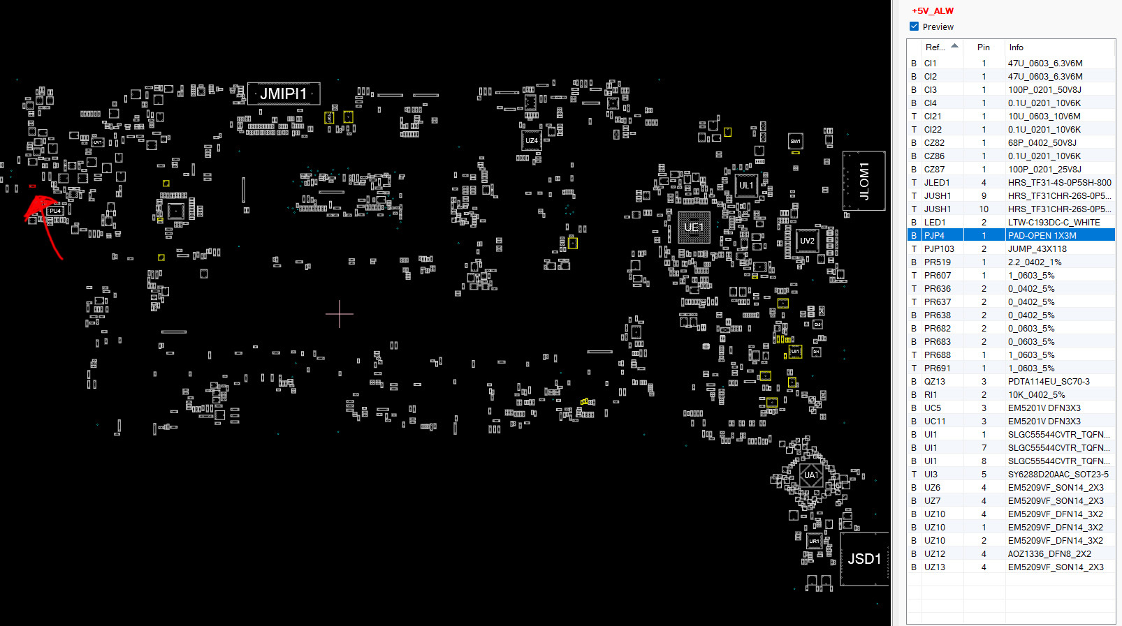

              following the net of 5v_alw_a_tbtClick image for larger version
ID:	3637505this caps and the test point also reads on short, so following the testpoint Click image for larger version
ID:	3637506 should i inject 1V 1A on it to see what else gets hot or should i test component 1 by 1 on that list +5v_alw hmmm....

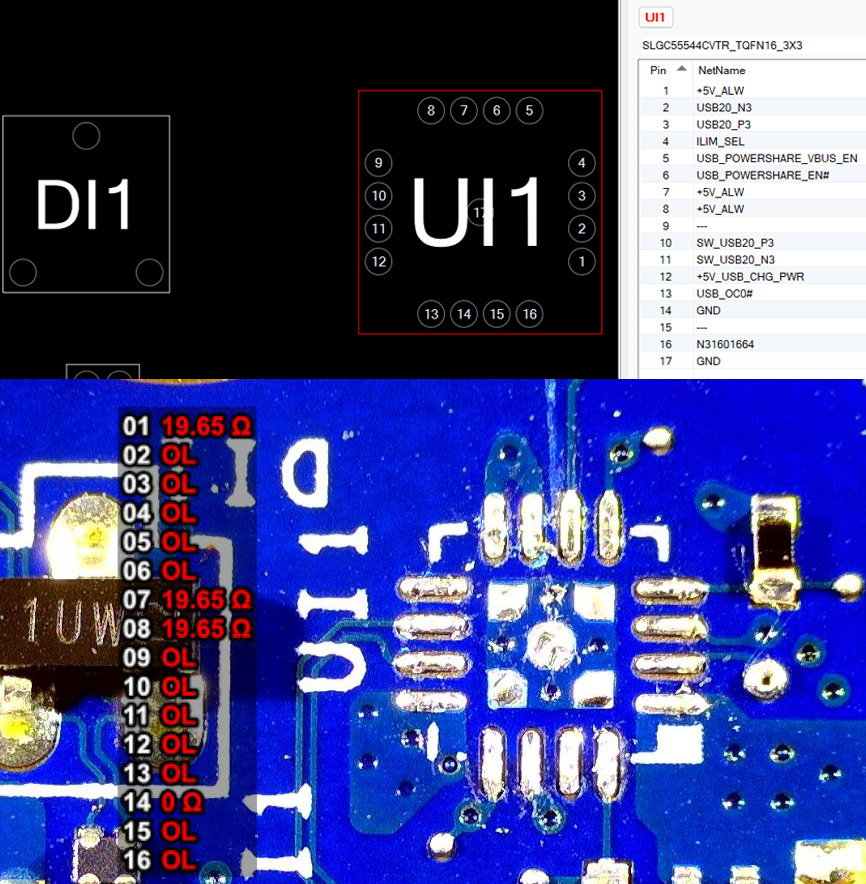

                UI1 is already removed and motherboard still on short
                • mon2
                  • Dec 2019
                  • 14634
                  Which pin on UI1 is showing the short? Post the full details of the pin # and also the resistance to ground in ohms.

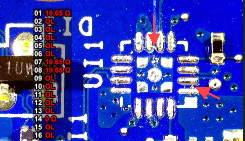

Name:	UI1 Readings.jpg
ID:	3638018 this are my readings, the ic was getting hot and also looked like damaged Click image for larger version
ID:	3638019 i havent tested the ic outside the mobo

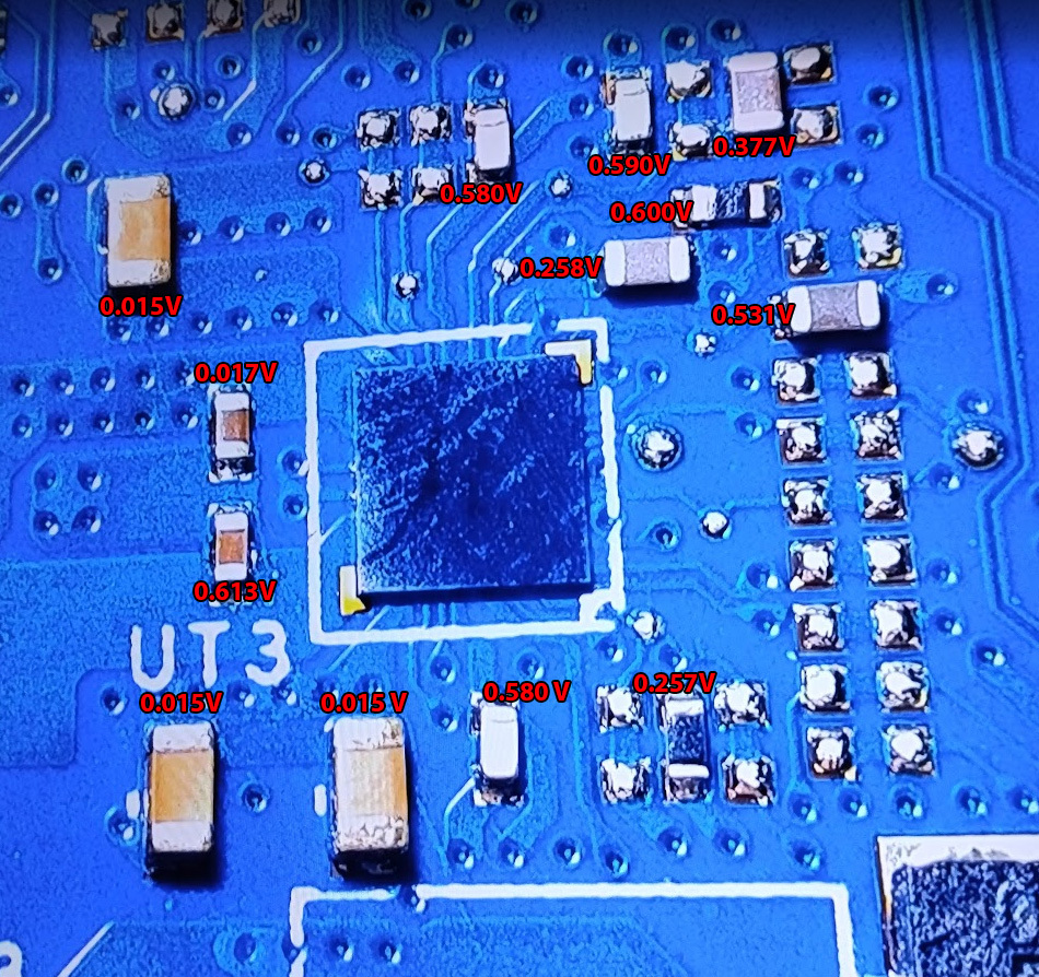

                      readings on UT3 Click image for larger version
Name:	UT3 Readings.jpg
                      • mon2
                        • Dec 2019
                        • 14634
                        Attached.

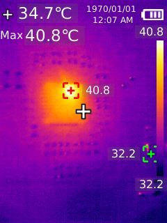

                            i aplied 1v 1a to the pad 8 of UI1 nothing happened, aplied 2v 1a and pu601 Click image for larger version
ID:	3638123 came hot Click image for larger version
ID:	3638124 , nothing else

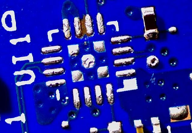

                            • mon2
                              • Dec 2019
                              • 14634
                              Review the topside middle 2 pads again. There is still a solder short that is visible.
                              • djpaesgana
                                • May 2021
                                • 25
                                • México
Name:	ui1 rel clean.jpg
ID:	3638162same readings after cleaning it

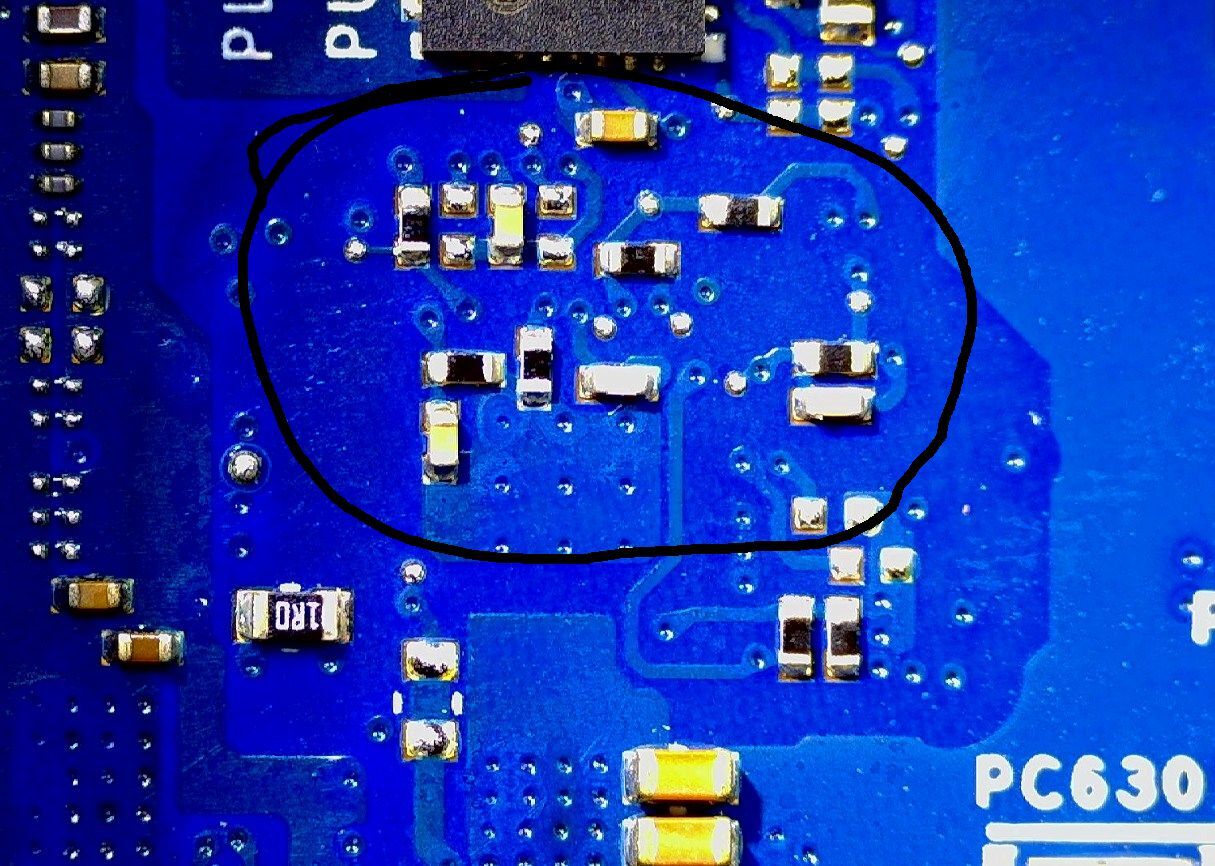

                                • mon2
                                  • Dec 2019
                                  • 14634

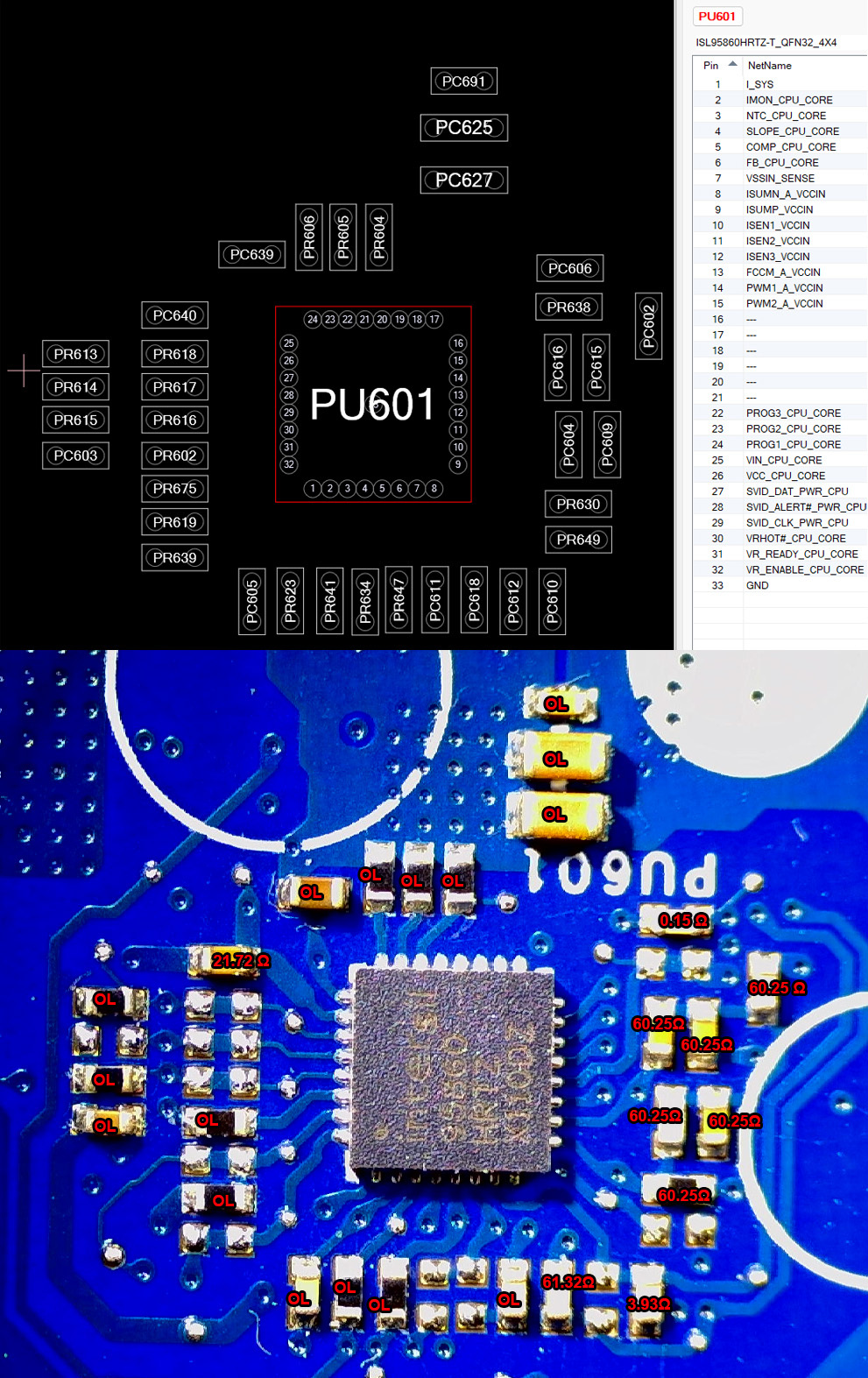

                                  Review if there is a bottom side part under the area that is heating on pu601.
                                  • djpaesgana
                                    • May 2021
                                    • 25
                                    • México
                                    pu601 readings from ground to caps Click image for larger version
Name:	pu601 readings 1.jpg

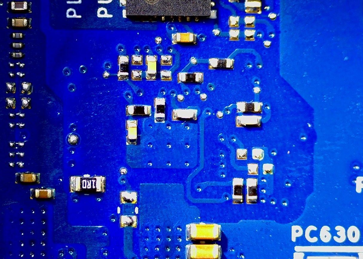

                                    • djpaesgana
                                      • May 2021
                                      • 25
                                      • México
                                      this is the area behinmd the pu601 Click image for larger version
ID:	3638194 Click image for larger version
Name:	behind p601-2.jpg
                                      • mon2
                                        • Dec 2019
                                        • 14634
                                        PC640 is ~21R ohms to ground? This is the +5V_ALW rail and this resistance is very low. Confirm it. Remove PC640 and test the resistance to ground again.
