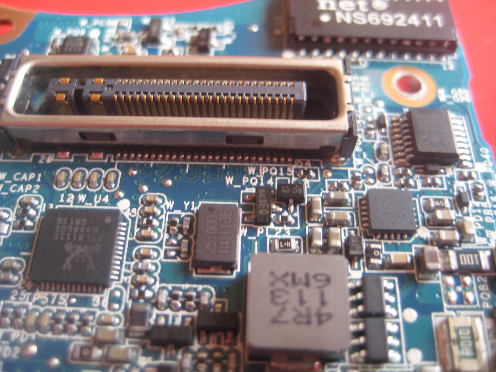

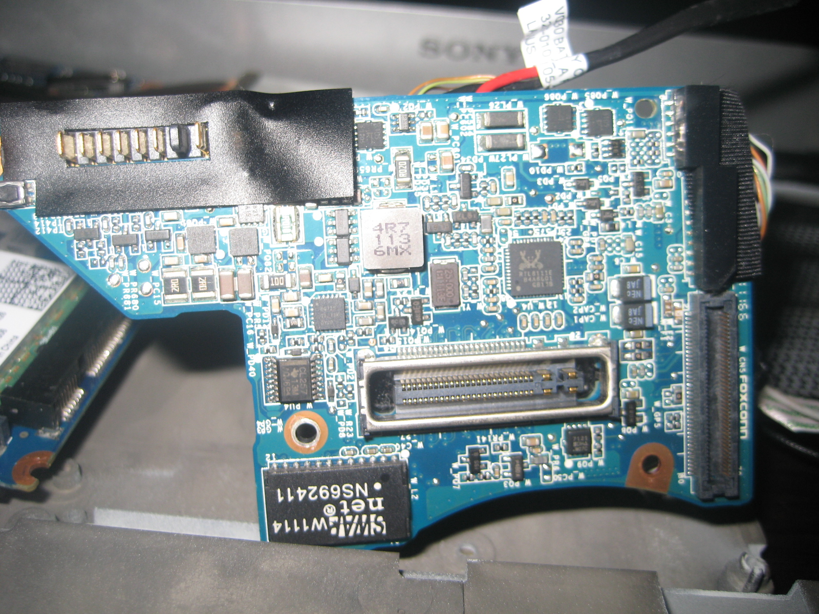

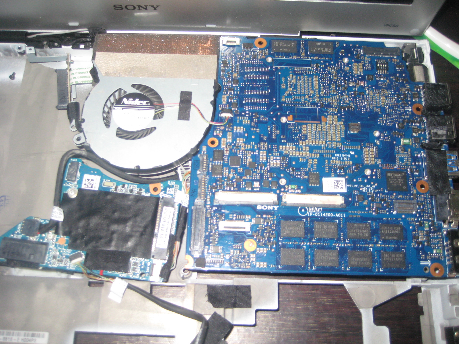

    Hi everyone,
    This laptop is an absolute nightmare, it goes through 4 logic boards from charger/battery to power button. I can't find schematics online, this makes it impossible for me to follow anything. Maybe you guys can help me out.
    The only thing I have working for me is that I have an exact same model working laptop to compare with. I have a big urge to replace board by board to figure out which board is busted and go from there but I'm afraid by doing this I bust both laptops..
    It's completely dead from the drop, but apparently nothing seems cracked, except the body near the battery fit. I get 19V at charger input and 3.3V in a couple battery pins, but battery is not charging, also, laptop doesn't boot on a charged battery. This is pretty much it. I've rechecked all connections and hit the hard reset button just to be sure, nothing worked and now I'm lost..
    Can you guys point me in the right direction?
    Thanks in advance.

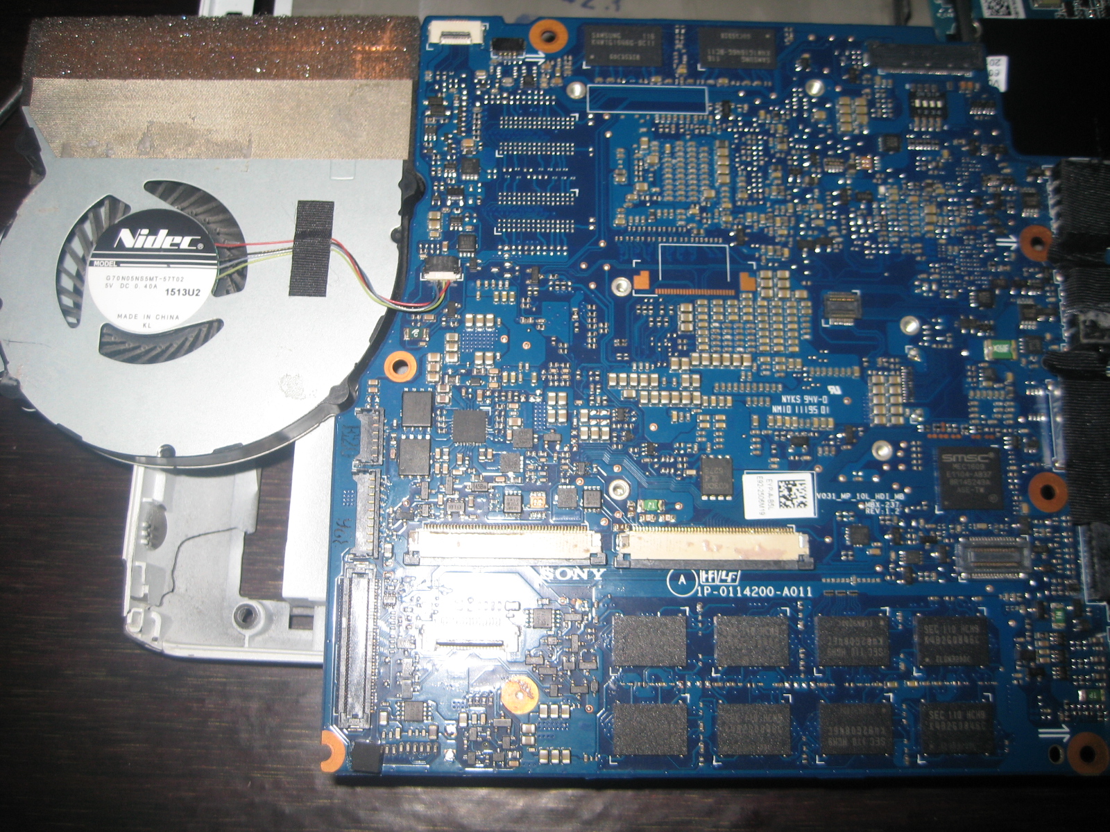

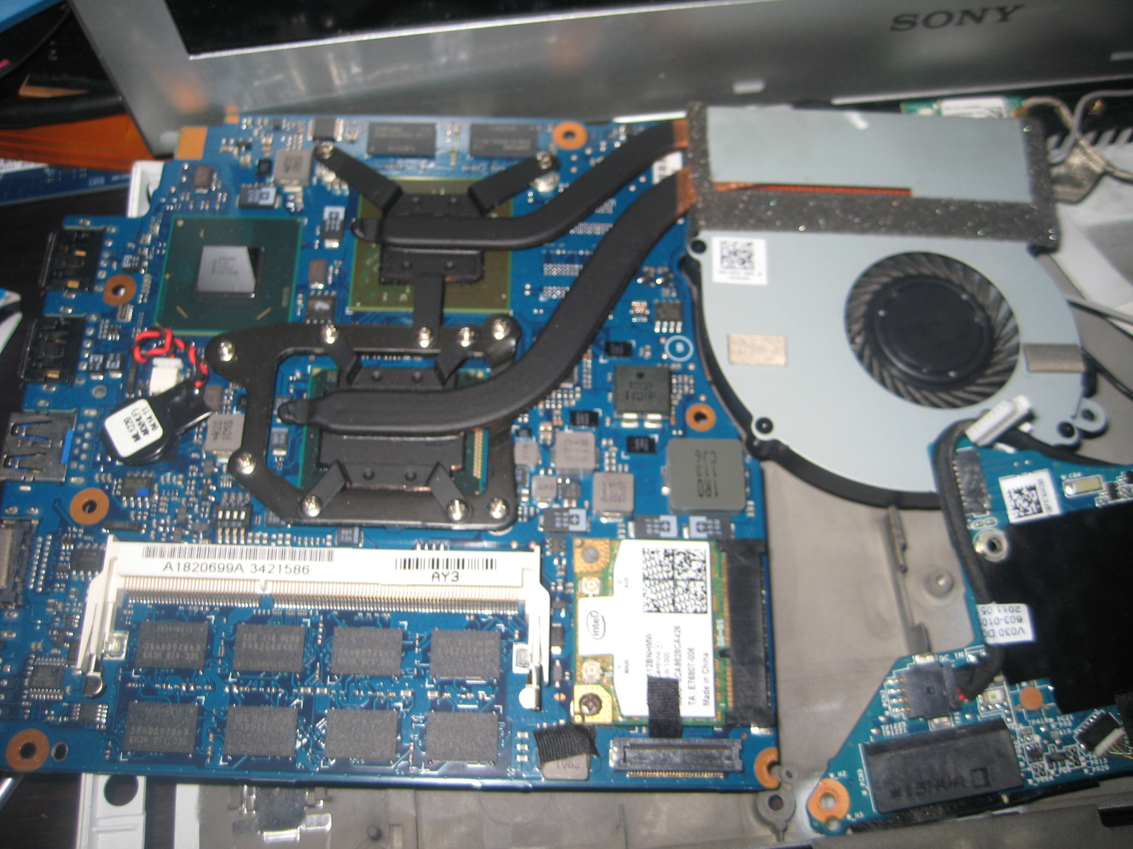

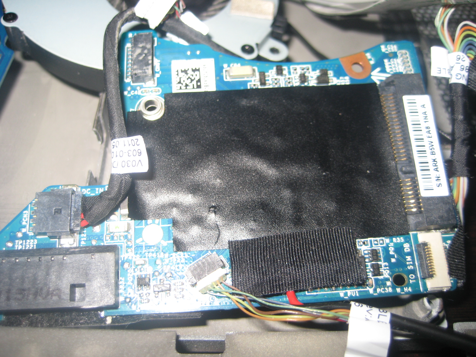

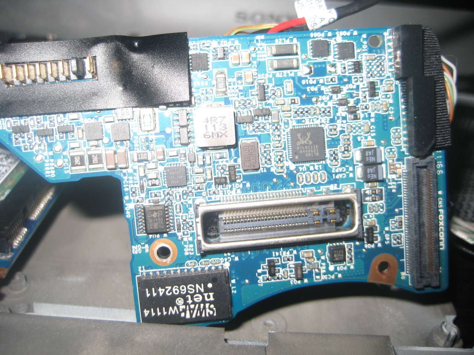

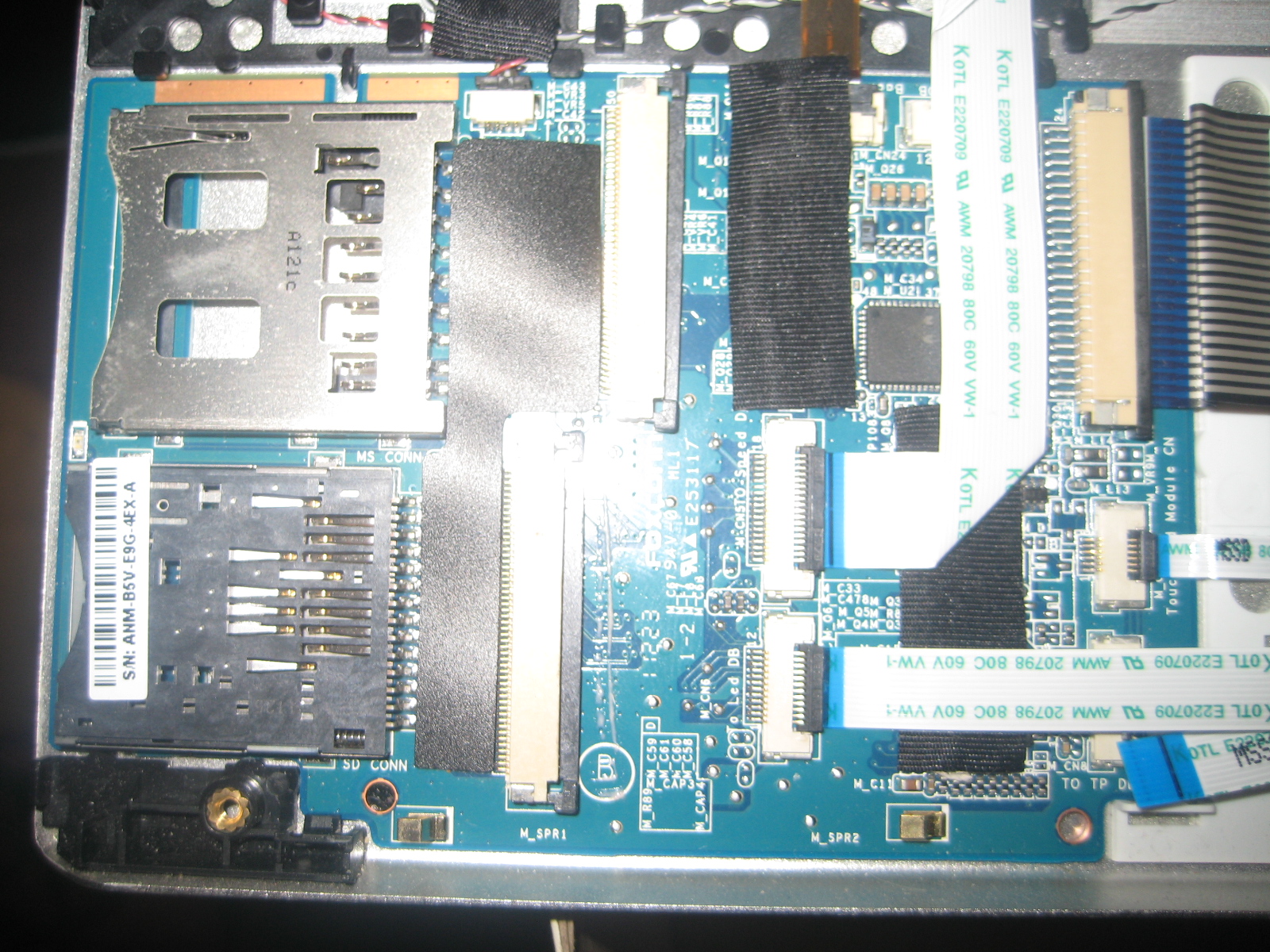

    Here's some photos..

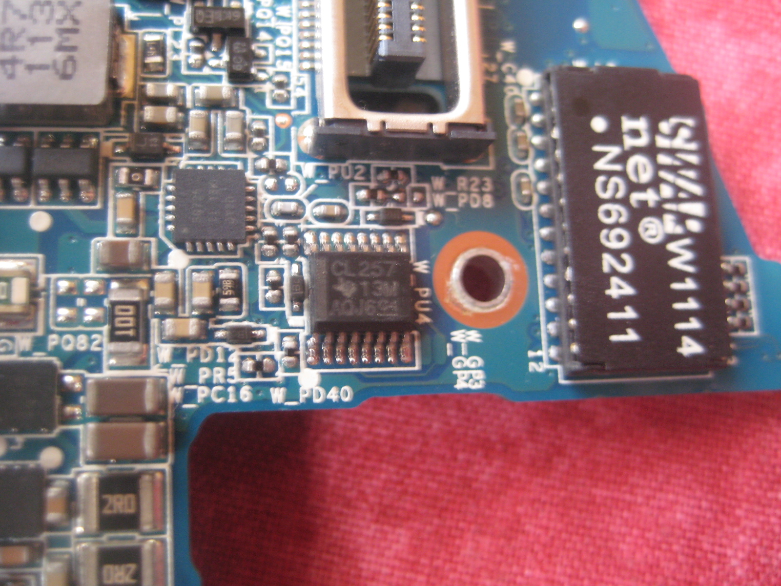

          Which is PU4 on your board? Why are you following the over voltage protection circuit when you say your problem was a drop down and not a short? Do you have 19V on pin 5 of PQ14 or better 3.3 and 5v on PL16 and PL17?
          • Learn2Day
            • Jun 2013
            • 254
            • Portugal
            Re: Vaio VPCSB2M9E/PCG-41218M dead after drop
            PU4 is a CL257 TI, PQ14 and PQ15 have only 3 pins, 0V in all.
            Can't find PL16 and 17, but i believe PL23 is where PL16 is suposed to be, it reads 1V.
            I wasn't following the over voltage protection circuit, I was following the charger input! That's why i think the schematics are not the same.
            Thanks.

                                  Hey guys,
                                  Today I got a new regulated power supply and I solved that shorted capacitor from the other thread. Now the main board is no longer shorted, but I still have no power...
                                  I think this short must have busted something else in the power board. Now I'm back to following this:
                                  atsio can you help me out?

                                      • atsio
                                        • Oct 2013
                                        • 819
                                        • Greece
                                        No the charger IC on the daughter board is BQ24725?
