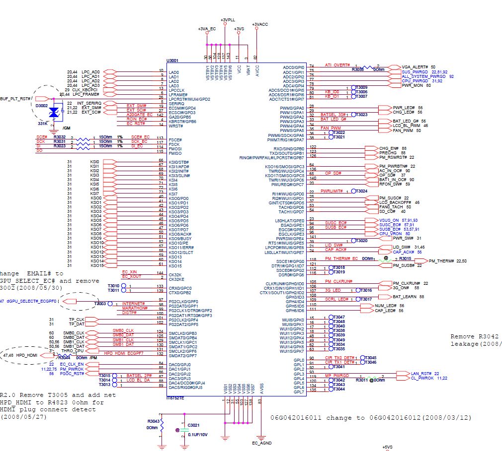

          Have a look from a schematic
          That is ITE 8572E in the schematic

                      So you actually meant VSUS_ON, also the schematic you gave me is wrong, I'm working in a IT8572E, the one you gave me is IT8752E.

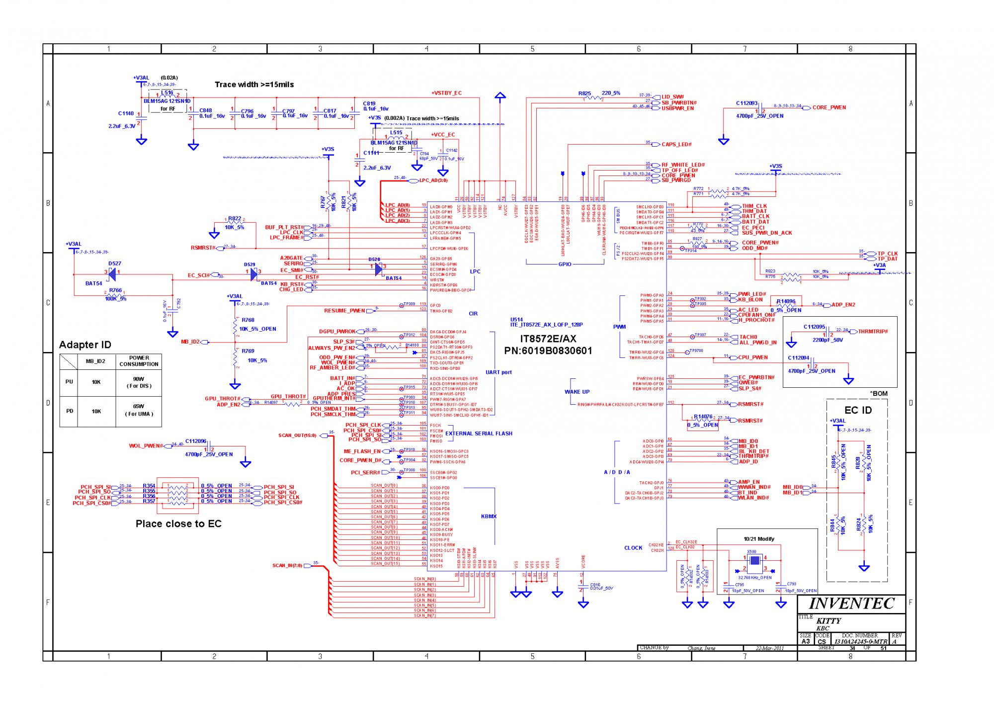

                        Found it!
                          Re: How does a KBC normally get its power?
                          Sorry, have a look at this https://cdn.badcaps-static.com/pdfs/...ae29ea474a.pdf
                            We found the same
