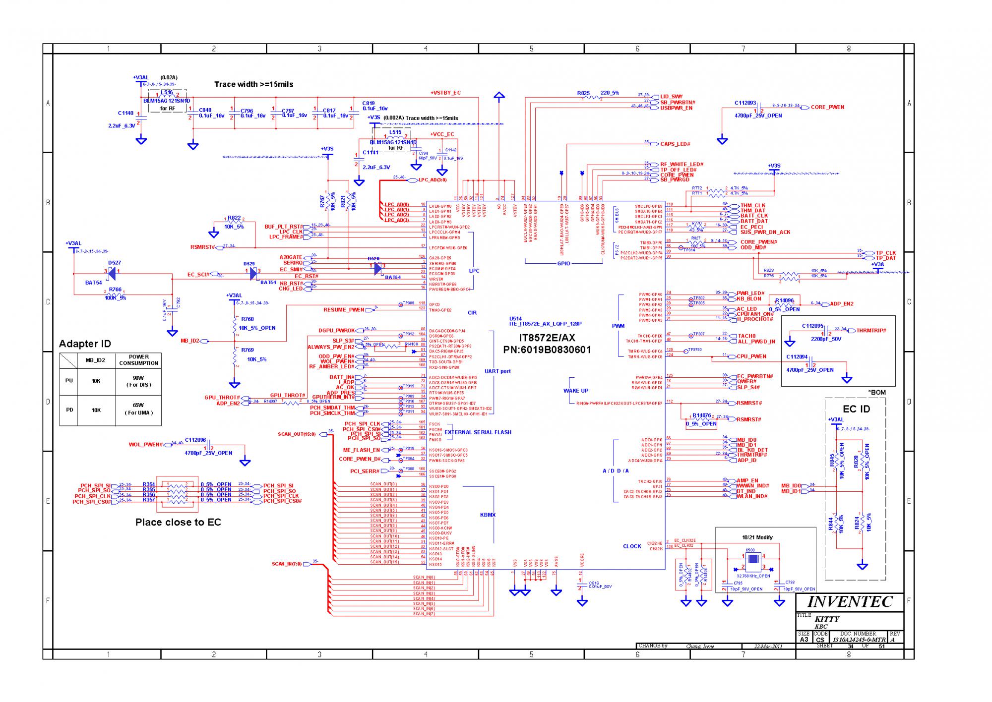

                              • orientalsniper
                                • Apr 2013
                                • 461
                                #35
                                Re: How does a KBC normally get its power?
                                If I'm not wrong pin #112 is RSMRST# according to attached schematic, it remains 3.3V even after pressing PWRBTN.

                                      #38
                                      see if this schematic is similar ?
                                      Not the same EC but at the end of schematic, there is an power sequence diagram
