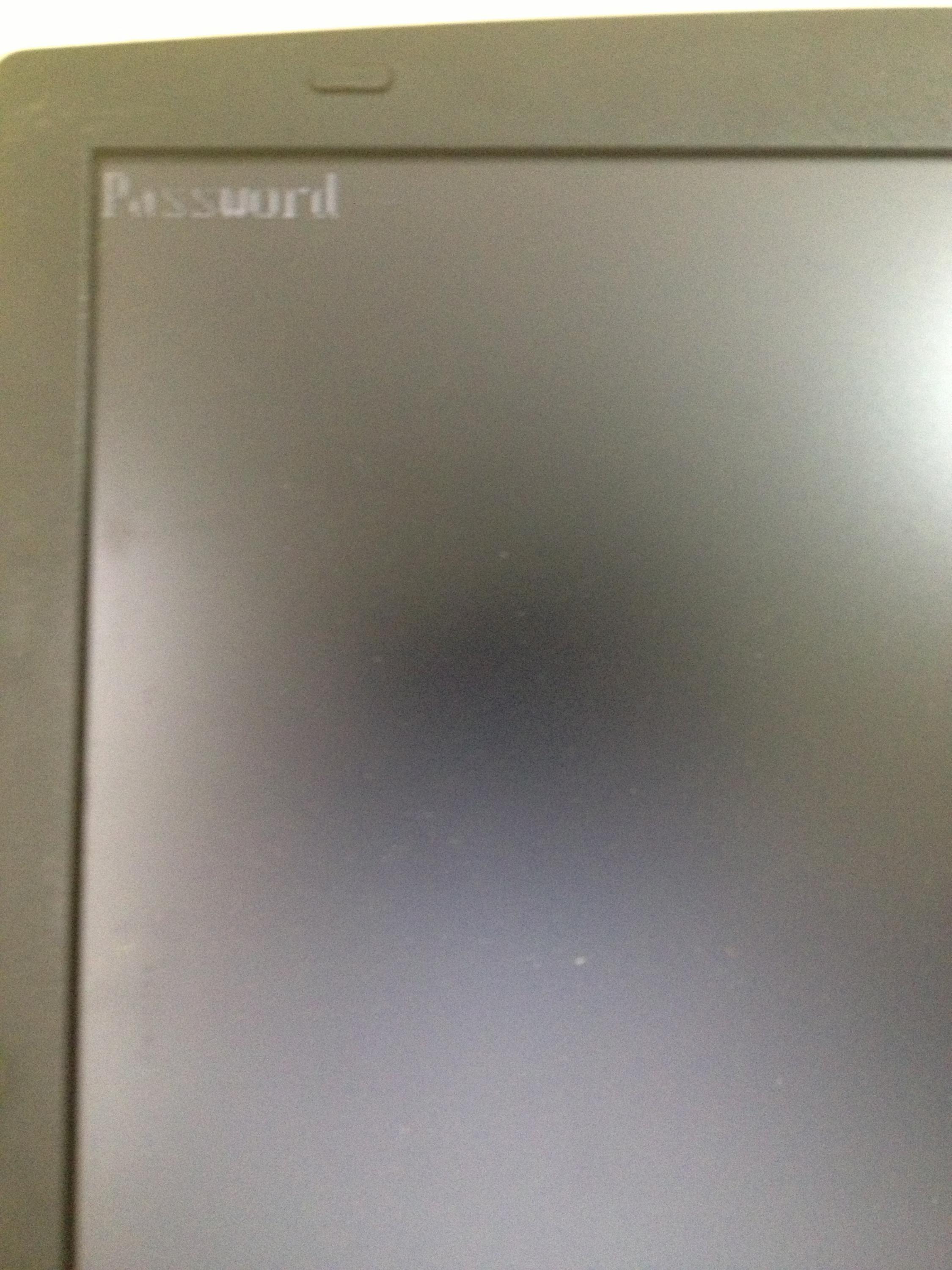

    Hey got this laptop today,
    locked with bios password,
    Serial NO. 14781442G
    At first boot it asks for a bios password
    no hash code available after 3 tries it just reboots,
    Any master bios passwords availabe for this model?

    Re: Toshiba PSA40E-0EWDE-G3 Password
    i guess no one knows this laptop,
    for my understanding, is the password written in the bios chip?
    so maybe i will search for a replaceable bios chip?

      also found this tool,
      http://www.ebay.com/itm/BIOS-Passwor...item3f155cfa71
      anyone ever tried it before?
      i think it looks like this
      http://manalalaku.wordpress.com/hardware-repair-centre/
      i will try to find an old parallel port cable make the tool and update...
        have you looked in memory compartment, for the b500 or xxx jumper that many Toshibas have
          hey trebo,
          no i didn't check, (dont know this method)
          besides this old thing doesn't have a memory compartment,
          i will have to take the keyboard out, to find the memory slot.
          im not rulling it out because i need to replace the hinges also both are broken.
          so if i won't make it with the plug, i will search the jumper you said.
              Good news,
              I've bulid the cable configuration as written in this page,
              http://www.laptop-repair.info/toshib..._password.html
              and now the bios is unlocked!!
