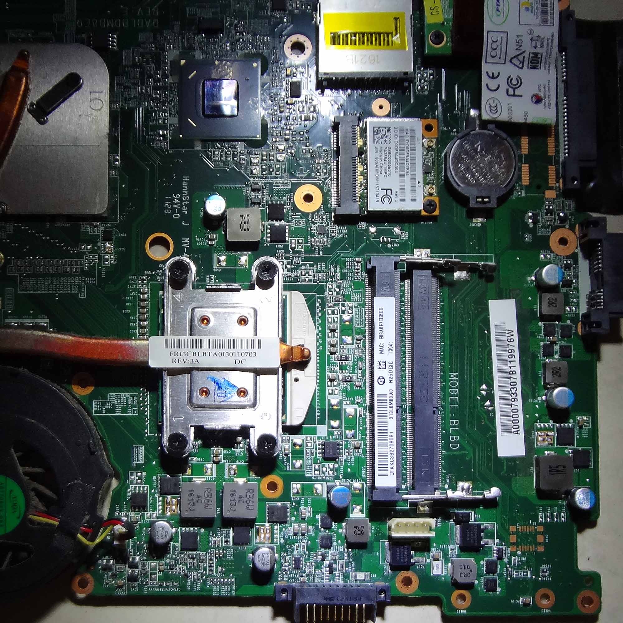

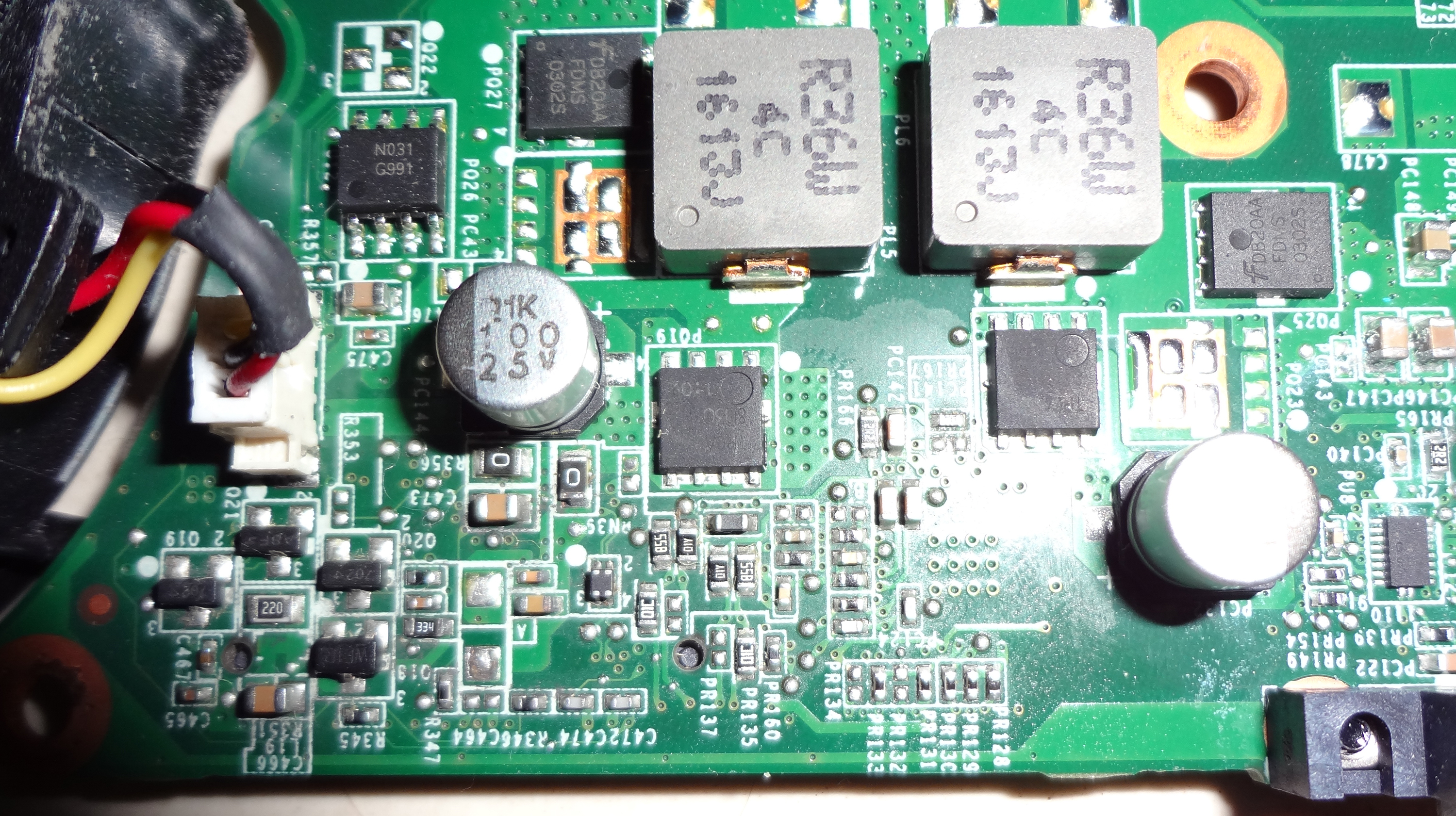

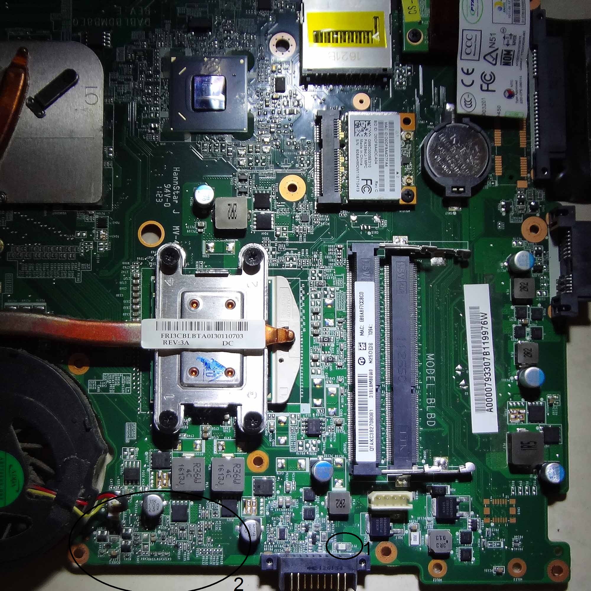

    Hi all.
    I have a Toshiba Sattelite L750 (part no. PSK2YA-04P028) with no backlight. I have tested it with an external display which was fine. I have also tested it with another LED panel and cable which gave the same dim display with no backlight.
    I suspect that it is a blown fuse on the motherboard but I cant locate it.
    I have attached a couple of pics of the motherboard.
    If anybody would be kind enough to identify the culprit(s) for me it would be very much appreciated.

    Re: Urgent help needed locating LED fuse on Toshiba L750
    check the inverter

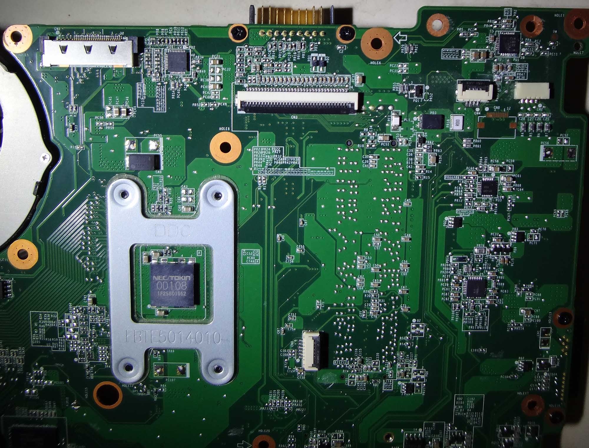

      Other side of board.
      Any help would be great cheers

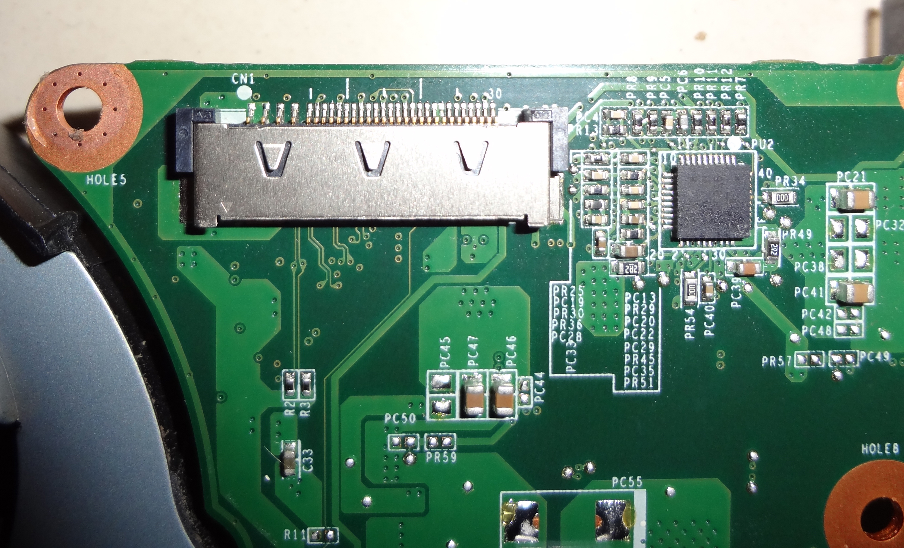

            Originally posted by Revrecords
            Hi all.
            make a macro picture of the LCD connector

              Locate R858, that should act as fuse for BL voltage.

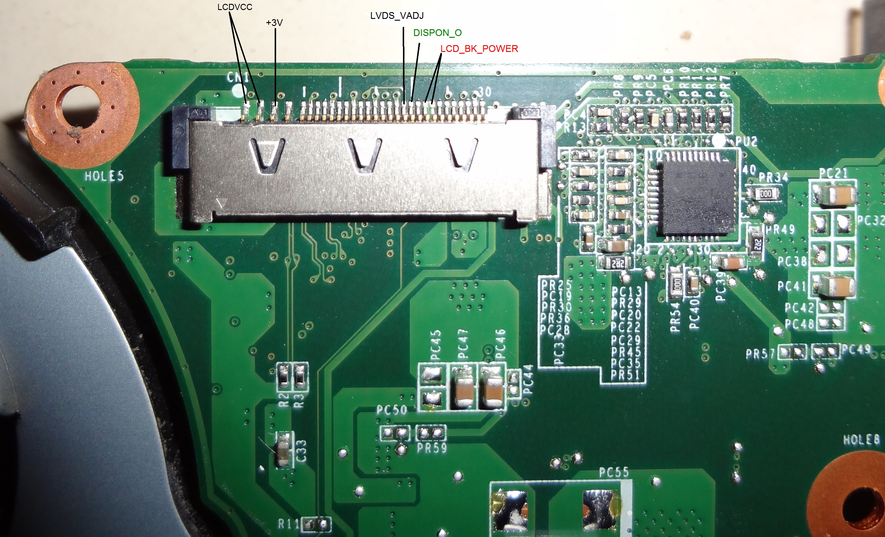

                Thanks for the reply dj. This pic ok?

                  Thanks khaahk. Im not having much luck finding R858 though. Any idea roughly where it might be located?

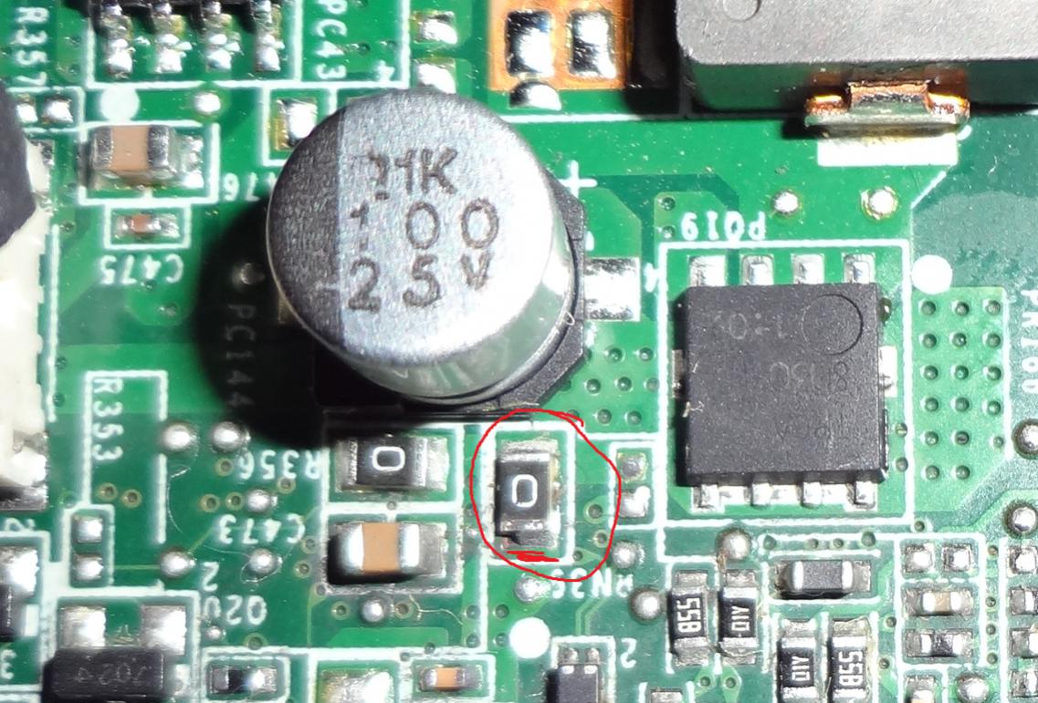

                    circle nr1 thats PF2 that`s a fuse- Go! check it
                    circle nr2 macro pic so we can see better.
                    p.s. we assume that you change the cable and screen...right?
                    nvm that bat+ fuse ... just check it

                    • dj_ricoh
                      • Jan 2013
                      • 2073
                      • uk
                      check the voltage on all the pin i show you and post back
                      cable connected and lcd with power (live)
                      be careful!!

                        Heres the macro pic of nr2.
                        About to check the fuse etc. now. Will post results asap.
                        Thanks heaps for your help mate
                          be careful!!
                          Test results:
                          LCDVCC = 0v (both points)
                          +3v = 3.2v
                          LVDS_VADJ = 2.92v
                          DISPON_O = 0v
                          LCD_BK_POWER = 18.84v (both points)
                          PF2 fuse = 0ohms
                          Again, your helps very much appreciated dj
                          • khaahk
                            • Dec 2013
                            • 812
                            • Estonia
                            Without LCDVCC you shouldn't even have picture on panel.
                            If LCD_BK_POWER is 18V, then there is no fuse problem.
                            Either you have LID switch faulty or dead EC.
                            How did the problem start? Did somebody change the screen with battery connected?

                              what voltage do you have on that fuse on both sides?

                                No. A glass of water was spilled on it. It was closed at the time, but from what I can tell some of the water got into the internals through the hinge gaps. It wasn't much, but enough to cause some problems.

                                  I think you got water damage in that place.

                                    No!
                                    i think its from the flash

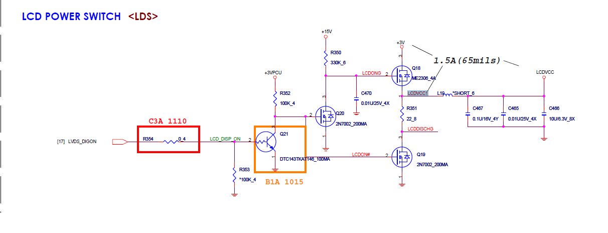

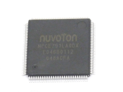

                                      lets start!
                                      NPCE791LA0DX U7 pic1 PIN 6 its DISPON_O -voltage
                                      and pic 2 - find Q18 on the motherboard and post the voltage.
                                      we will go from there.
                                      did you try another screen or test your screen another notebook?
                                      cable ?
