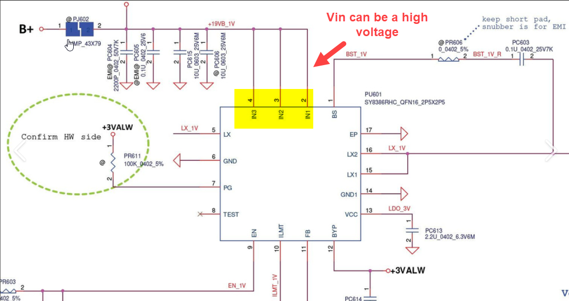

        PU6001, pin 2-3-4 are ties together and should be 19V as its VIN. Read diagram /datasheet carefully before proceeding.. What's the resistance to GND on FV1,pin1/pin2?

              • mon2
                • Dec 2019
                • 14659
                No, no. This is Vin. This is a high voltage Vin regulator that is capable of accepting such a high voltage and lower it down to whatever. A buck regulator.
                If the part is heating up, remove all power -> measure the resistance to ground of the output rails. If there is a low resistance to ground, then something is shorted on the rail and causing an excessive load and heating up this part.
                See attached.
                Measure the resistance to ground of pins 15 / 16 (they are tied together so either is ok). What is the measurement?

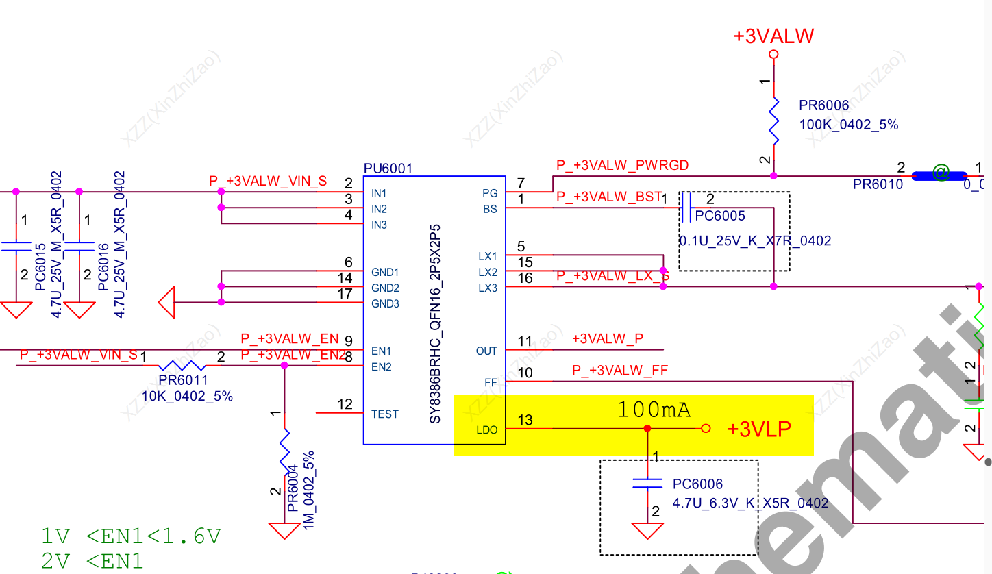

                        Forgot to ask about pin 13 = 3v LDO rail. The pins 15/16 are switching rails. What is the resistance to ground of pin # 13?
                        • Nagyesz
                          • May 2024
                          • 124
                          • Hungary
                          I missed it... 13 pins is 4.6 Ohms.
                          • mon2
                            • Dec 2019
                            • 14659
                            Ouch. Remove the cap that should be on this line and then measure the resistance to ground again. Everytime, without power of course to the board. Perhaps this local cap is shorted.

                                • 14659
                                PC6006. The other appears to be PCB trace / solder blob short / jumper. Concern if this rail is powering the EC controller which will be the device that controls your keyboard and other low level functions. Confirm if the PJ6003 is a solder blob. If yes, after removing PC6006, then can review the balance of the loads on this power rail. This LDO is a low current rail so only a few components can be powered by this internal regulator. Someone is shorted here and most likely causing the heat up of the regulator.
                                Excellent - first remove the capacitor. Then test again if the resistance is higher. Only if required, remove the solder blob @ PJ6003. Then we will know which area of this rail is shorting.

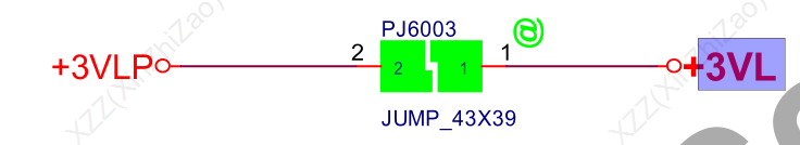

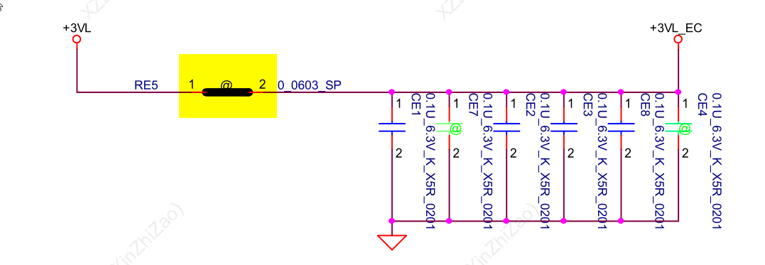

                                      • mon2
                                        • Dec 2019
                                        • 14659
                                        Ok - may have found a gold mine. Maybe. Downloaded the above linked BV file and unable to load it with my viewers. Checked my (paid) database service and they do not offer the same BV file but found the BV & schematics for the NM-D521 board. This board appear to be very similar.
                                        Do you have access to the NM-D521 schematics? This rail does travel all over the board but there are jumper solder blobs again to disconnect the EC power rail which is from this LDO. An alternate approach is to inject 1 volt onto this rail and check who heats up.
                                        ** DISCONNECT any IO cables; WIFI Card; Ethernet card and test again the resistance to ground. Each is powered from this low current rail.
