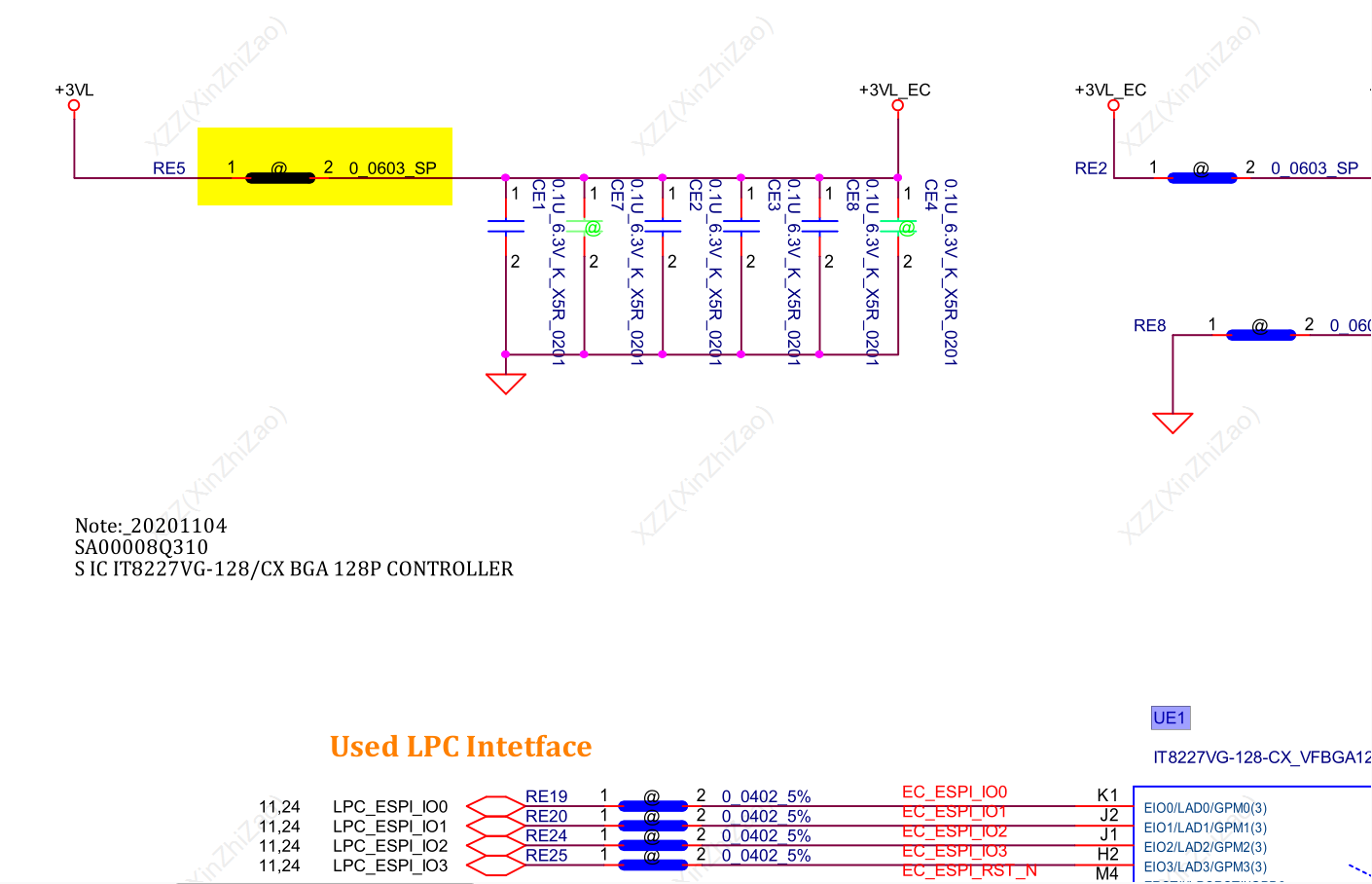

            Hunt for RE5. This should be a solder blob or a 0 ohm resistor. If you remove this 'short' then you will be removing UE1 from this common power supply as a load. Afterwards, test the resistance again to see if it is higher or not.
            Recommend to source IPA (pharmacy grade is recommended) alcohol as it is more pure. Then pour over the parts you suspect. The heat will make the IPA evaporate faster than the cooler parts.

              I'm sorry for asking again, I found the RE5 +3VL_EC is OL, while the +3VL is 4.6 ohms. These two are blob, how can I 'remove short', or what to do with the blob?

                Post a clear picture of RE5. From the schematic, this should be a short on the trace or a 0 ohm resistor. Either way, if this part is present, you should have 4R6 ohms on each test point.
                With no power to the board, meter in resistance mode. Place one meter probe on +3VL and other meter probe @ +3VL_EC. What is the resistance? It should be ~0 ohms (Not OL = over limit).

                  Not entirely, if is it RE5 (pic) is likely the pin 1 with 0.05 ohms to the PJ6003. However, pin 1 and pin 2 show OL to eachother when measured in 20k ohms.

                    #29
                    My bad. RE5 has '@' symbol = 'do not stuff' on these schematics so this part will not be populated.
                    Can you confirm that the WLAN card is removed from the long black socket in the above pic? If not, remove it and check if the short remains. The WLAN card is one of the loads on this same power rail.

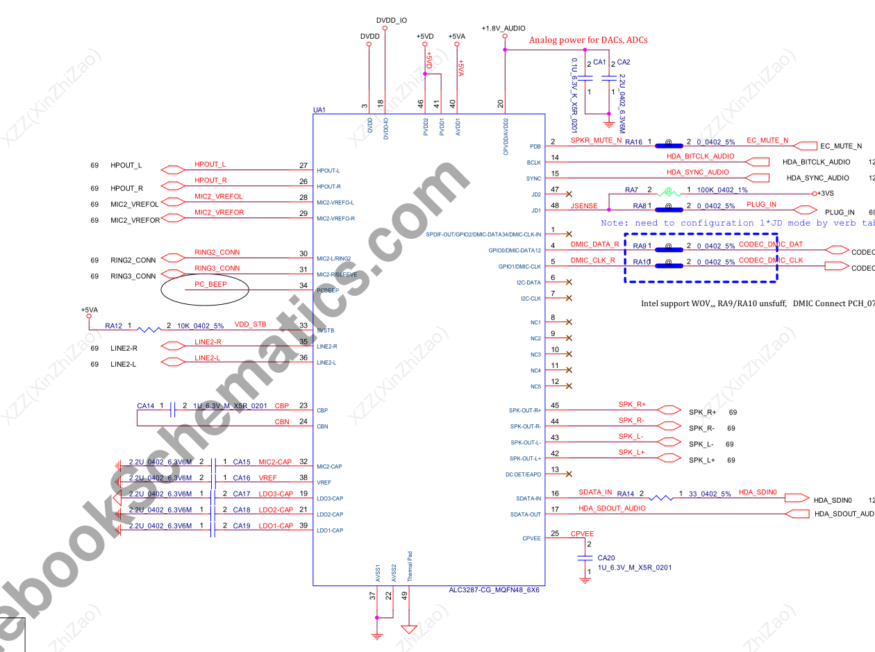

                        What are the topside markings on UA1? Share a pic. Is it the sound card IC = ALC3287?

                            Pic about the ic which was warming: (IT8227VG-128)
                            Also a pic about PJ6003, do I need to further remove everything?
