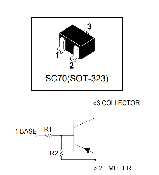

    Datasheet for the same transistor @ PQB28. Note the internal circuit and pin numbers - not matching what is showing in the schematic.
    LMUN5113T1G.pdf (lrc.cn)

      #42
      Hi Thanks,
      As requested, I touched up all 128pins of SIO chip. Then use continuity to ensure no pins were touching.
      Voltage to ground of Transistor PQB28 is as follows: Base 0.006v, Emitter 10.45v, Collector 10.37v
      Voltage to ground of Transistor PQB29 is as follows: Base 10.36v, Emitter 0.000v, Collector 0.000v
      Followed the orientation of the Transistors in the supplied datasheet.

                #47
                With reference to post #41, I mixed up the base and collector readings.
                Corrected readings are: Base (bottom left)=10.36v, Emitter (bottom right)=10.44v and Collector (top pin)=0.027v

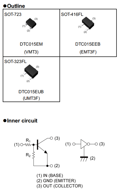

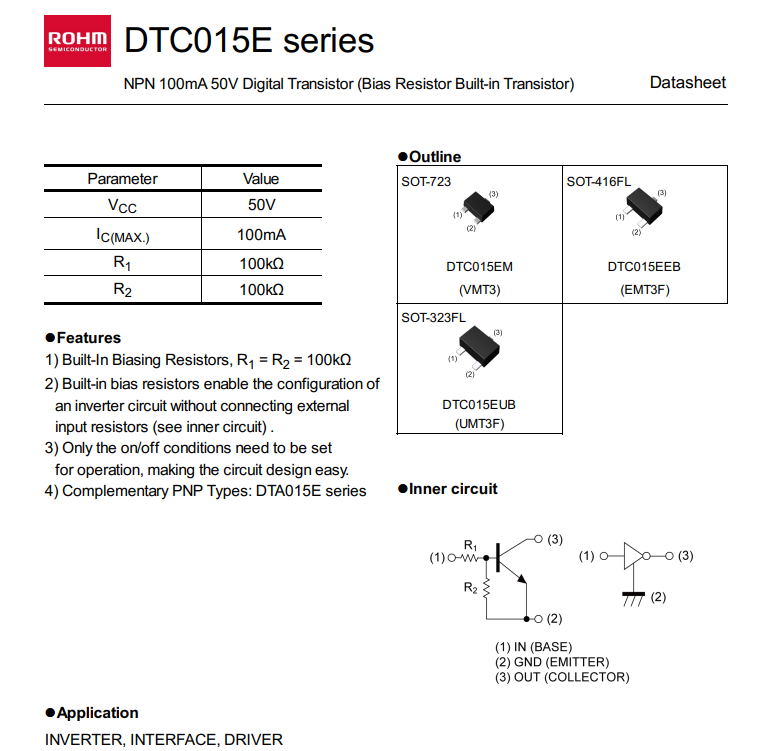

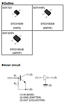

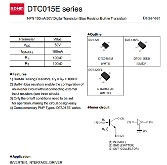

                  DTC015EUB - Data Sheet, Product Detail | ROHM.com​
                  Click image for larger version  Name:	zoom.png Views:	0 Size:	61.0 KB ID:	3340013
                  Click image for larger version  Name:	PQB29.png Views:	0 Size:	121.5 KB ID:	3340012
                  • mon2
                    • Dec 2019
                    • 14677
                    #49
                    Solder a piece of wire and connect one end to Base (bottom left) on PQB28.
                    Solder the other side of the same wire to Ground.
                    After you do this, do you see the battery voltage on the collector pin? What is the voltage? If you see the battery voltage on the collector pin, then the charger IC should be powered. Confirm it.

                      #50
                      Hi Thanks,
                      Voltage to ground measurements for PQB29: Pin1 (base)= 0.000v, Pin2 (emitter)=0.000v, Pin3 (collector)=9.60v

                        #51
                        Ground the pin 3 on PQB29 = base for PQB28. This action should allow for the battery voltage to travel onto the collector of PQB28. Confirm it.
