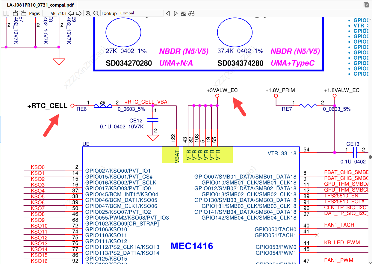

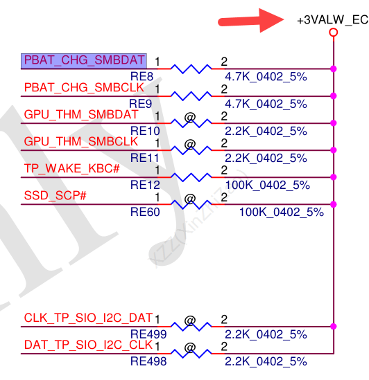

    See attached. The pins you just referenced are SMBUS signal lines. These same signals are mated with pull-up resistors @ RE8 and RE9.
    Measure the voltage to ground on each side of these resistors to confirm if we indeed have the pull-up voltage or not.
    If you have +3VALW_EC present at the RE8 and RE9 resistors then the EC should be powered. Confirm the RTC_CELL voltage as well.

      If I'm correct, I measured the voltage to ground of the resistors in line with pins 8 & 9 of EC chip.
      Got 3.3v on either side of both resistors. RTC_CELL voltage on pin 122 of EC is 3.079v

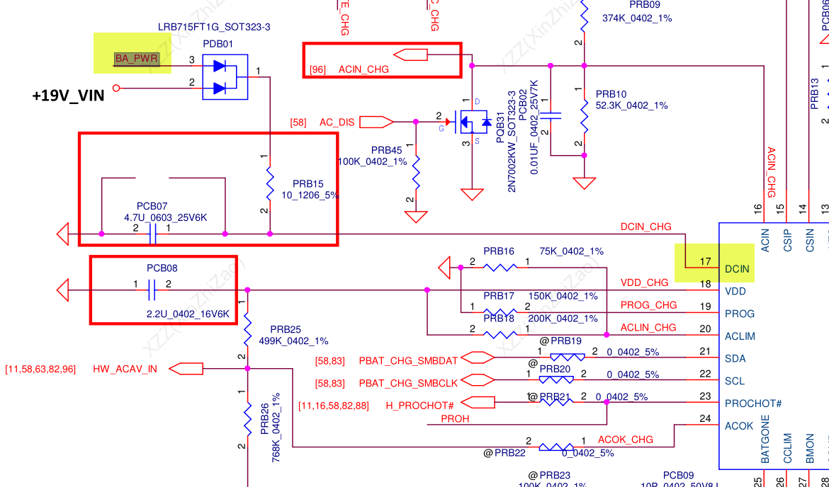

                    #29
                    Carefully measure the voltage to ground of each pin on the charger IC at PUB01. Post the table o measurements along with their pin and function labels. Important ones include to check the VCC pin to confirm the charger IC is being powered when using only the battery. Others including PSYS are of interest.
                    • lawrenceptrini

                          #32
                          See a few issues:
                          17 DCIN 0.002
                          30 PSYS 0.000
                          Locate the dual diode @ PDB01. Measure the voltage to ground on each pin.
                          Locate the resistor at PRB35. Measure the voltage to ground on each pin of this resistor. Remove all power. Measure the resistance of the resistor @ PRB35 in ohms. This resistor should be ~100 ohms when measuring across pins 1 & 2. Respectively, the battery voltage should be present on pin # 2 (after this 100 ohm resistor).

                                  #36
                                  Then PSYS cannot be 0v. Confirm this measurement:
                                  30 PSYS 0.000

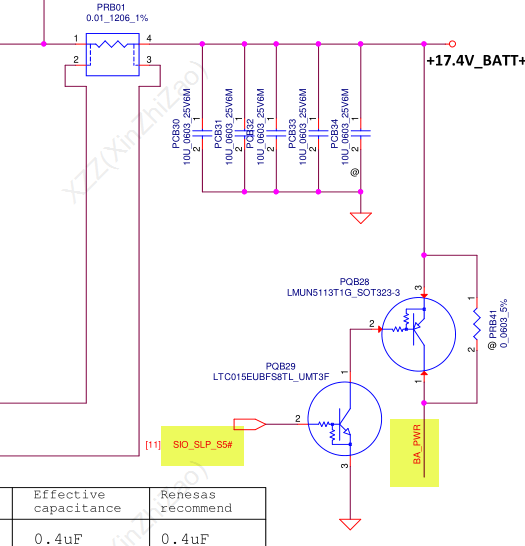

                                        #39
                                        The charger IC is not being powered when using the battery only. See the voltage to ground on pin # 17 = 0v.
                                        The voltage is fed through the dual common cathode diode PDB01 where BA_PWR should be the voltage feed from the battery and +19V_IN is the voltage from the power adapter. If either voltage source is present, the charger IC will be powered.
                                        We know the power adapter leg is fine but battery side is not working.
                                        Review the voltage to ground on each pin of:
                                        PQB28
                                        PQB29
                                        To me, the pin # on the drawn schematic symbol is not correct. Does not match the datasheet for each of these transistors. Measure the voltage to ground and use the pin # they show in the schematic for a review.
                                        What should be happening is that when the power adapter is absent and only the battery is the source, then BA_PWR should offer the battery voltage to power the charger IC.
