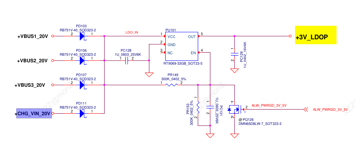

      Before I was using the JUSBC2.
      I do not have the battery connected and I believed it is completely discharge
      • mon2
        • Dec 2019
        • 14677
        #83
        With this setup, what is the voltage to ground of pin 5 on PU101?

          #84
          Voltage to ground of pin 5 on PU101 is 3.294VDC

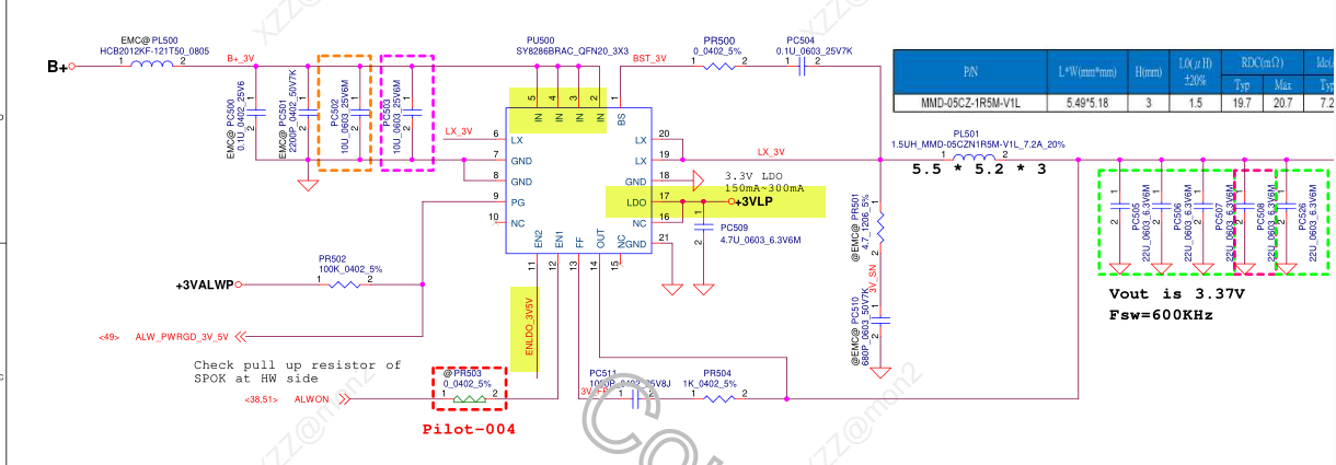

                    #89
                    Measure the voltage to ground of the following on PU501:
                    Vin pins 2-3-4-5 ; any of these is ok
                    EN2 pin 11 ; ENLDO_3V5V
                    LDO pin 17 ; 3VLP LDO rail
                    Post each measurement.

                      #90
                      Thanks mon2 below are the voltages on
                      PU501:
                      Vin pins 2-3-4-5 = 8.38VDC
                      EN2 pin 11 = 4.087VDC
                      LDO pin 17 = 3.354VDC

                        What is the voltage to ground of:
                        ALWON ; mated with EN1 pin # 12 and is driven by the EC
                        Remove all power. Meter in resistance mode.
                        What is the resistance in ohms to ground of PL501 (either side of this inductor is ok).
                        • waakye
                          • Dec 2018
                          • 340
                          • Electronada
                          #92
                          mon2
                          Voltage to ground on pin # 12 of PU501 = 0VDC
                          Meter in resistance mode of PL501 = 31 OHMS
                          • mon2
                            • Dec 2019
                            • 14677
                            #93
                            Sorry. My bad. Getting the PU501 mixed with PU500.

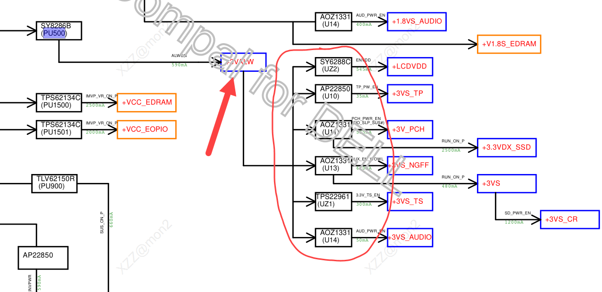

                            Do share the voltages and resistance checks on PU501 as well which are linked to the +5VALWP and +5VALW rails.
                            PU500 is linked to PL501 = +3VALWP = +3VALW. Is this PL501 @ 31 ohms to ground? This is of concern as this is a low resistance.
                            Review the block diagram on where the voltage from PL501 travels.
                            Each load / target is a suspect. Someone is (partially) shorted on this rail.
                            Start with the load switch @ U11. Inspect for damage. The part should be large enough to flux and remove. Keep track of pin # 1 orientation. Concern of course is that this load switch powers the PCH. Someone most likely downstream consumed too much current for whatever reason and perhaps killed the load switch in the process. If comfortable, flux and remove this part and test the resistance to ground again. Do not power up without the part. We are only hunting for the defective next stage part that follows the +3VALW power rail.

                              mon2 below are the measurements
                              Voltages and resistance checks on PU501
                              Resistance to ground in Ohms
                              Pin1=OL
                              Pin2=0.718M
                              Pin3=0.693M
                              Pin4=0.678M
                              Pin5=0.649M
                              Pin6=79K
                              Pin7=0.1
                              Pin8=0.1
                              Pin9=OL
                              Pin10=OL
                              Pin11=488K
                              Pin12=12.0
                              Pin13=OL
                              Pin14=104K
                              Pin15=0.681M
                              Pin16=OL
                              Pin17=600K
                              Pin18=0.1
                              Pin19=60K
                              Pin20=60K
                              Voltage to ground in VDC
                              Pin1=2.925
                              Pin2=8.38
                              Pin3=8.38
                              Pin4=8.38
                              Pin5=8.38
                              Pin6=0
                              Pin7=0
                              Pin8=0
                              Pin9=0
                              Pin10=0
                              Pin11=4.1
                              Pin12=0
                              Pin13=0
                              Pin14=0
                              Pin15=5
                              Pin16=0
                              Pin17=3.3
                              Pin18=0
                              Pin19=0
                              Pin20=0
                              PL501 is 31 Ohms to ground. measuring across is 0.1 ohm
                              U11 voltage to ground
                              pin1 to 4 =0VDC
                              pin5 = 0.450VDC
                              pin 6 to 14 = 0VDC
                              U11 Resistance to ground
                              pin1 to 4 =OL
                              pin5 to 7 = OL
                              pin 8 = 0.3
                              pin9 = 0.3
                              pin10=48M
                              pin11=0.1
                              pin12=48M
                              pin13=0.4
                              pin14=0.2​
                              • mon2
                                • Dec 2019
                                • 14677
                                #95
                                The PCH (CPU) may be shorted. Confirm the resistance to ground on pins 13 / 14 of U11. This is a very low resistance to ground.
                                Next, flux and remove U11. Then measure the same points to ground again.
                                • waakye
                                  • Dec 2018
                                  • 340
                                  • Electronada
                                  #96
                                  removed U11 and measure pin 13 and 14 to ground and I am reading 0 ohms. I guess it is a no fix. Thank you so much mon2. I really learn a lot from you and this amazing website. Thanks everyone that helped.
