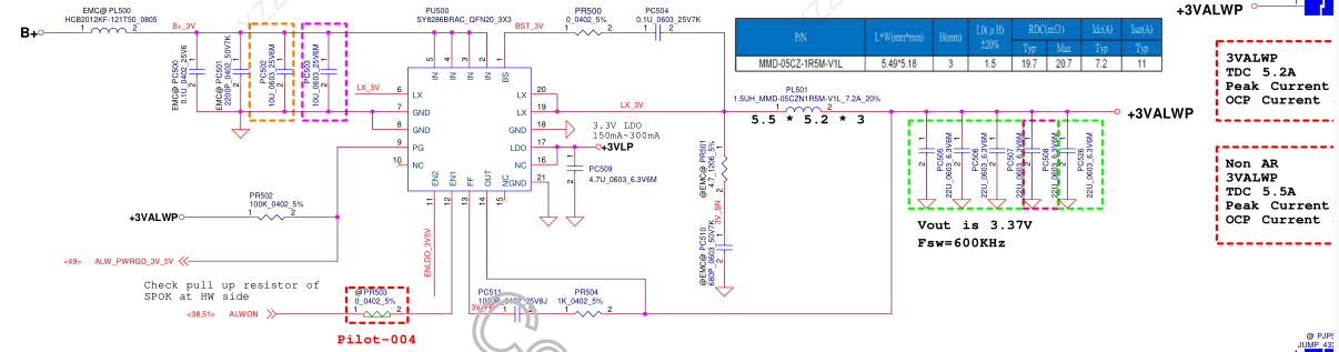

                    So you are missing +3VALW. This rail is created by PU500.
                    Review the voltage to ground measurements of PU500. Confirm the LDO rail @ pin 17. Enable voltages on pin 11 and pin 12?
                    Click image for larger version  Name:	PU500.png Views:	0 Size:	126.8 KB ID:	3471963

                      Hey mon2,
                      Voltage measurements on PU500
                      Pin 17 = 0VDC
                      Pin 11 = 0VDC
                      Pin 12 = 0.266VDC
                      Thanks​

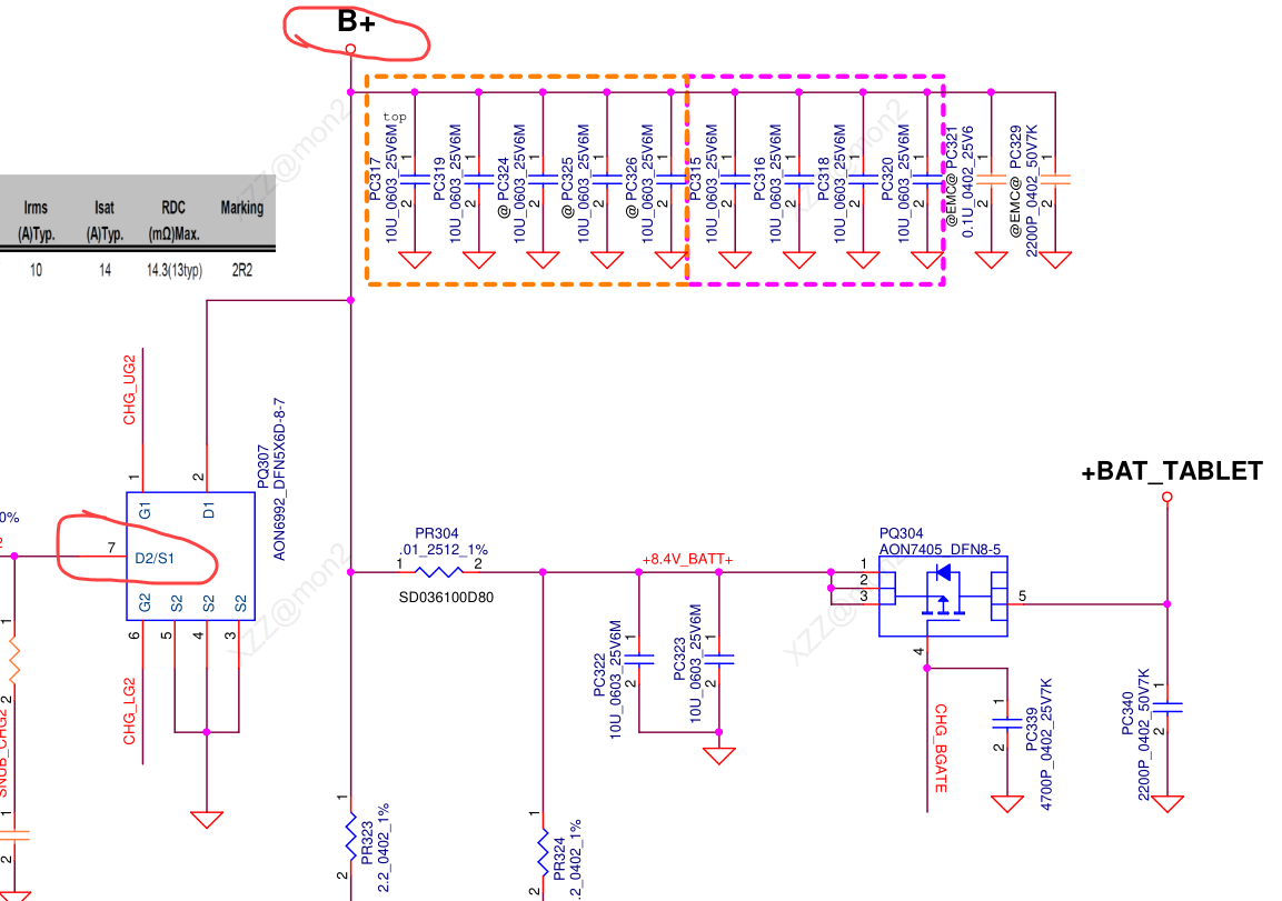

                            Connect the battery and confirm the voltage on the same pins 2-3-4-5 again.
                            Review the DCin power path mosfets that are from the power adapter. See the circled pins. What is the voltage to ground?

                              Battery connected pins 2-3-4-5 reads 0.004VDC
                              PQ307 pin 7 measures at PL301 pin2 = 0vdc
                              PQ307 pin 2 measures at PR304 pin1 = 0.003vdc

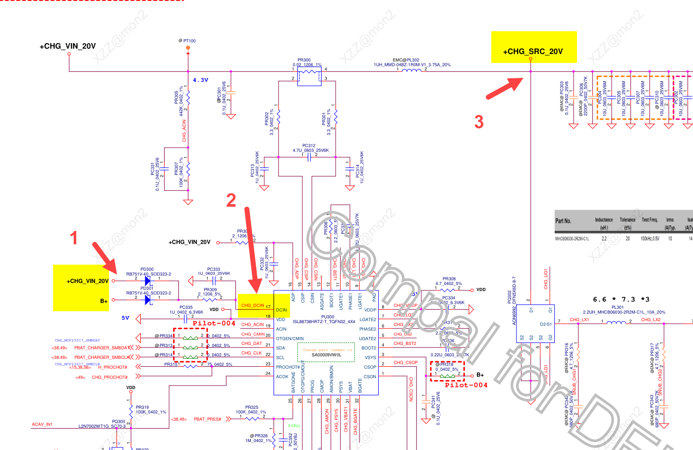

                                    Measure the voltage to ground of the highlighted points of interest.

                                      Voltage to ground
                                      PD300 pin 2 = 0.015vdc
                                      PU300 pin 17 = 0.0015VDC
                                      PL302 pin 2 = 0.005VDC
                                      PD301 pin 2 = 1.1VDC

                                        #79
                                        Determine which usb type-C connector is being used by the power adapter. This power path will lead to 2 x DCin mosfets. Which mosfets are in this path to the charger IC? The mosfets in the middle are not being enabled. From the earlier reviews, you also do not have 20v from the power adapter which is of concern.

                                          using JUSBC1 PORT
                                          Voltage to ground
                                          PD300 pin 2 = 4.730VDC
                                          PU300 pin 17 = 8.03VDC
                                          PL302 pin 2 = 4.730VDC
                                          PD301 pin 2 = 8.38VDC​
