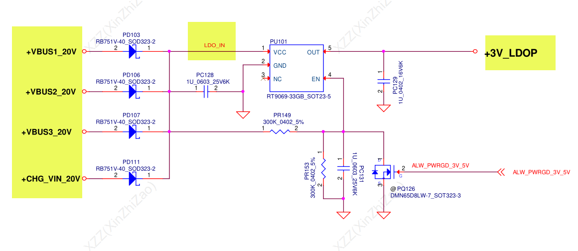

                        See attached. Check if you have a voltage of ~3v on pin 5 of PU101.
                        If not, proceed to check the voltage to ground of the yellow highlighted input rails on the left side of this partial schematic.

                          #32
                          Pin 5 of PU101 reads 3.27V.

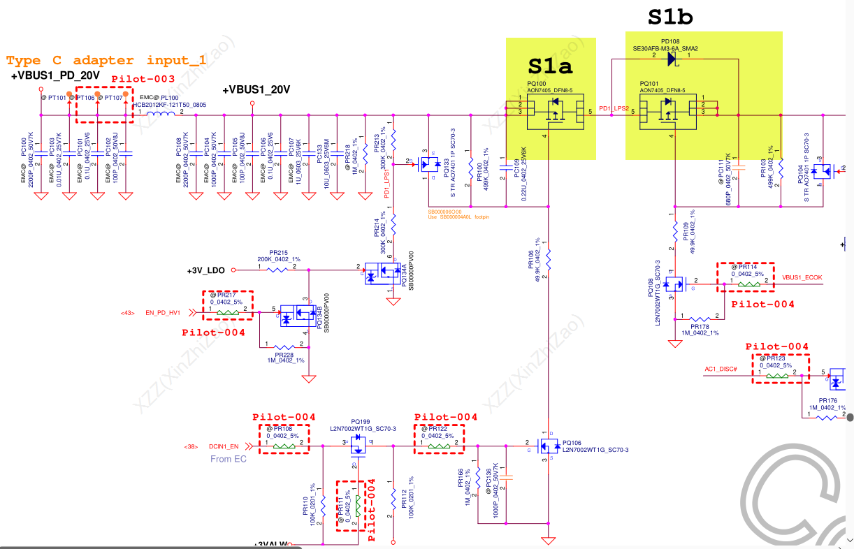

                            Each USB Type C connector is mated with 2 x DCin mosfets in its power path. Select the USB Type C connector you are using -> measure the voltage to ground of the 1st Dcin mosfet - measure the source (1-2-3); gate (4) and then drain (5-6-7-8) to ground voltage.
                            Repeat for the 2nd DCin mosfet.
                            Be sure to use only the mosfets that are in the path of your USB C connector used by the adapter. At this time, one or both of these DCin mosfets are not enabling to supply the same +5 volts onto the B+ pin.
                            Example power path is attached.

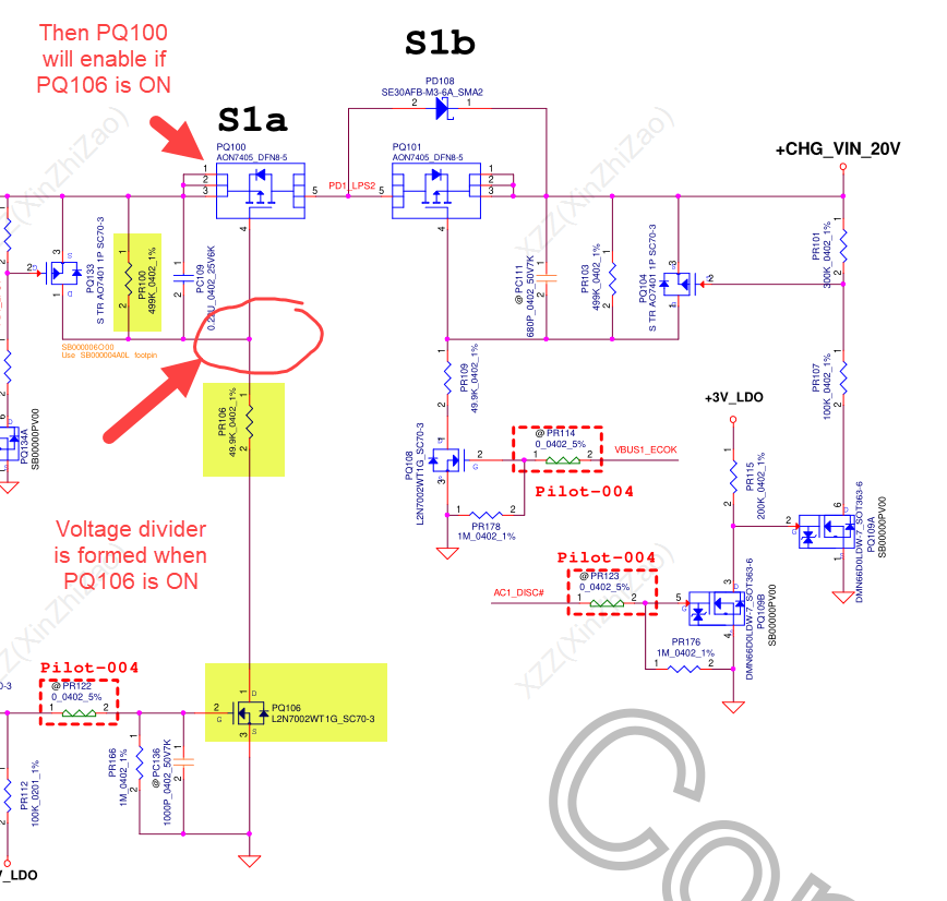

                                Each of these DCin mosfets are P-channel type. If the gate voltage is lower than the voltage being passed through the source / drain pins, the mosfet will enable. Yet, the drain pins (5-6-7-8) are each at 0v on each of the first DCin mosfets.
                                Remove all power. Meter in resistance mode. Measure the resistance to ground of CHG_VIN_20V. What is the resistance in ohms? Checking if there is a shorted part on this main power rail.
                                If the resistance is normal and not too low, then proceed to test the same mosfets above but using resistance mode checks.
                                Measure the resistance across:
                                source (1-2-3) & drain (5-6-7-8)
                                source (1-2-3) & gate (4)
                                gate (4) & drain (5-6-7-8)
                                Post each measurement in ohms.

                                    #37
                                    These measurements look ok. They are not low values so not shorted.
                                    Suspecting the gate voltage of the above mosfets from post # 34. Can you confirm them again.
                                    Given that the drain pin(s) are at 0V implies the mosfets are OFF so this means the gate voltage is most likely the same voltage as the source pins = ~5v.
                                    Not clear as to why the gate voltage is at 0v. What should happen is that when these mosfets are expected to be ON, then PQ106 will enable (as an example).
                                    When PQ106 is enabled, the resistor at PR106 will be connected to ground. When this occurs, resistors PR100 & PR106 form a voltage divider to lower the Vin from the power adapter (~5 volts at this time) to a lower voltage and this lower voltage is presented onto the gate pin. For a P-channel, this is required and then the mosfet will enable due to the lower gate voltage.
                                    Confirm again if the gate voltage is truly at 0v but suspecting it will be ~5v to ground.

                                        #39
                                        Take a piece of wire and connect one side onto the gate pin # 4 of the mosfet. The other side of the wire to ground. This will force the gate voltage to be shunted to ground to force enable the mosfet. Apply onto any of the first mosfets of the above group. That is, the 5v on the gate pin is due to the pull-up resistor on each local mosfet and now you are forcing the P-channel mosfet to enable by shunting the gate to ground.
                                          #40
                                          I short the gate of the mosfet PQ100 pin 4 to ground.
                                          JUSBC1
                                          PQ100 pin 1, 2, 3 = 5V
                                          Pin 4 = .474V
                                          Pin 5, 6, 7, 8 = 5V
                                          PQ101 pin 1, 2, 3 = 5V
                                          Pin 4 = 5V
                                          Pin 5, 6, 7, 8 = 5v
