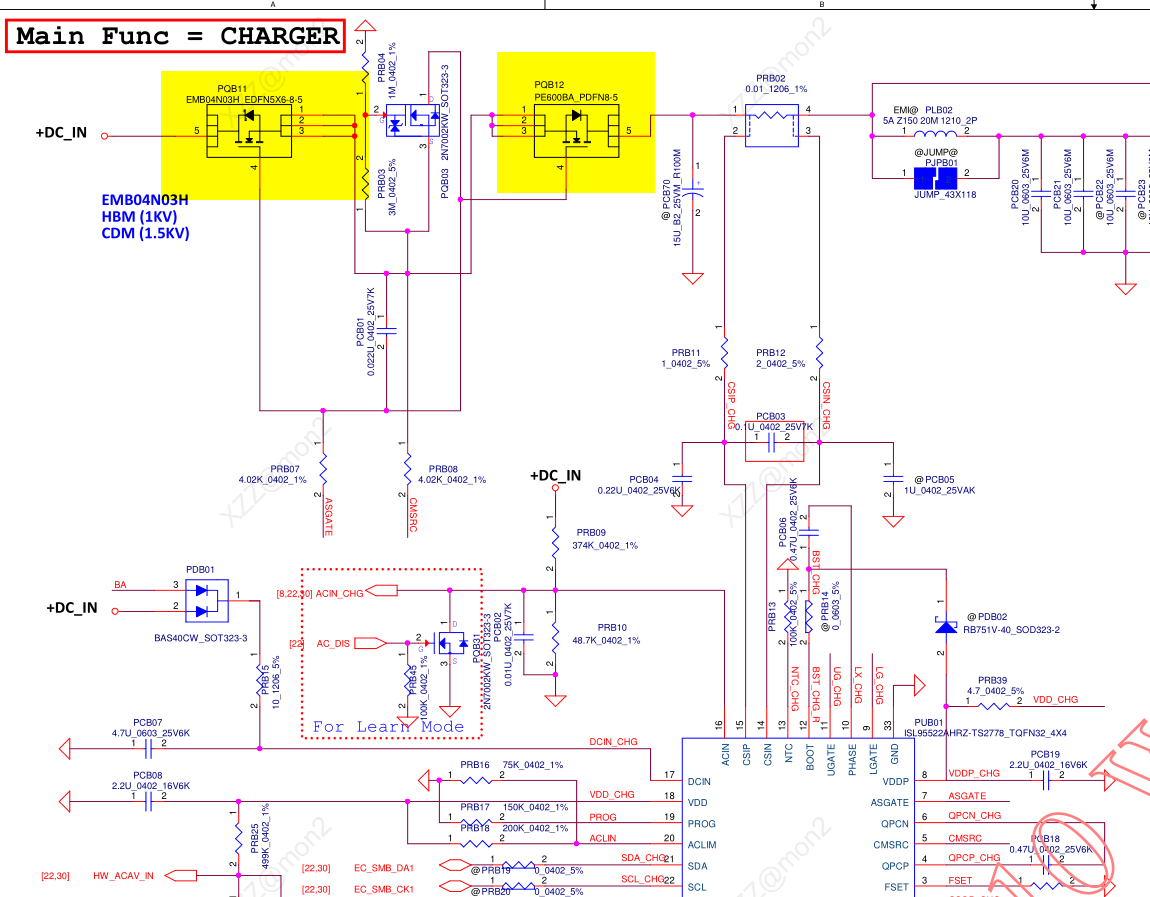

    I have a problem with my laptop that when I connect the charger, the charging indicator lights up and goes out after 4 seconds. Windows reports charging but does not charge the battery. Can anyone help me with this? I also looked for older threads with this board but couldn't find anything.

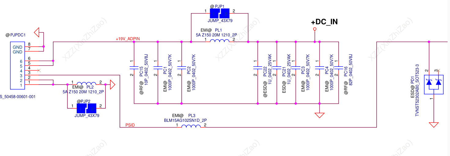

    Carefully measure the voltage to ground of each pin on the adapter connector. The fault may be due to the PSID pin (PL3) which is used by Dell to gauge the power of the external adapter. If this signal is absent, then the charging will halt.
    Click image for larger version  Name:	PSID.png Views:	0 Size:	96.2 KB ID:	3333127
      I checked the 3 pin and did not measure any voltage on it

                    • mon2
                      • Dec 2019
                      • 14659
                      What are the markings on the power adapter? Is it a 60W unit?
                      Remove all power. Meter in DIODE mode. Red meter probe to ground - yes red probe. Black probe on the PL3 / pin 3 of the power connector (as above). Do not attach the power adapter. Do not attach the battery. We are only checking if this PSID line is shorted due to an ESD or another event. The diode mode measurement will confirm the condition of this signal.
                      Post the diode mode measurement.

                          Remove all power. Review the DCin mosfets (see attached).
                          Meter in resistance mode.
                          Measure the resistance across each of these mosfets:
                          source (1-2-3) & drain (5-6-7-8)
                          source (1-2-3) & gate (4)
                          gate (4) & drain (5-6-7-8)
                          Post each measurement. Review the above sticky by piernov on charger circuits.
                            Click image for larger version  Name:	dcin_mosfets.png Views:	0 Size:	217.0 KB ID:	3469117
                            I measured things as you wrote them and here are the results:
                            PQB 11 source (1-2-3) & drain (5-6-7-8) 503k Ohm
                            source (1-2-3) & drain (4) 538k Ohm
                            gate (4) & drain (5-6-7-8) 0L
                            PQB 12 source (1-2-3) & drain (5-6-7-8) 484k Ohm
                            It's just that my laptop works on the battery, but the charging diode lights up and after a few seconds it goes off, and Windows also says that it's charging the battery, but it shows the battery as almost empty.​
                            • mon2
                              • Dec 2019
                              • 14659
                              Attach the power adapter and carefully measure the voltage to ground on each pin of the same Dc-in mosfets.
                              Measure the voltage to ground of:
                              source (1-2-3)
                              gate (4)
                              drain (5-6-7-8)
                              of each mosfet. Post each measurement. A full list of the voltages of each pin on the charger IC will also be helpful but start with the mosfets. Be sure your meter probe is sharp enough to probe each pin on the charger IC without shorting as the charger IC is live.
                                  source (1-2-3)
                                  gate (4)
                                  drain (5-6-7-8)
                                  I just measured each leg separately and here are the measurements:
                                  PQB11:
                                  S1 - 19,79 S2 - 19,79 S3 - 19,79
                                  G - 24,97
                                  D5 - 19,79 D6 - 19,79 D7 - 19,79 D8 - 19,79
                                  PQB12:
                                  G - 24,97
